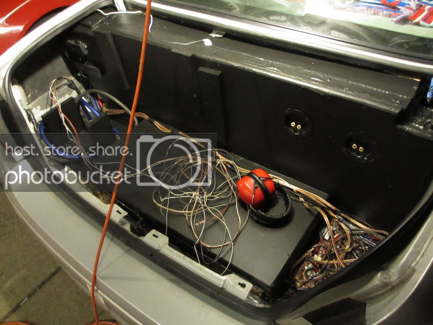

minor updates, just trying to get stuff back in the trunk, with much cleaner wiring this time.

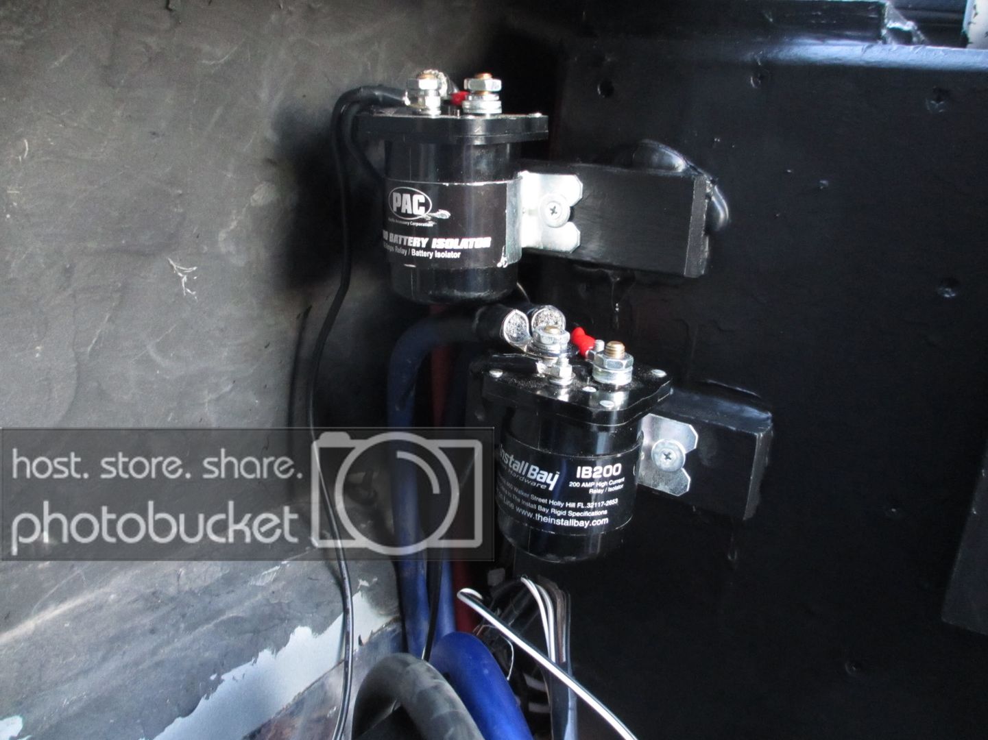

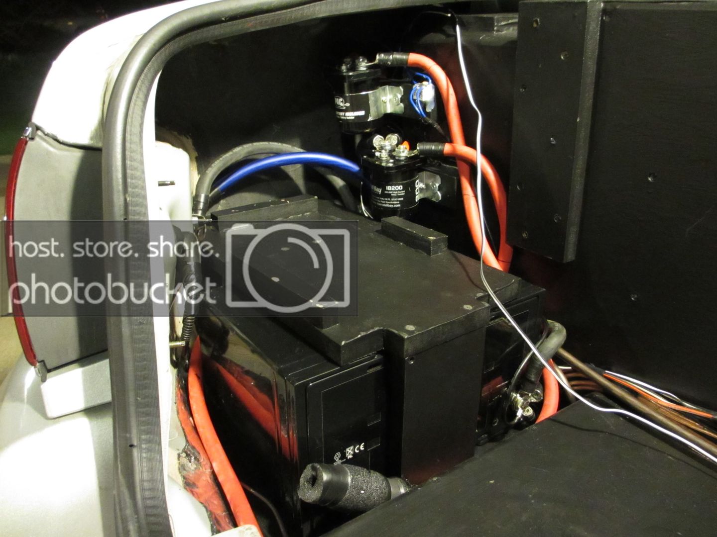

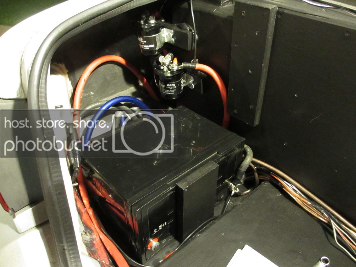

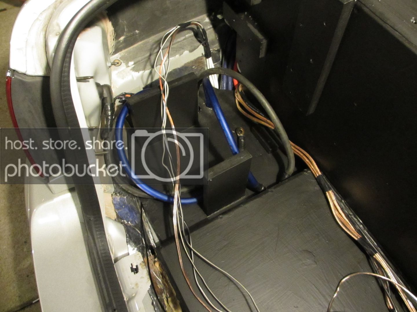

some work tonite, got the relays mounted up again and the first battery in. Again, i'm really making an effort to clean everything up this time around so it's going slow but that's fine.
(relays)
this ***** to get at because it's so close to the box. Can't use a socket wrench on that sucka.

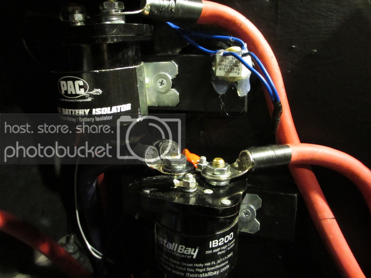

the smaller relay works on the remote output of the head unit and triggers the larger relays...

I originally put the relays in because some friends who are chem/electrical double majors (i'm electrical/computer myself) and know a thing or two about batteries told me that my stock battery would want to rest at a lower voltage than the kinetic/shuriken, and that if I didn't isolate it could potentially shorten the lifespan of those two. But the relay's will probably come in handy at comp's too....
