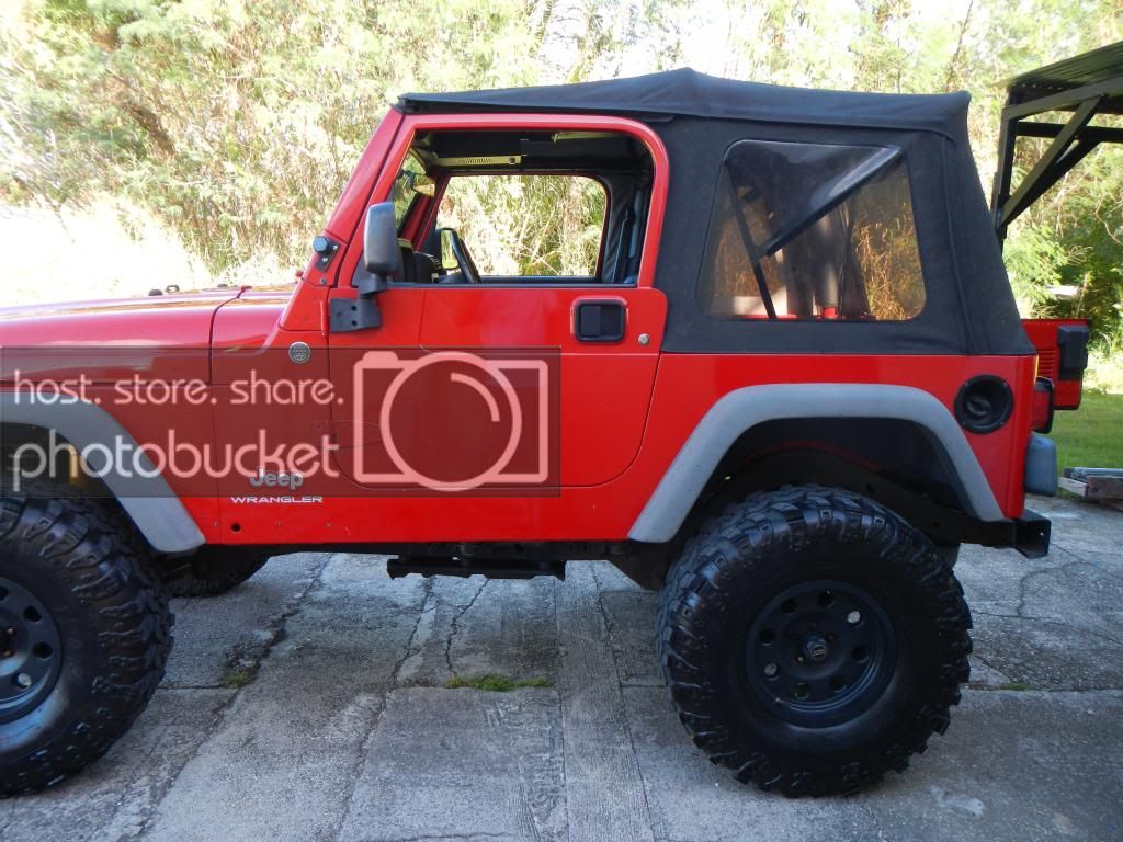

So here's my jeep now. She freshly cleaned since we went off roading the other day. Also broke the steering stabiliser mounts off the steering bar. So I need to fix that too.
