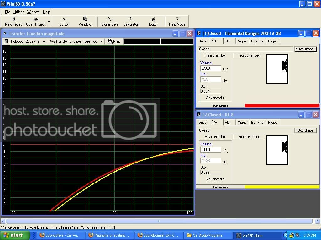

WinISD is a very powerful tool that comes exorbitantly close to real world situations. It is much more accurate than most peoples *intuition* of what the subwoofer will sound like.
ISD is the most incorrect program you can find when it comes to predicting output levels...
free lump programs do not account for ANY varibles within the performance of a speaker..
the graphs are based off the static parameters, which change when the driver has power applied to it.. and efficiency... which matters less and less as power is increased..
ISD doesn't factor in compression, inductance, back emf, flux field shifts, the vehicle, the properties of the enclosure.. it factors nothing that occurs real world..
just for example... ISD graph of 1 RE 8 , and 1 ED 8A.. sealed.. .5 cuft box

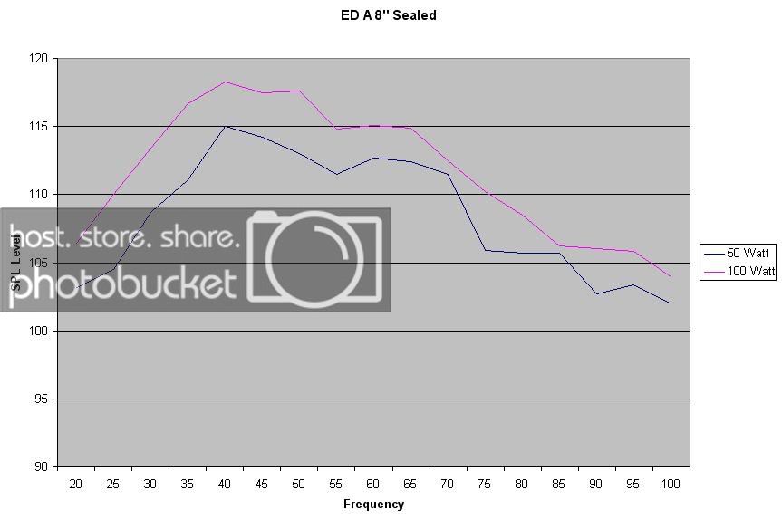

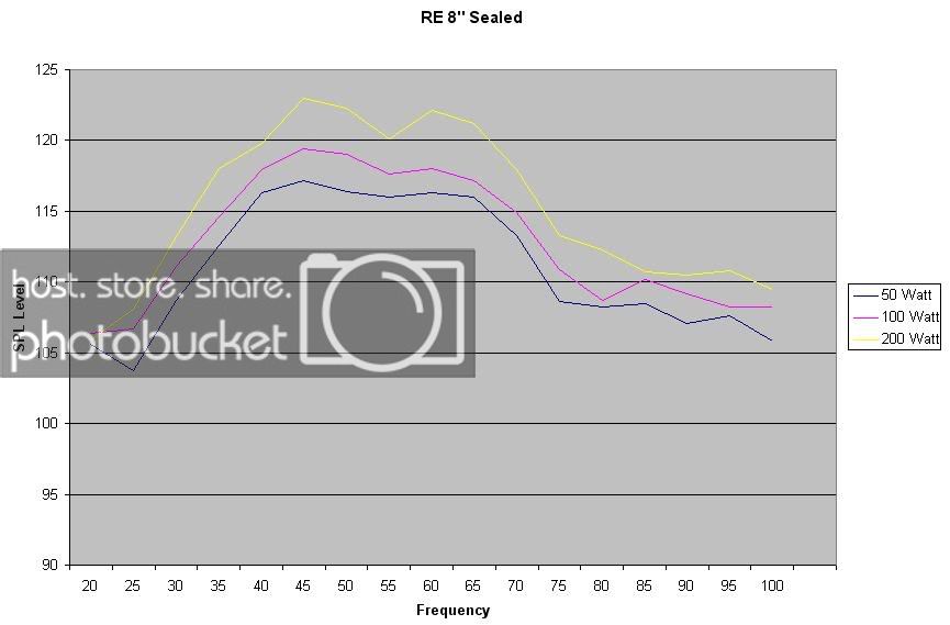

now... real world... 1 RE 8 and 1 ED 8A, tested in .5 cuft sealed. during the great 8 challenge...
RE 8
Loudest SPL 50 watt = 117.2
Loudest SPL 100 watt = 119.4
Average SPL 50 watt 30-80hz = 113.6
Average SPL 100 watt 30-80hz = 115.39
ED 8A
Loudest SPL 50 watt = 115.0
Loudest SPL 100 watt = 118.3
Average SPL 50 watt 30-80hz = 111.06
Average SPL 100 watt 30-80hz = 114.50
and their graphs of actual output..
RE 8
ED 8A
welcome to the real world...
ISD wishes it came close..
