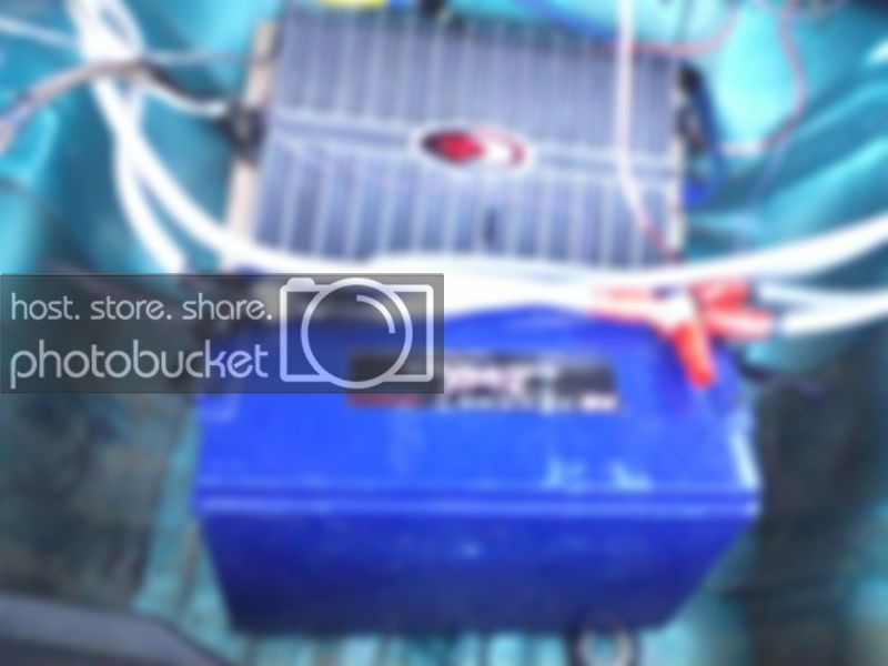

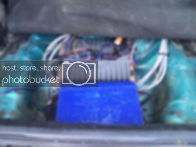

my original rats nest //content.invisioncic.com/y282845/emoticons/frown.gif.a3531fa0534503350665a1e957861287.gif

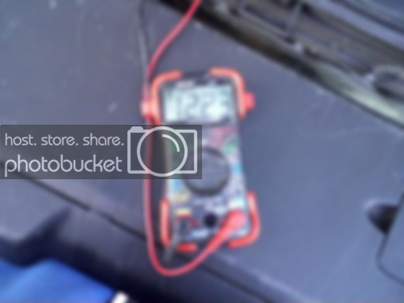

and resting voltage:crap: (i know 12.23 is pathetic but my ho alt goes in this week)

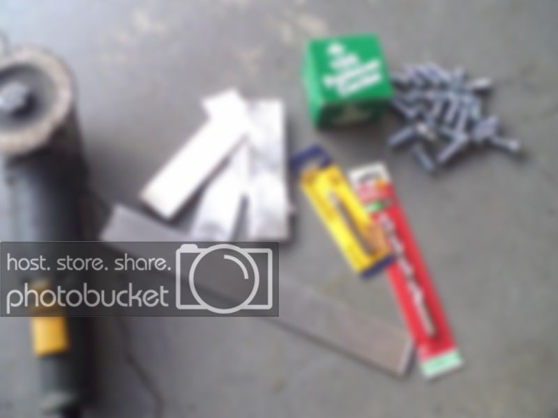

the supplies

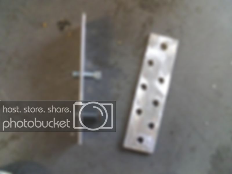

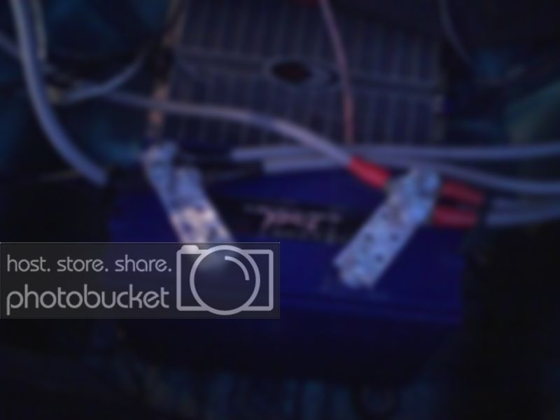

this is what i got done with a drill, sidegrinder, and a tap kit...

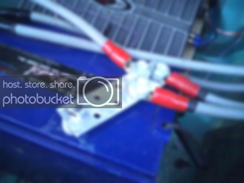

one side on
both done

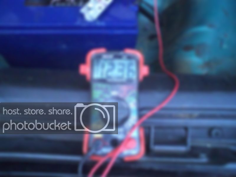

and resting votage afterwards (i know 12.36 isnt great but its a pretty good improvement from the way it was before)

nothing wrong with it, but nothing spectacular about it so there's no commentary. How's the back of those busbars secured? are the bolts just going onto the top of the battery case?
there is a nut epoxied to the case... the bolt screws into that... i know its not spectacular, just trying to make sure i didnt mess anything (i know its pretty straightfoward but you can never be too sure)

Wow, 12.3 volts is really shitty. Even a crappy battery thats not cared for should still sit at 12.6 or better.
If I was you I would be throwing those batts on a trickle charge every night.
the batt will live... was on 12.9 when i got it, but it was in my civic (60 amp stock alt //content.invisioncic.com/y282845/emoticons/frown.gif.a3531fa0534503350665a1e957861287.gif) the alt will be replaced thursday with a 150a high output
and i will fully charge the batt when the time comes //content.invisioncic.com/y282845/emoticons/fyi.gif.9f1f679348da7204ce960cfc74bca8e0.gif
