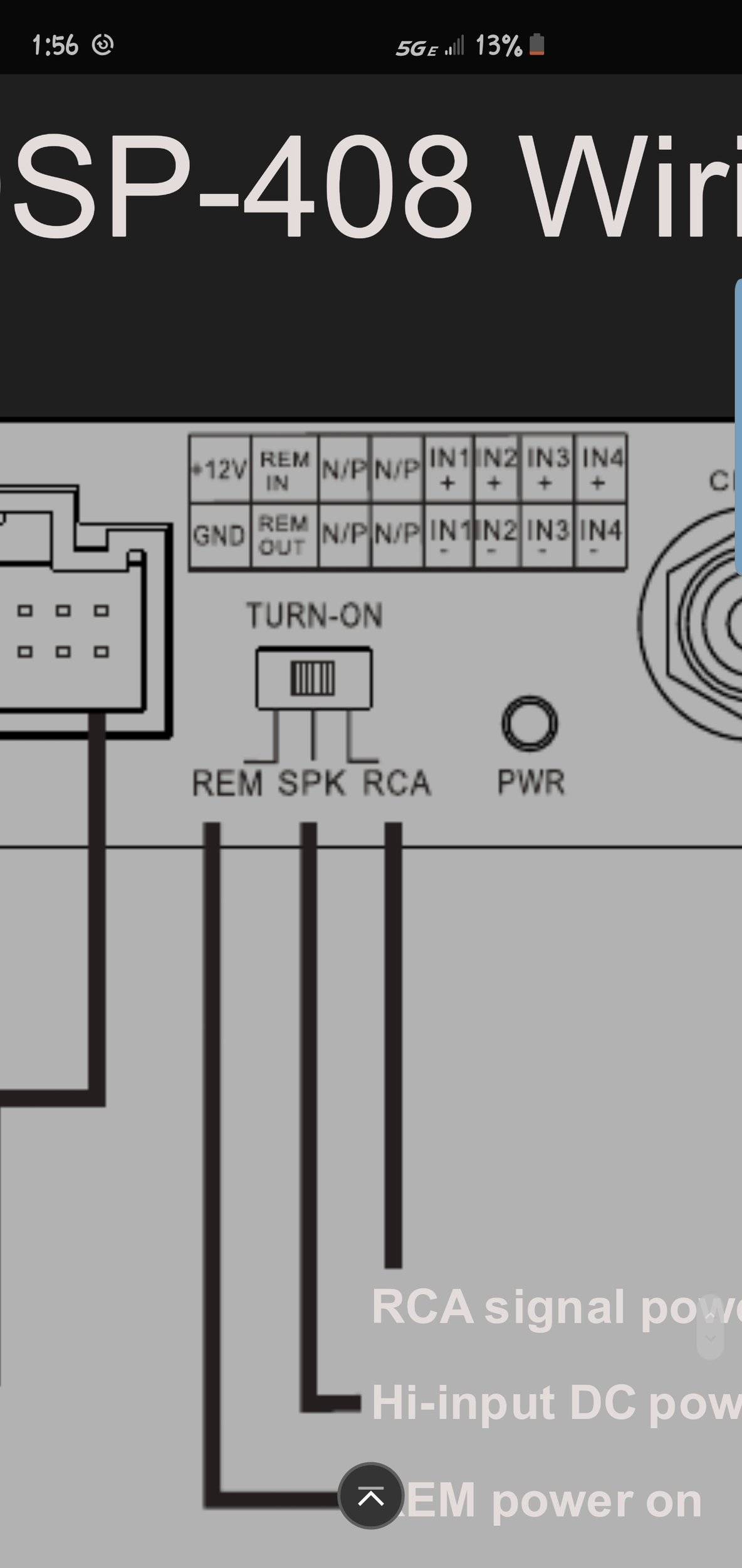

How would I get the rest of the speakers to play if all I have plugged in would be the rca from the sub amp? And the power looked like one of those round 12v charger holes

I see input 1-4. What do the 4 pins that say n/p do? And also where would I hook the tweeters up? My car has 4 door speakers and tweeters on the dash.
So if I hook up all speakers would i still get the same results as before with the LOC?
If you have speakers on the stock head unit power, you wont have any sound if you are streaming to the Bluetooth dongle meaning no signal is going to your head unit thus nothing to the speakers. Only thing that gets signal is the amps connected to the DSP.
If you use speaker level connections you are still subjected to the garbage stock head unit signal thats cut off and not full just like the audio control lc2i i would not recommend going this path.
You'll be using a dayton amp and a cheap(but great deal and quality) 4 channel amp (pioneer gm 8704) for power for the door speakers so everything is amplified and everything gets signal when you stream straight to the DSP
