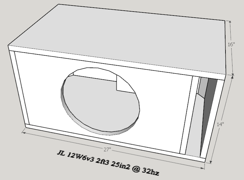

If you stick with the W6 I'd allow some adjustments on sizing the enclosure, as stated above that's pretty small. In a 27w x 14h footprint you'd be a LOT better off allowing for 16-17" depth if possible. A decent enclosure for the vehicle should make an immediate and large difference.
Tuned low 30's a W6 in 2ft3 net or so should get to 28hz easy and probably under that in a vehicle. As far as volume goes just get an amp that will power that sub right. It probably wont need much in the way of electrical upgrades either. Remember it IS a low power setup, smaller cone/wise etc so keep your expectations in check.
