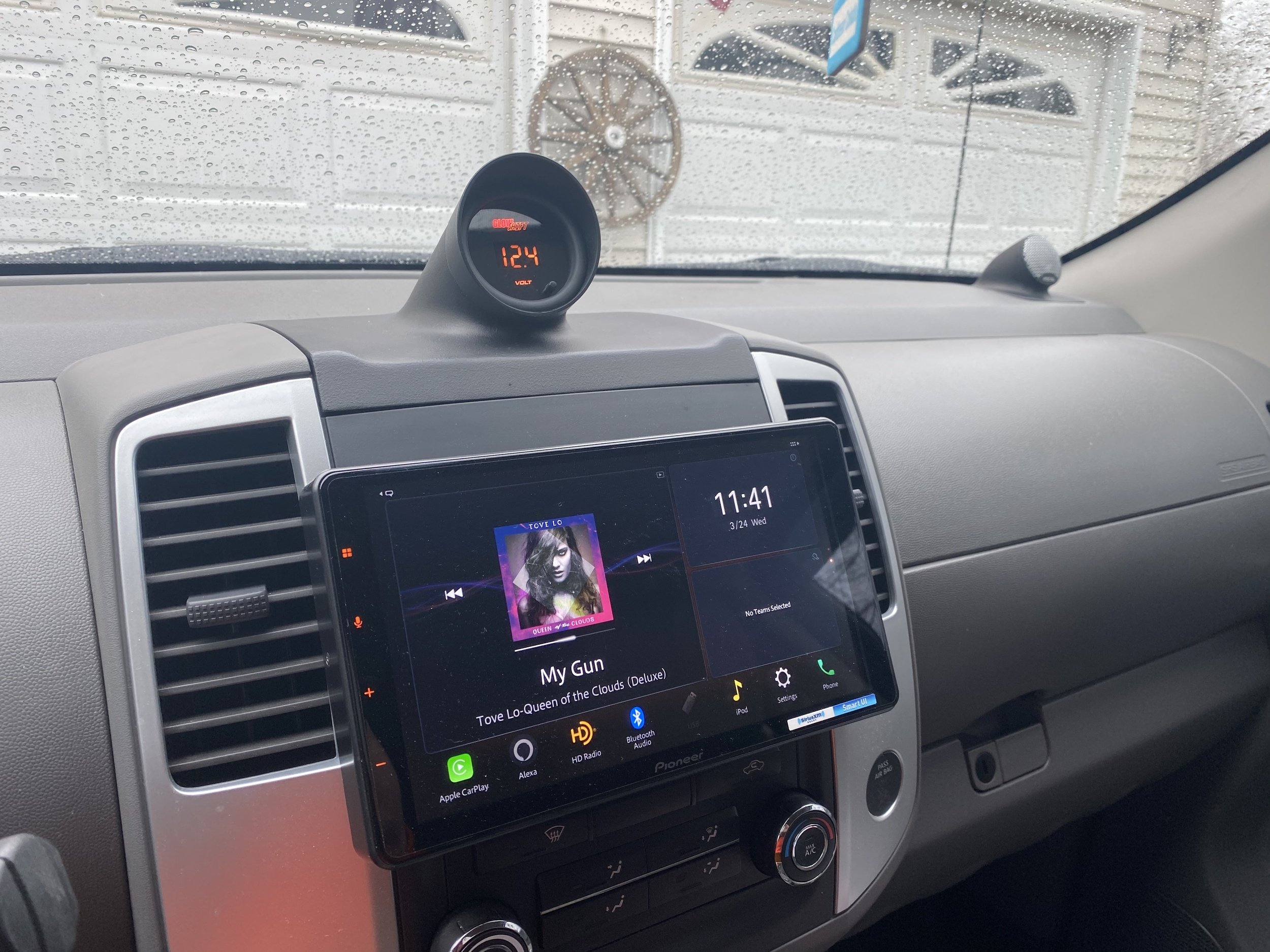

Hello i recently finished up my system but already have the itch for a potential upgrade, i will post the specs of the system and then explain what i am trying to do.
Pioneer DMH-WC6600NEX
