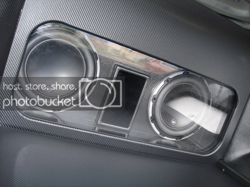

Something like this
But molded into the side wheel wells too since I don't have much space.

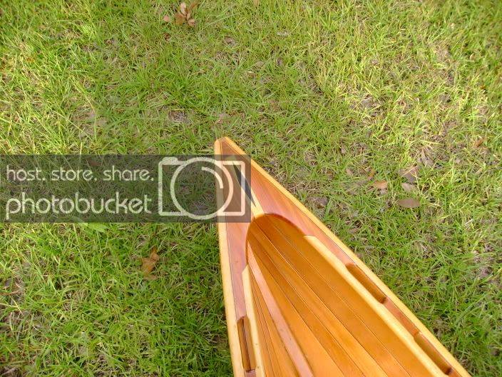

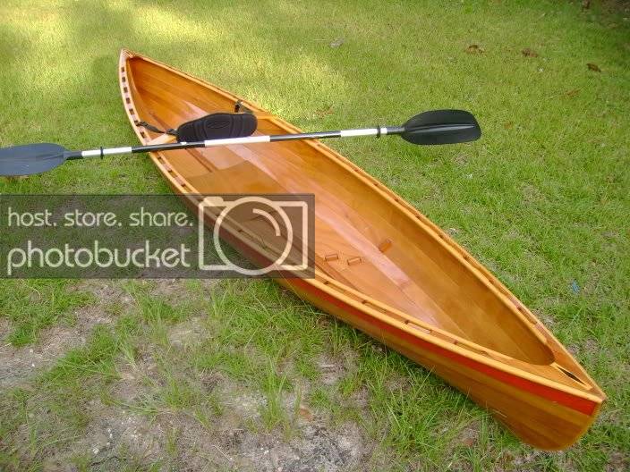

I build wood/epoxy composite canoes and kayaks as a side business and make my living with a decorative concrete and commercial coatings company. So I deal with epoxy on a daily basis. If you need to make curved panels, don't overlook the possibility of bending up okume plywood to the shape needed, then laminating with epoxy and fiberglass.

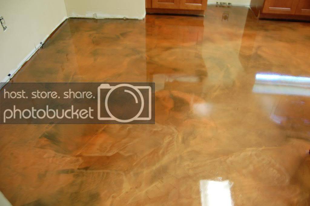

I know it's off topic, but I do floors like this:
100% solids epoxy with urethane top coat.
And boats like this:
Lapstrake construction, one layer of 3 oz fiberglass, wetted out with 3 coats of epoxy to fill the weave, then 10 coats of spar varnish.
