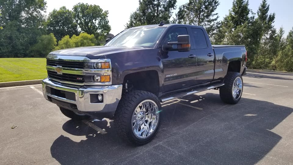

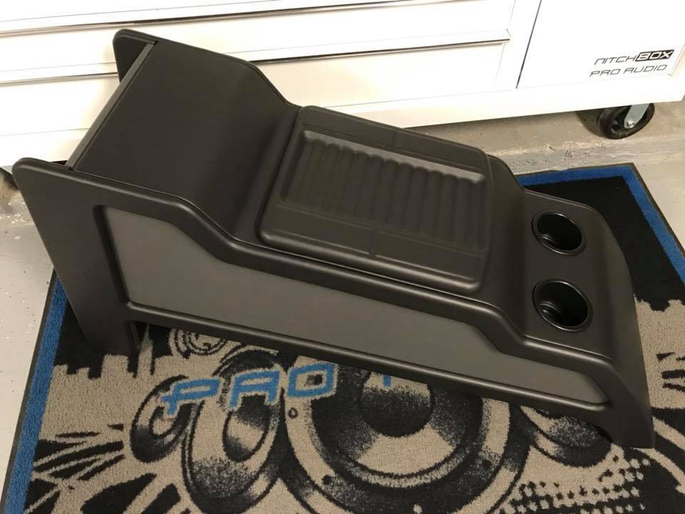

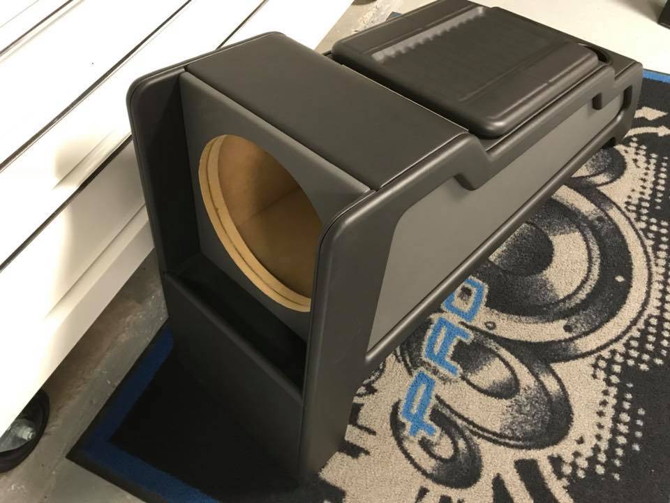

Heres the Truck:
Also, the sub enclosure shown is the basic version of what is being finished this week. Mine will not be ported, and will have usb ports, wireless phone charger pad built in to the top, 4 led cupholders, and will be for a 15 inch sub. I have all of the above equipment and more EXCEPT THE 4k watt amp. In which at 2 Ohms will run at 2k watts. I'm also in the market for a High Output Alternator and extra Battery. I believe a 320Amp Alternator should suffice... but still working the math on it.
