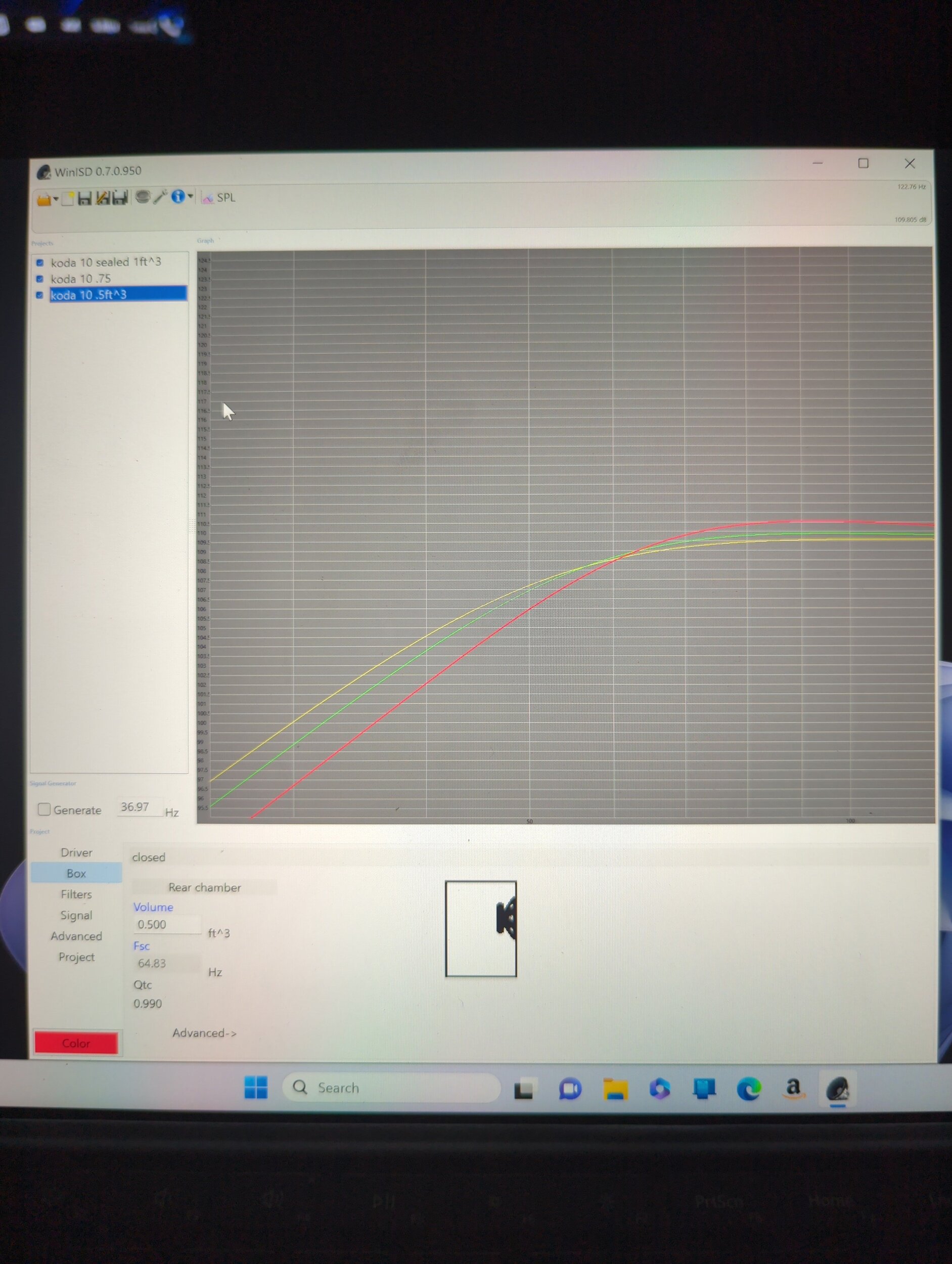

this is the adire audio koda 10s in
1cube yellow
.75 green
.5 red

That sub in the .75 enclosure is very close to what my enclosure is and actually looks pretty good. The lower wattage wouldn't be a big deal as my sub channel is only rated at 500 rms at 2 ohms. The only problem is its not 1 ohm stable so 4 ohm dvc subs would give me a 4 ohm load at 350 watts rms.
I mainly posted to show the difference in response curve. Sealed boxes rely on cabin gain to play the low end frequencies. I personally don't like that and would rather have too much low end that I need to cut than possibly have anemic low end. My 8 for instance is great from 40-150 but below 40 it falls off pretty fast. But I knew that when designing the box. I wanted the 8 up front playing 50-150 to help my midbass drivers.
These particular 10s I would put in 1.5ft³ each at 31hz if I were to install them
