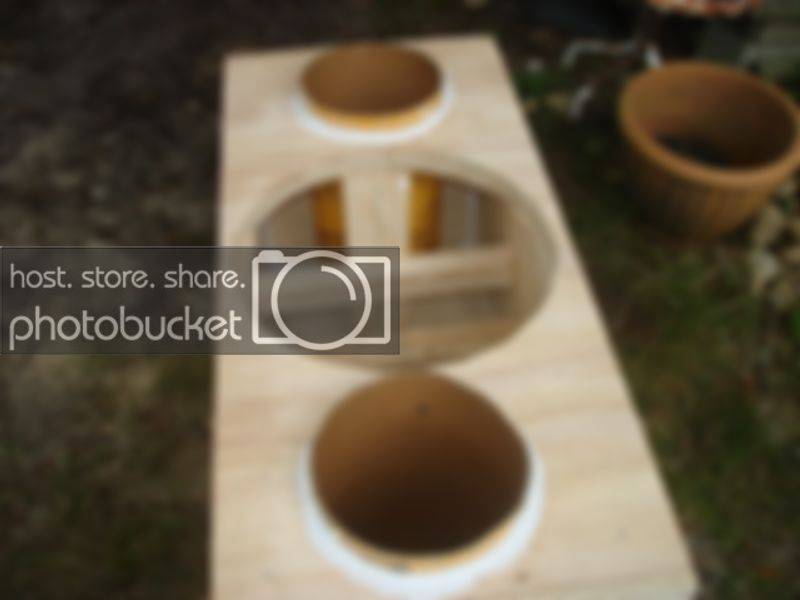

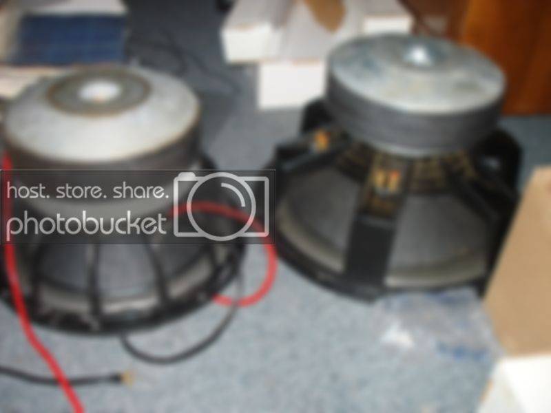

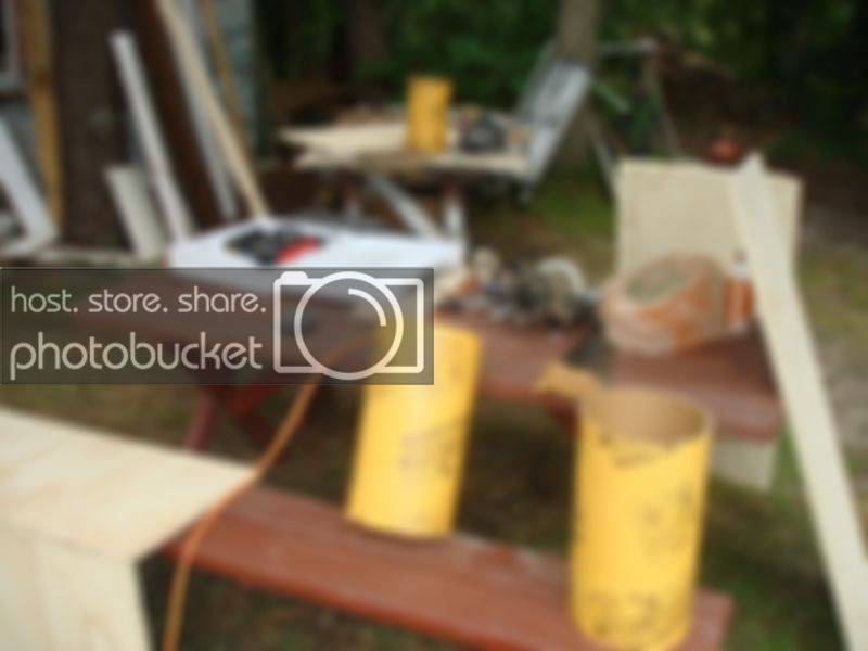

Little something I put together for testing. 18" '05 Shocker
hispls
First pic is this TC 4HP based Shocker vs the 02 Shocker Sig.

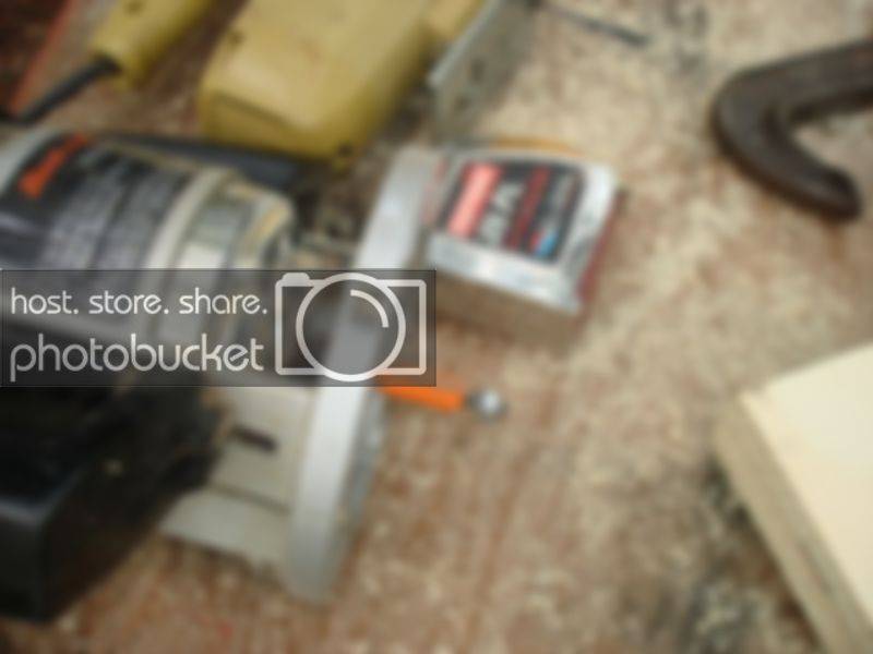

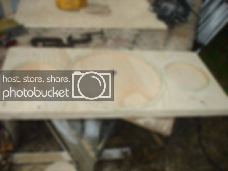

Got the wood for 25$ a sheet at home depot. Had this router forever, finally broke down to buy the flush bit....helps a lot.

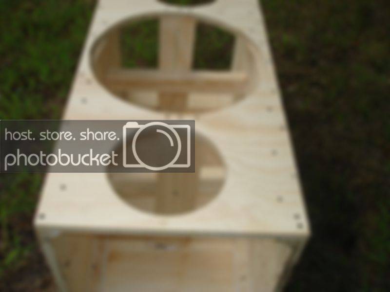

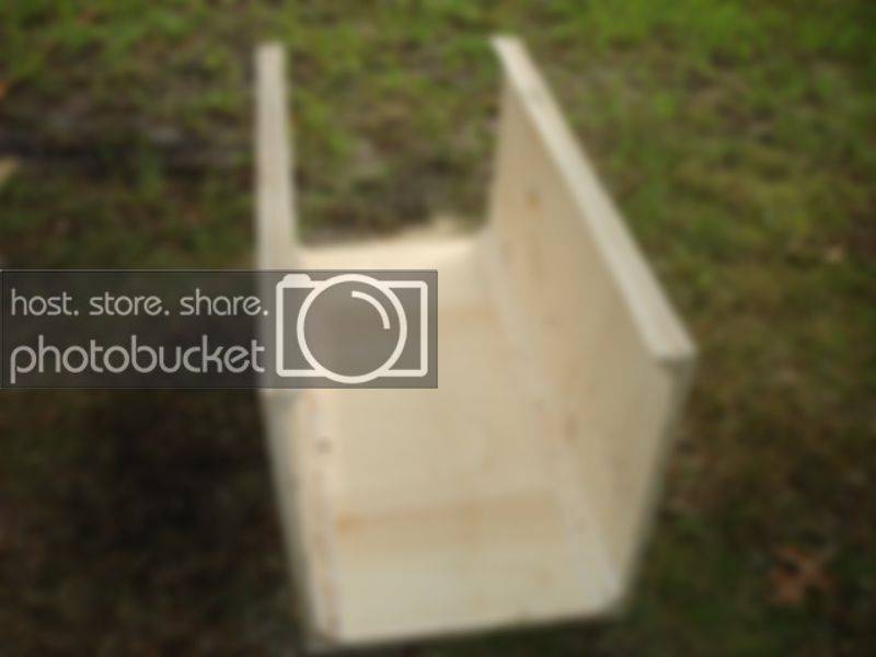

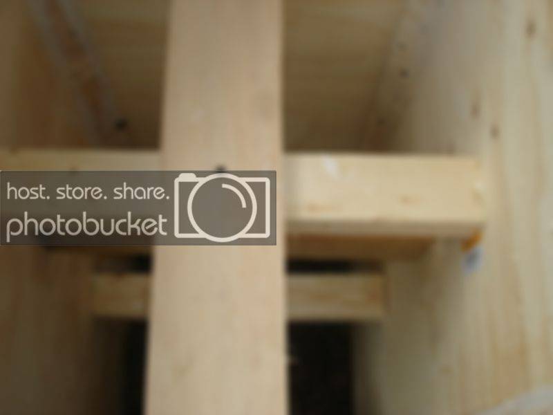

It's OK, but not a huge improvement over a single 15 and definitely not = a pair of 15's. Box is a little over 6 cube after displacement tuned to 46hz. Should theoretically tune down around 35 if I can effictively plug one port. I'll attempt this before I pull this out and try something new.
Haven't had a chance to meter yet, but I'm guessing 146ish. Will update if I keep this in long enough for more testing...really was just something to keep me busy while I recone all my 15's.
