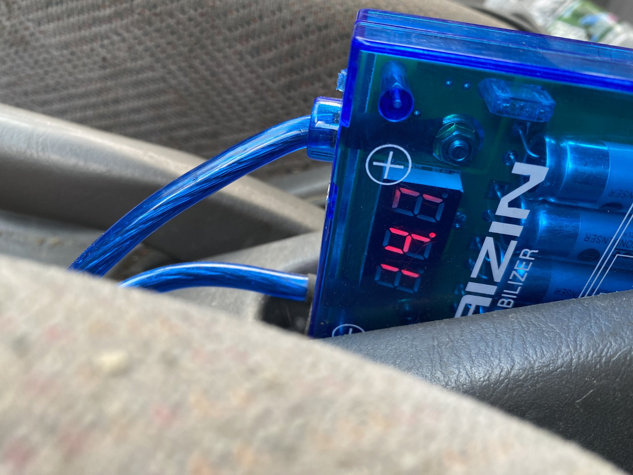

alright i have given into the temptation and would like to try lithium, however i have a 400 amp alt with an internal voltage regulator and was wondering if i can run it at all with my current alt, not looking to get get voltage up just get some serious AH. would i have to use a charger? or would i be better off finding batteries that are the right voltage to charge right off the alt? what would be better for long play time at shows doing demos all day?

taramps smart 3k bass and rockville db45 4 channel, i plan on upgrading to a bass 5k soon so have to also keep that in mind, the alt charges at 14.9 to 14.7 on the button
