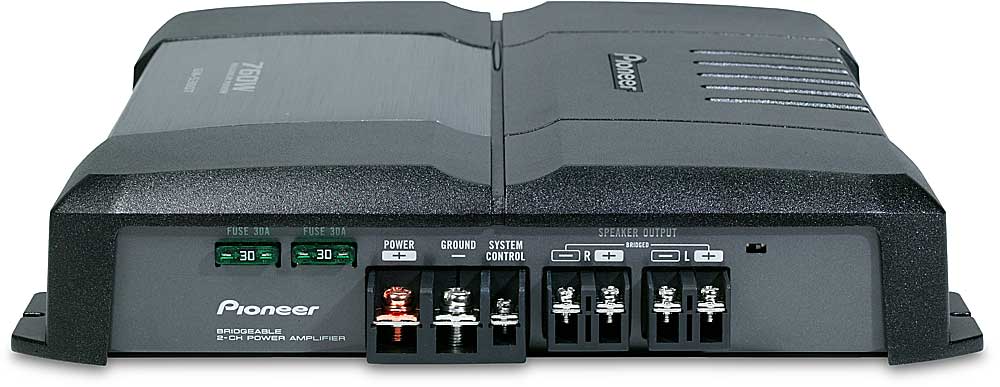

Your amp should have RCA ins and speaker wire outs. Your gonna have to run your own wire from the amp back to the factory speaker wiring labeled in the yellow arrow.

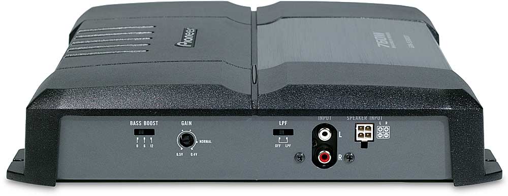

it does have rca inputes and speaker levels (is that where is has four slots to stick a wire through each one ....and i thought i run the speaker wires to the top of the loc...the yellow arrow is puttin to the bottom isnt ..
Okay. Give me a sec to type something out.
Looks like your amp only has two RCA inputs. So your gonna take a single rca cable and connect it to the Front Right and Front Left connectors on your LOC and connect that to the RCAs in the pic above.
You're then going to run your own wire from these speaker outputs and splice them into the factory wiring pointed on by the yellow arrow. You want to be sure you match up the + - for each speaker to the corresponding factory wiring.
Ohh, and another thing. Is this only going to be powering the front speakers?
Since you wont need all 4 rca's from the LOC like I did, you should only need to the cut and splice half the wire in the pic.
