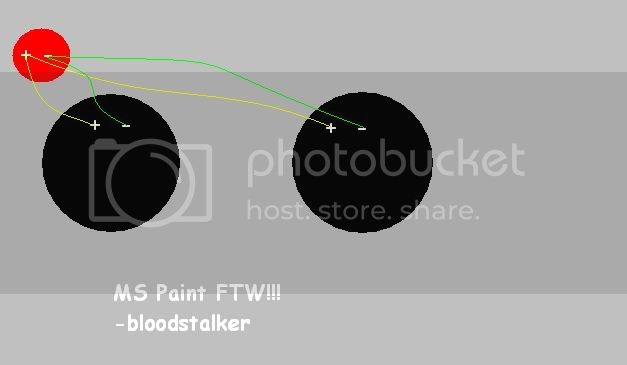

Ok so Since I learned that My two CVRs both have one blown VC, and I have two CVX on the way, I decided to hook it up my half blown CVRs to my lightning audio amp and see what happens... I figured that since I paid 160 for the pair that I was going to get some use out of them even if it ruins my subs further and my amp (its only a lightning audio). So They are wired in parallel and they are 2Ω DVC, creating a 1Ω load on the amp (I am not 100% sure of this), now I have this amp which is not rated to be 1Ω stable. So I hooked them up to it and drove to work yesterday and they worked, severely underpowered but it worked BTW: its an hour drive to where I work. So what is going on here? is that amp really 1Ω stable? I drove again today and its still working fine just really underpowered. I was thinking this thing was going to blow a fuse or just blow out all together but it is still going.

For lack of technical terms I have done a nice little diagram on how my subs are wired within my box. Red dot is the clip that goes to the outside of the box.
Then on the outside of the box I have 14awg wire running from the clip (sorry for not using the technical term, it has slipped my mind...) to the two back channels of my lightning audio amp.
