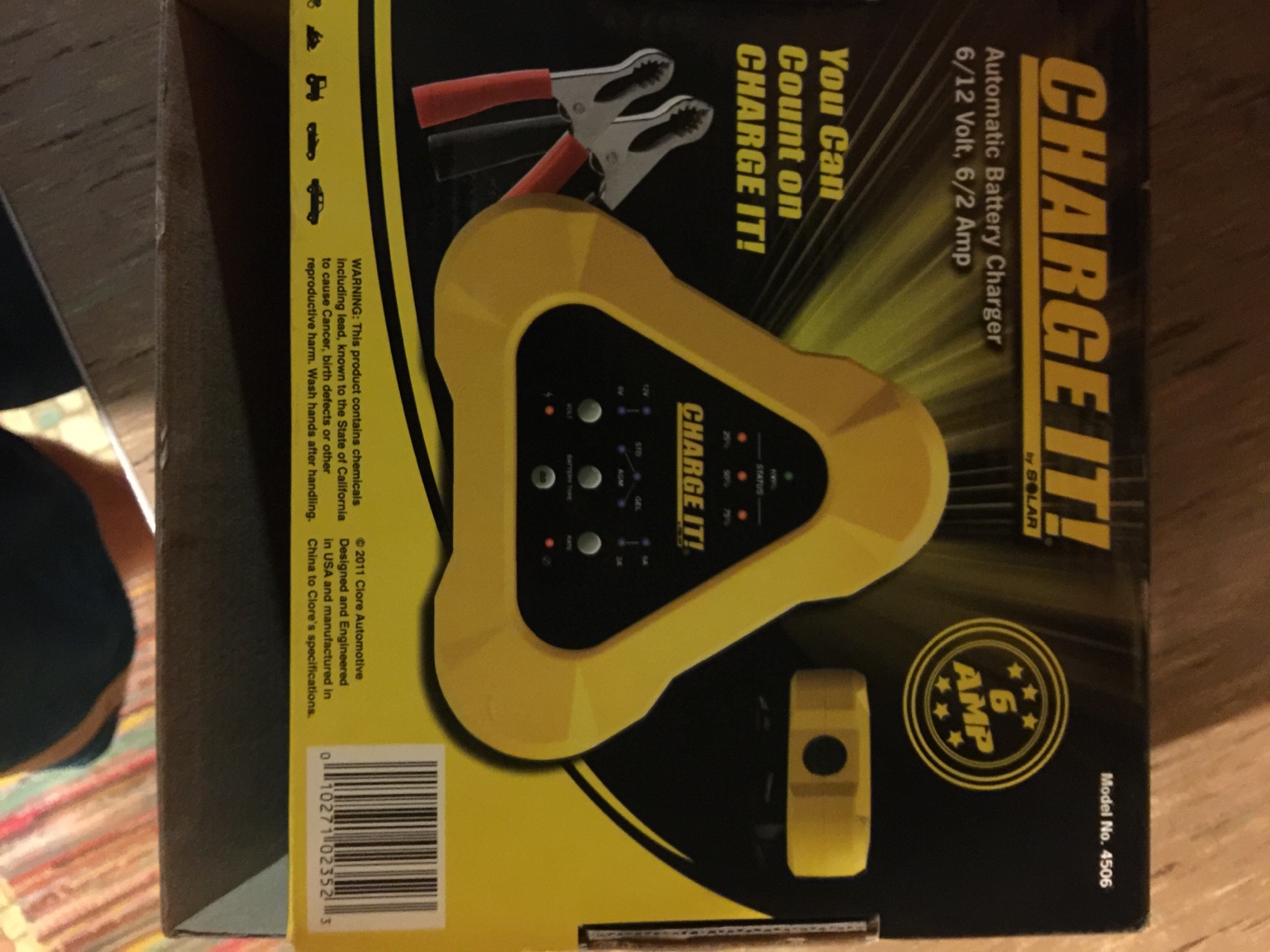

So I just recently got my replacement xs d1200 in the mail and I have a d3400 in my gmc. What does everyone use for agm chargers? I'm looking for something quality that compensates for temp.
And I don't have much trust in my current charger
