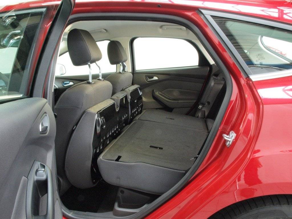

So I have this.
And with the seats down it looks like this.
If I completely remove these bottom seat cushions the driver seat will still go all the way back. (I'm 6'3")

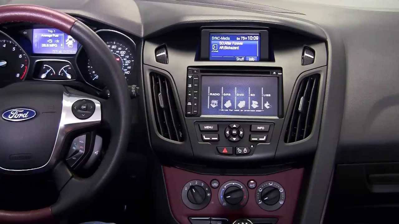

Metra makes this awful looking dash kit but what can you do? It's not like Ford makes one.
So in my head I have an active 3 way setup with full custom door panels including an 8, 6.5, and tweet. Not sure on brand yet but Crescendo is on the list but def wanting to go higher end. I would consider ruling out a brand that didn't offer an 8 (want it to match), like Rainbow, if I knew it would keep up with the subs and I wasn't losing too much in the mid bass range. Actually since I've decided not to wall this car I might was well go with 2 4 channels and do a 2 way active front and rear.
