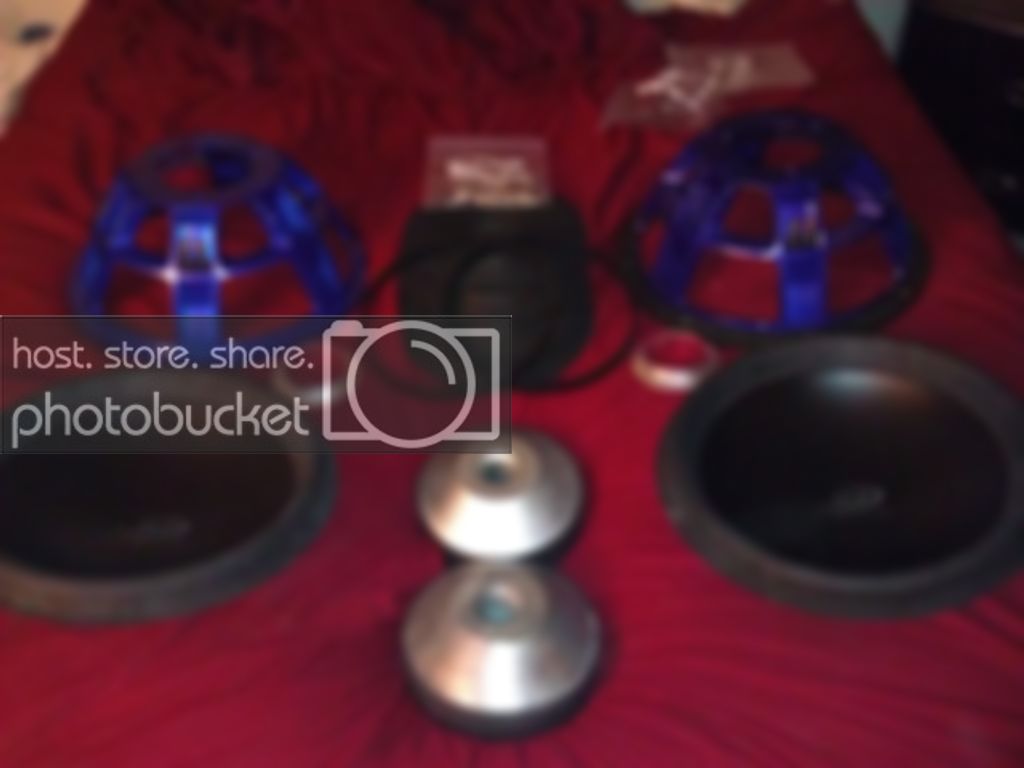

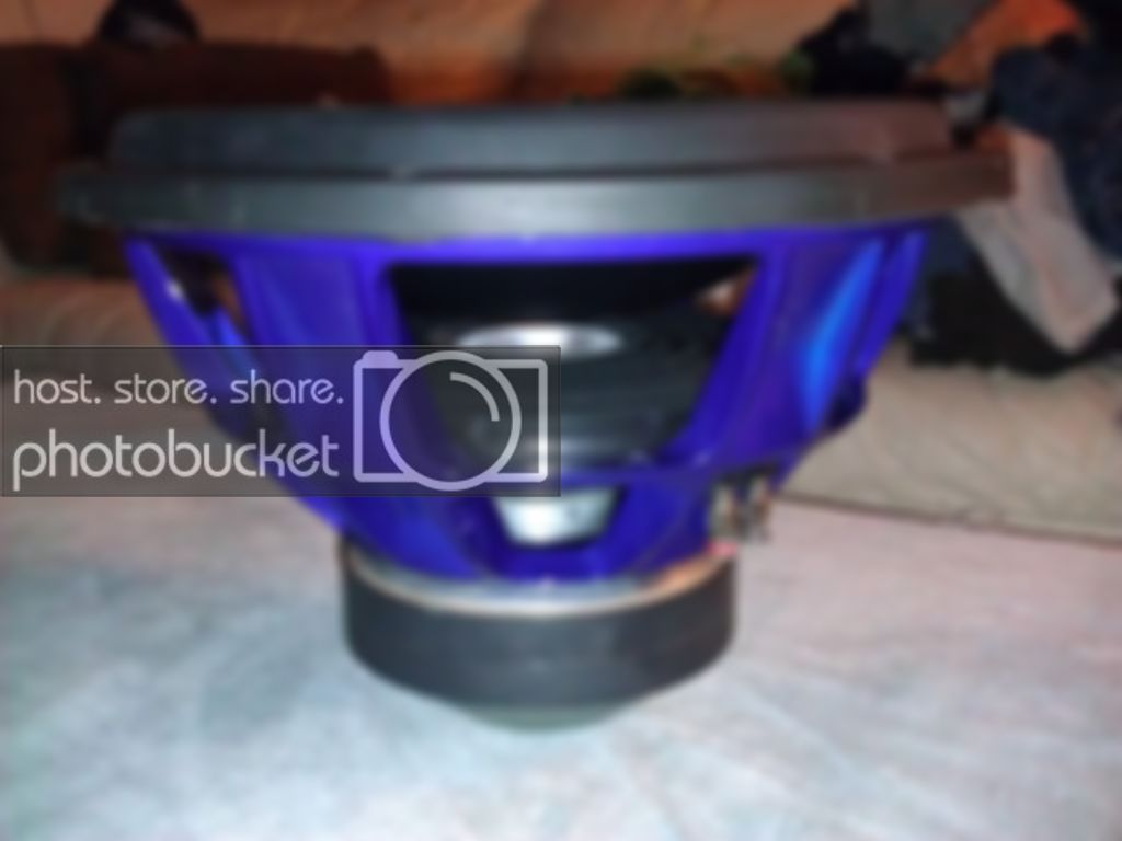

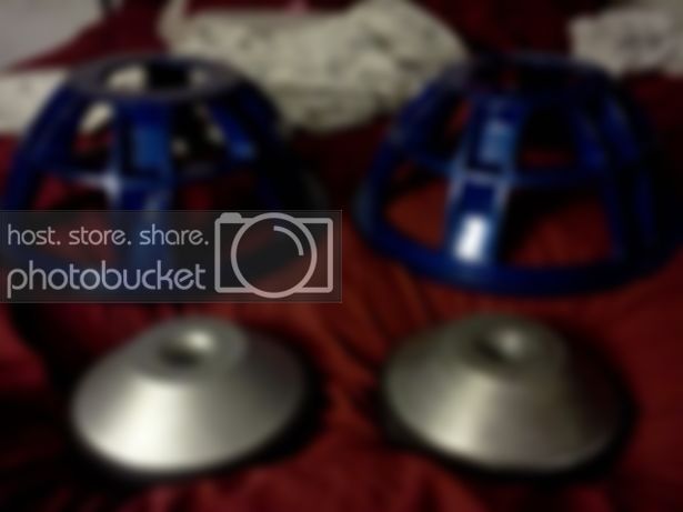

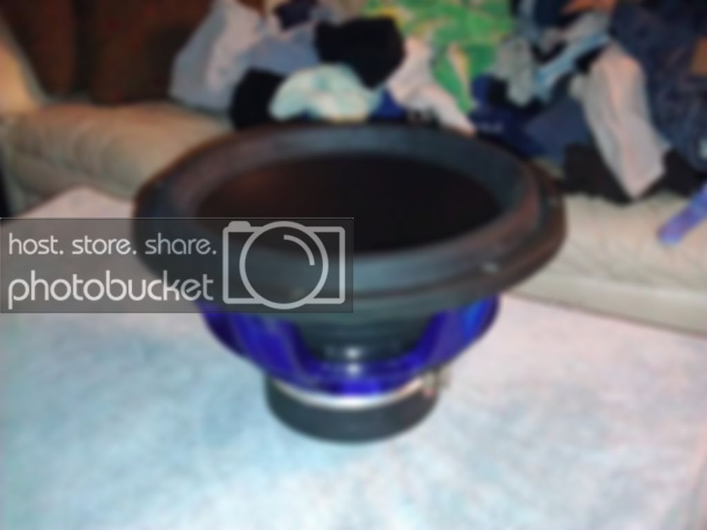

Fi q motors with all tc top end soft parts being built by yours truly.

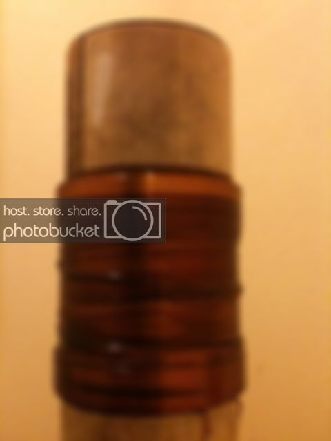

coils will be here tomorrow. I was thinking the same thing. problem is i started building off the q motors and went tc parts nuts. im gonna se how the coils fit and line up. Whta would you guys suggest to mesh with the top assemblies. heres some specs.
q top plate is .5" if i remember right
coil:
fh 5.965
ww 3.512
id 3.010
od 3.370
my outise gap clearence is .04" gonna be a tight fit
coil:
fh 5.965
ww 3.512
id 3.010
od 3.370
Id just get some tc9's with copper, your gonna have super low BL with a non copper motor.
