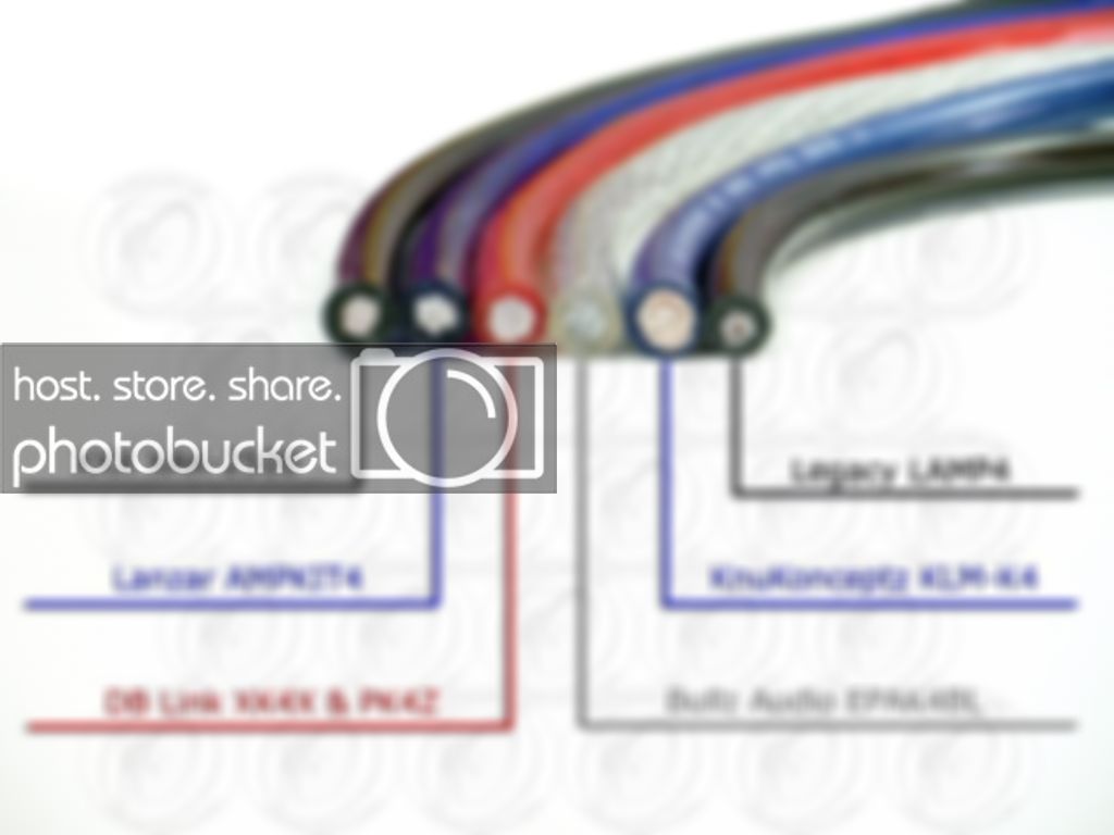

Ok so i have been looking at this KNU KCA 4 gauge wire.... and it doesnt look like 4gauge to me... It looks quite a bit bigger compared to other companys that offer 4 gauge, hell i looks to be about the same size as the "Bullz Audio 1/0" wire.
Has anyone actually measured or compared to see what the actual size/gauge it is? I know that standard 4awg gaauge is not this big, and KNU wire is always bigger then what is "rated" to be?

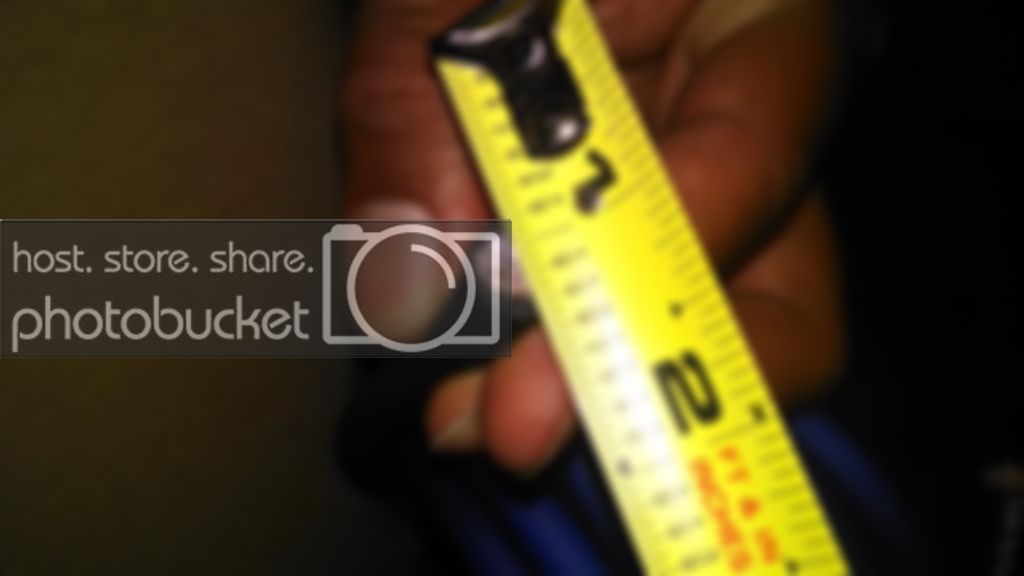

I've got some sitting next to me, so I figured I'd stick a ruler across the end. It's 3/8ths of an inch in diameter.

see i was going to just get a roll of the bullz wire, its really not that bad of wire for the price and run multiple runs of it to make up for what it lacks. Then i seen a pic of the the KCA 4ga and was like d@mn thats the same size really(the actual wire vs wire part not counting the jacket) lol, if thats the case i figure i should be able to run multiple runs of it and have the same outcome in the end. Idk if it would work that way but i figured it would.
