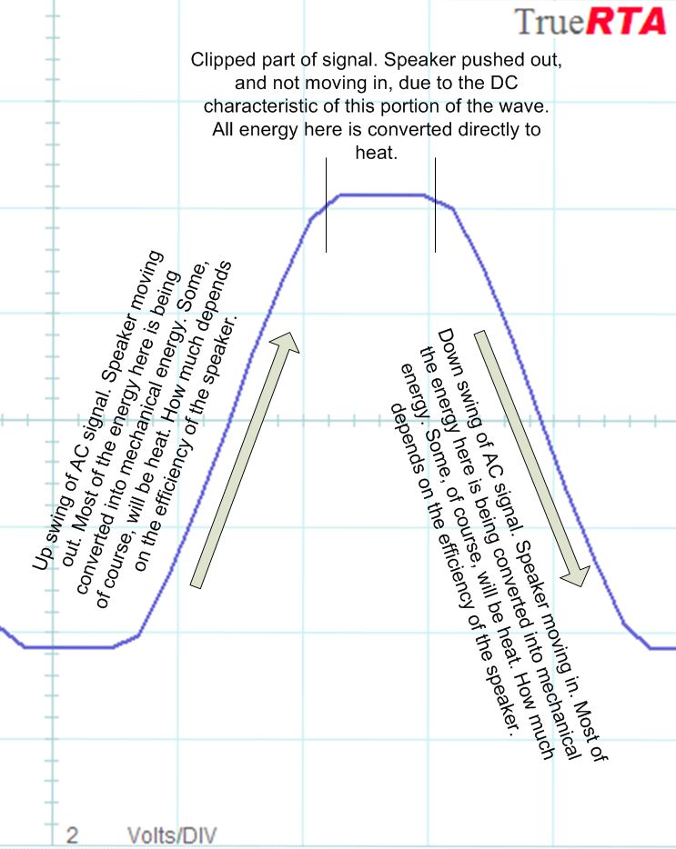

An amp can only, ever, put out the amount of power that it is capable of. When a amp signal is clipped, the wave gets no bigger, it clips off, because the 240w amp can only put out 240w, period. Heat is not power, heat is energy, power is a measurement of energy. Energy cannot be created, nor destroyed, it can only be changed from one type to the other. The difference that happened, when clipping that amp, was that the electrical energy, that was normally turned into acoustical energy with the smooth rise and fall of the ac signal, was turned into heat energy as the signal no long had a smooth rise and fall. The speaker will maintian a signle motoin longer which causes it to not be transferring the energy into sound, and instead, that energy turns into pure heat in the voice coil. It's still the same amount of energy, it's just a difference on how that energy is being transferred.
The RMS power will measure higher, but only due to the signal staying at the peaks longer, which shifts the "average".
This is completely false.. first of all 99% of the power in a coil turns into heat anyway.. secondly any extra power due to clipping goes into harmonics, which are also sine waves.. you can feed a sub for example pure square wave, and it will still move sinusoidally with a base + harmonics...
You would be hard pressed to kill a real 500 watt driver with 500 watts of power, unless there is a severe amount of distortion over a prolonged period of time... keep in mind an amp can generally not provide much more power then it's rated for at nominal load... and as you increase duty cycle through compression THD skyrockets...
Really? Wrong... I've done it. Several times. Maybe you should read my earlier post so I dont have to repeat myself.
You must not understand physics if you feel this is "wrong". I worked for many years at Peavy Electronics as an amplifier inspector. I have seen many clipped signals on many O-scopes. If you were, in fact, correct, an O-Scope would show it. But alas, it does not.
^ you clearly have no idea what you are talking about, and I'm sure what you just posted may be part of the reason you are so ignorent.. (looks like someone's windows paint project)
Forget everything else.. A clipped signal has no DC component in any conventional sense..
Of course you claim to have worked for someone or another as an 'amp inspector' so you must be right.. lol..

How is the clipped portion of the wave not dc? Isn't it caused by the fets being fully opened and thus outputting the rail voltage to the speaker?
