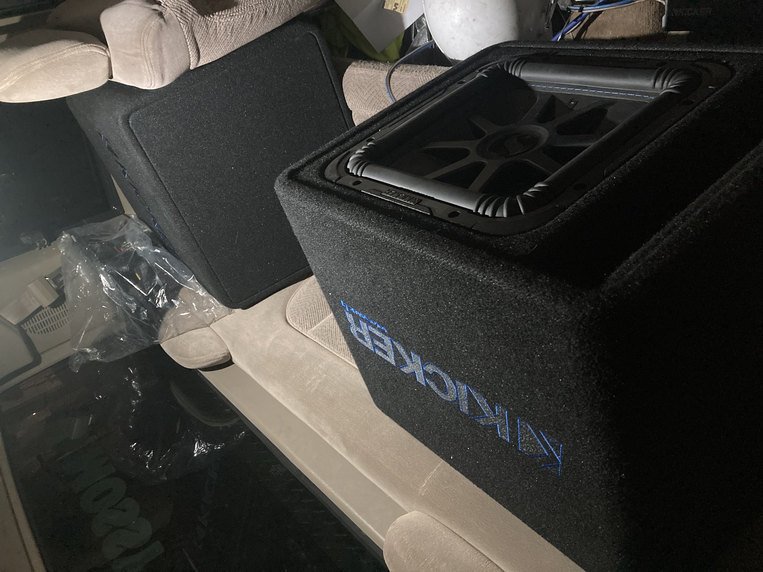

Please post a pic of your subs as they are currently in the vehicle Op.
Those small space saving "factory" enclosures leave a lot of performance on the table.
I'd get something built closer to what they'll perform well in and configured for your vehicle.
That 1800.1 is wired 1 ohm I assume?

I use a text now number for over the internet stuff. Don't want to put your real number out their bro. Also those boxes aren't horrible. But I would personally run a much bigger box. At least five cubes, tuned to 35-37
