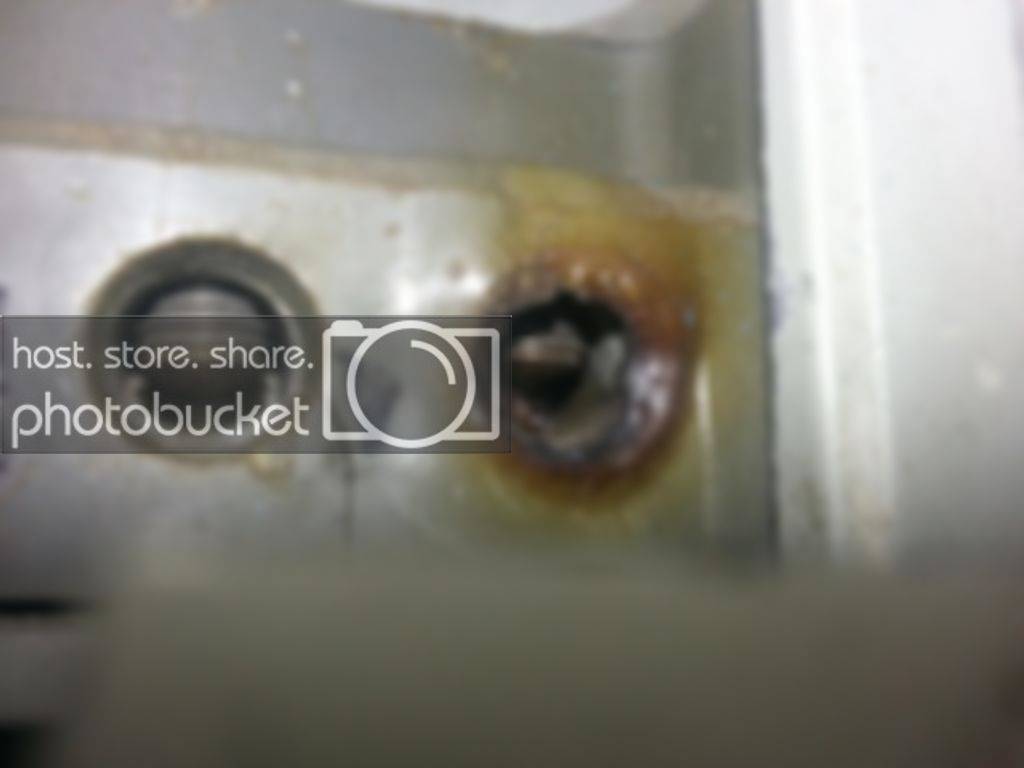

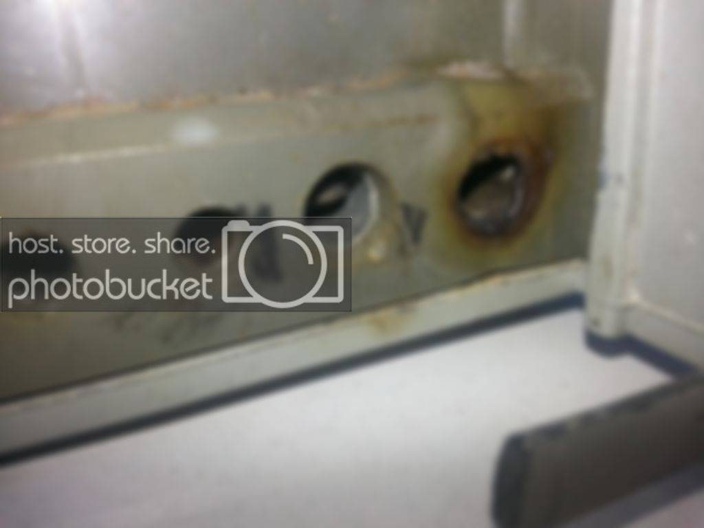

I picked this amp up on CL about a week ago. When I saw it, I noticed that the POS input was burnt and obviously has been quite hot. I was skeptical as shit, but didn't have any tools to test it. Bought it anyways (for a good price //content.invisioncic.com/y282845/emoticons/greedy.gif.5a53e6246569d7ab79867170f3b06629.gif). Dude seemed cool, and guaranteed it would work.

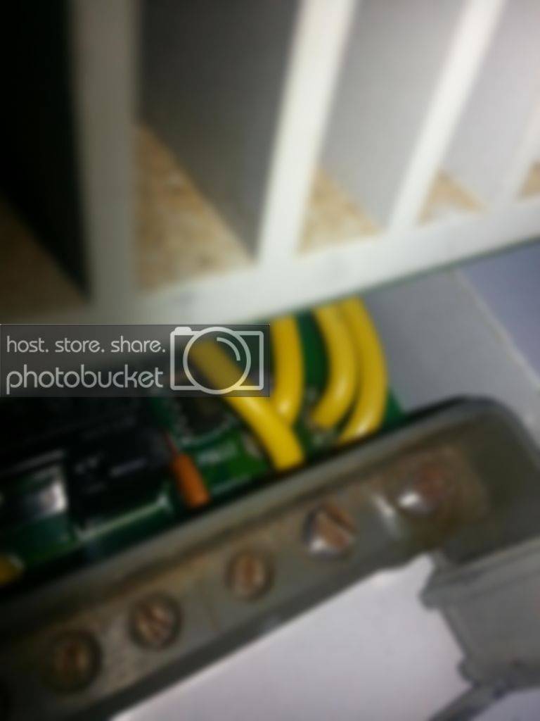

What do you guys think? I cracked it open to see if the inside looked ok. It looks fine. I honestly don't think it's ever been open before. Should I live drive my RCA to boost the voltage and keep the gain down? Is the amp damaged?
