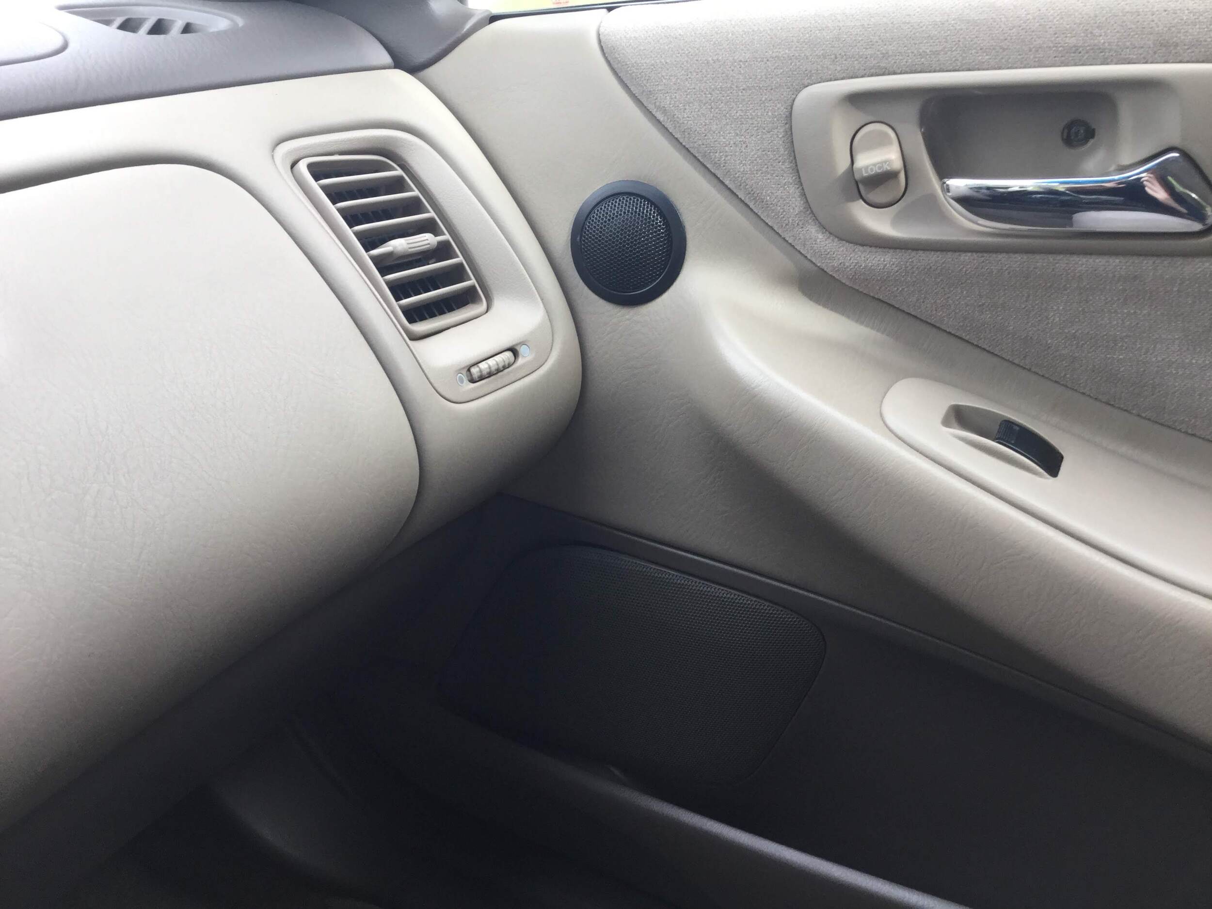

heres how i did mine. the mids in the stock location below the tweeter...
21223
