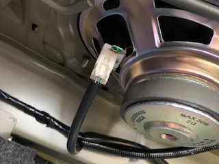

Trying to get an idea of the best way to install my Lc2i line output converter in my 2015 nissan sentra. I'm planning on using the rear speaker deck since it's nearby where I want to have my sub, only problem is I still have a few wiring questions
1. As you can probably see the speaker wires I would be splicing into are really thin. Guy at my local car shop told me to do the following: use a razor to carefully remove a 1/2" section of rubber around the wire, then twist the new wire I'd use for the Lc2i speaker inputs around the exposed wire, then solder and tape.
would this work? seems risky to me considering how thin the wire is and that this is my first install

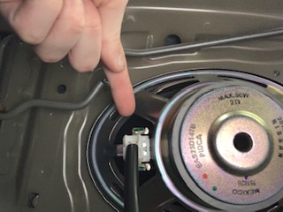

2. I was wondering if it would be possible to solder the wire for the Lc2i inputs directly onto the top of the thin metal plates of the factory speakers.
I'm not sure what these are called so here's a picture
