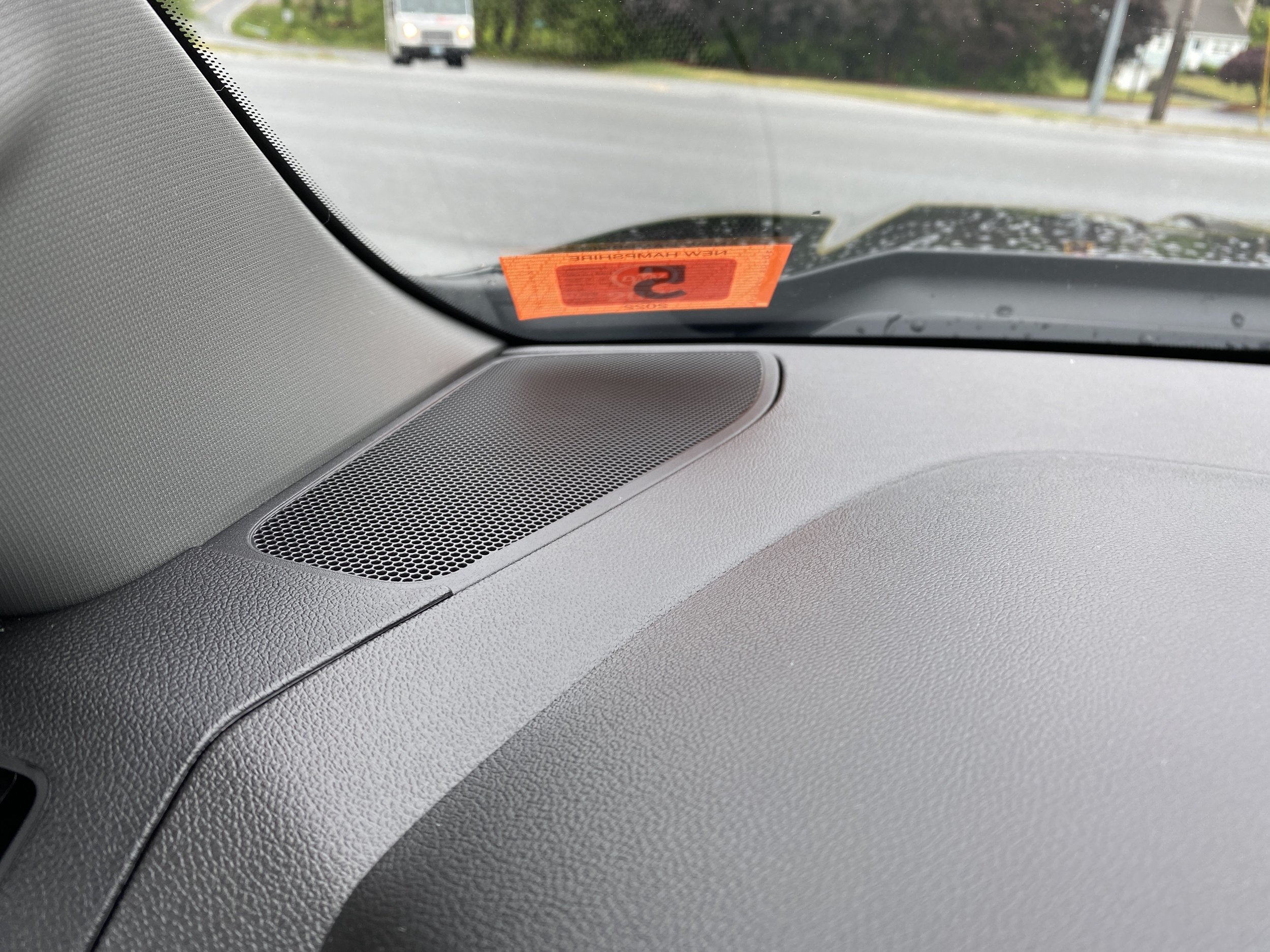

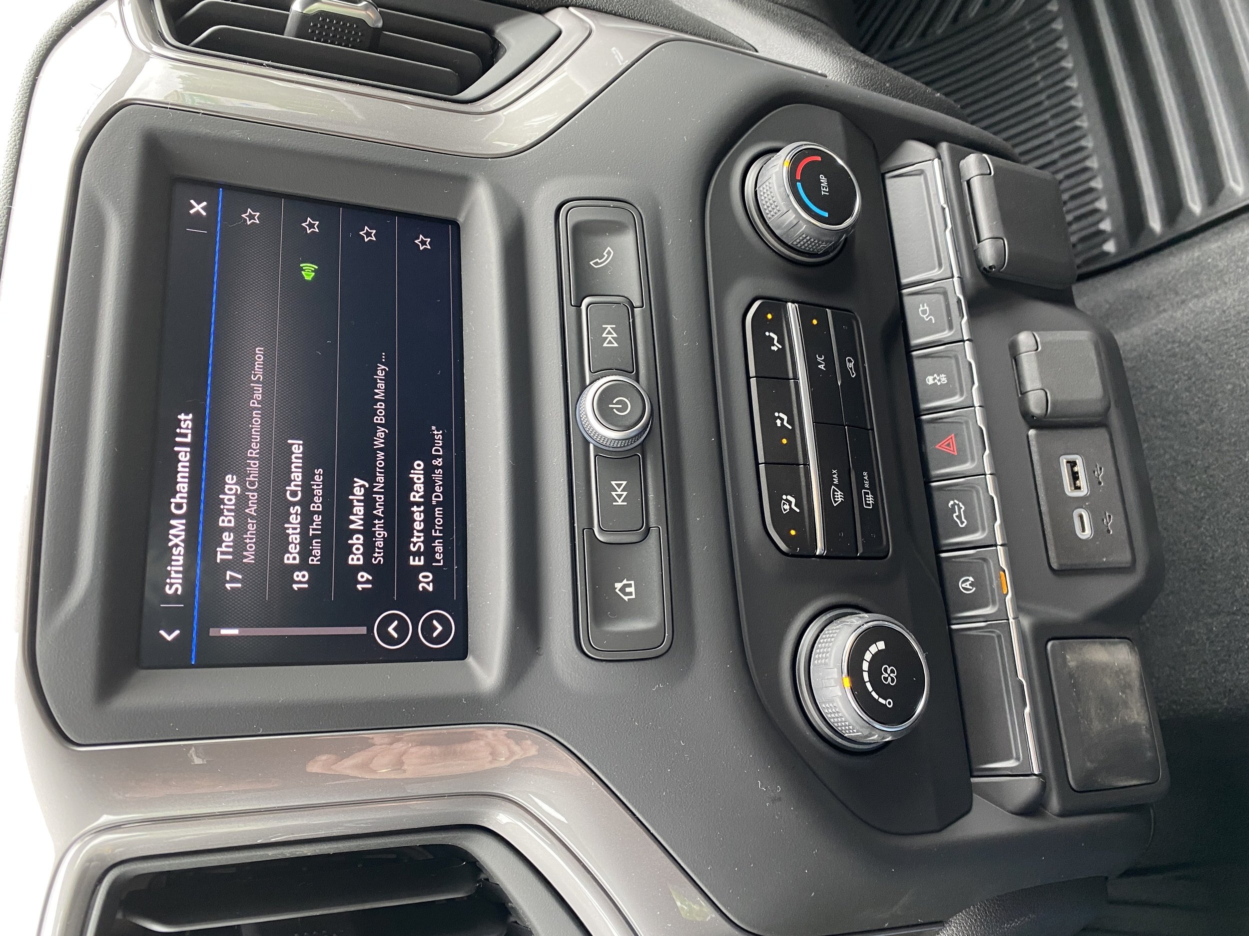

I just bought a 2021 Chevy Silverado replacing my 2010 Silverado. The stereo I had in my old truck was nice because I could use Focal speakers in the front with the tweeters up by the windshield, but this new truck, on the surface, seems like it may be a challenge to get a new decent system installed? I'm no pro, but this truck has speakers on the top of the dashboard and there are options for speakers in the front and rear doors, and it has the huge stereo that is standard.
Will I ever be able to get a decent system installed? I've attached pictures.

Of course. Should be a 6x9" in the front doors and a 2.75" full range in the dash IIRC.
You can use an Audiocontrol amp with built in DSP or go with a stand alone DSP.

Thanks for the scoop. I didn't know this and now I'll have to research. So, if I go this route, I won't need a new deck, but I also won't get any options like EQ, Auto Surround, time delays and such? Sorry, if there's a link that explains all this, please send it my way. Is installing a new Deck totally not an option? Thanks!
Stock decks now control more than just the radio
On my BMW the coding firmware for updating the car was in the deck for an example
My ex wife's dodge journey that I inherited when we separated had the climate controls in it
They are slowly making it harder and harder to put an aftermarket HU in.
If you remember what line output converters were back when, you run speaker wire into it and it gives you RCA outs but they really didn't have any power and sounded like ****.
DSP's (the link to JL ) are line output converters on steroids with lots of extra options. They are actually much better than most aftermarket decks anyway
