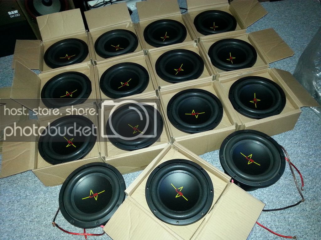

The powerplant has arrived! Got juice?

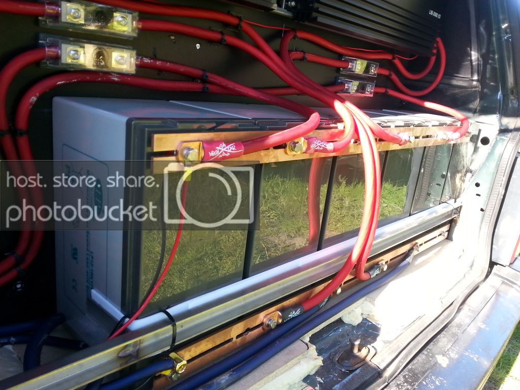

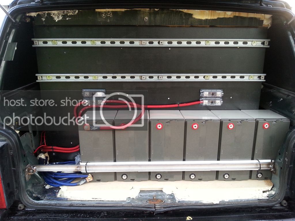

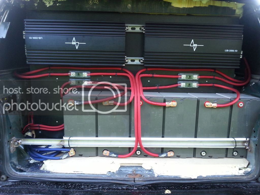

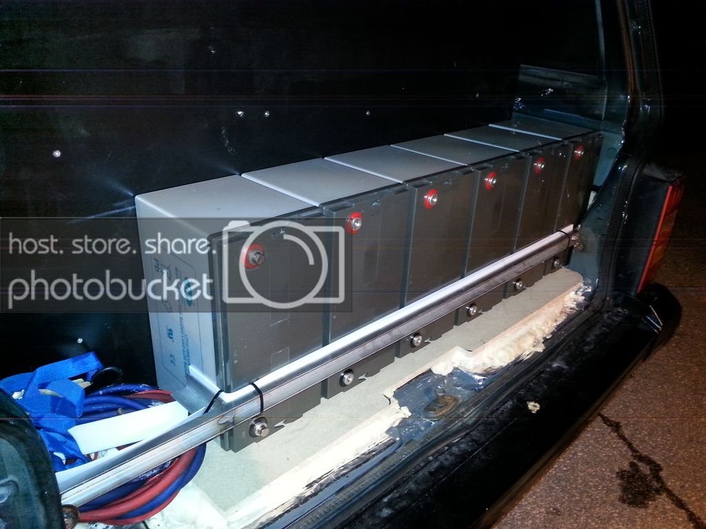

Started mounting them. I'll be using 6 batteries in the Jeep. These are LP 100ah group 31 //content.invisioncic.com/y282845/emoticons/smile.gif.1ebc41e1811405b213edfc4622c41e27.gif
Most power wiring is roughly done. Will try to make it cleaner when everything are in. Amprack in. Try fit both amps. They will be painted and get new stickers since one is upside down.. Also nice to have the right tools for the job!

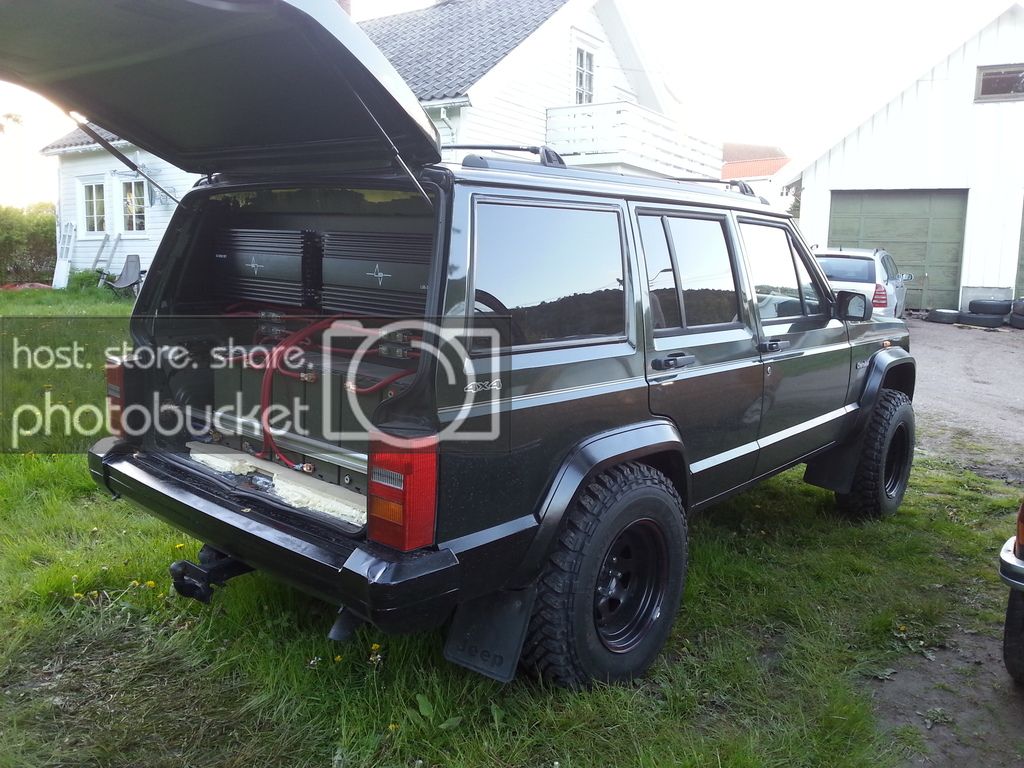

And about liftkit in the rear.. got weight? //content.invisioncic.com/y282845/emoticons/confused.gif.e820e0216602db4765798ac39d28caa9.gif Hope the leafs don't break!

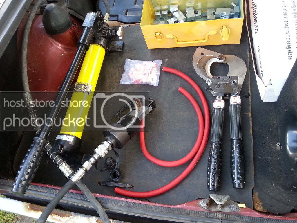

I'm a mechanic building fire fighting equipment, and we are using alot of unistrut. And we had the other tools in the workshop. Perfect for my hobby //content.invisioncic.com/y282845/emoticons/smile.gif.1ebc41e1811405b213edfc4622c41e27.gif

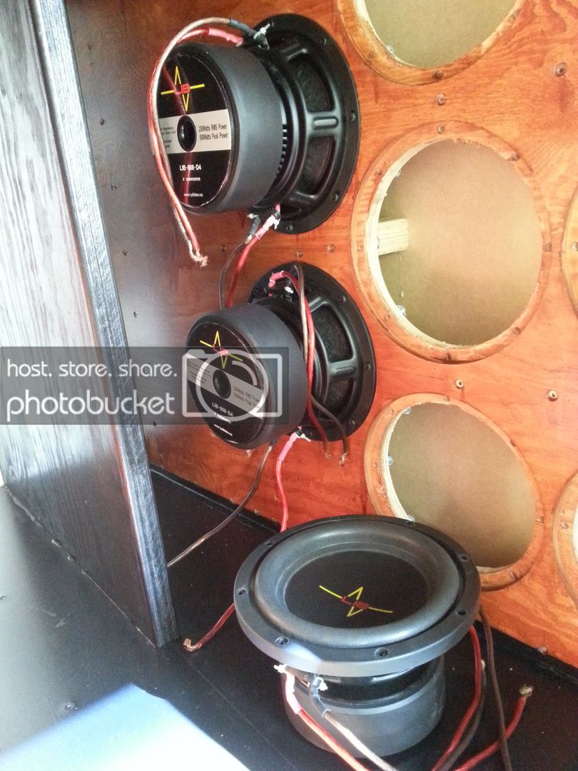

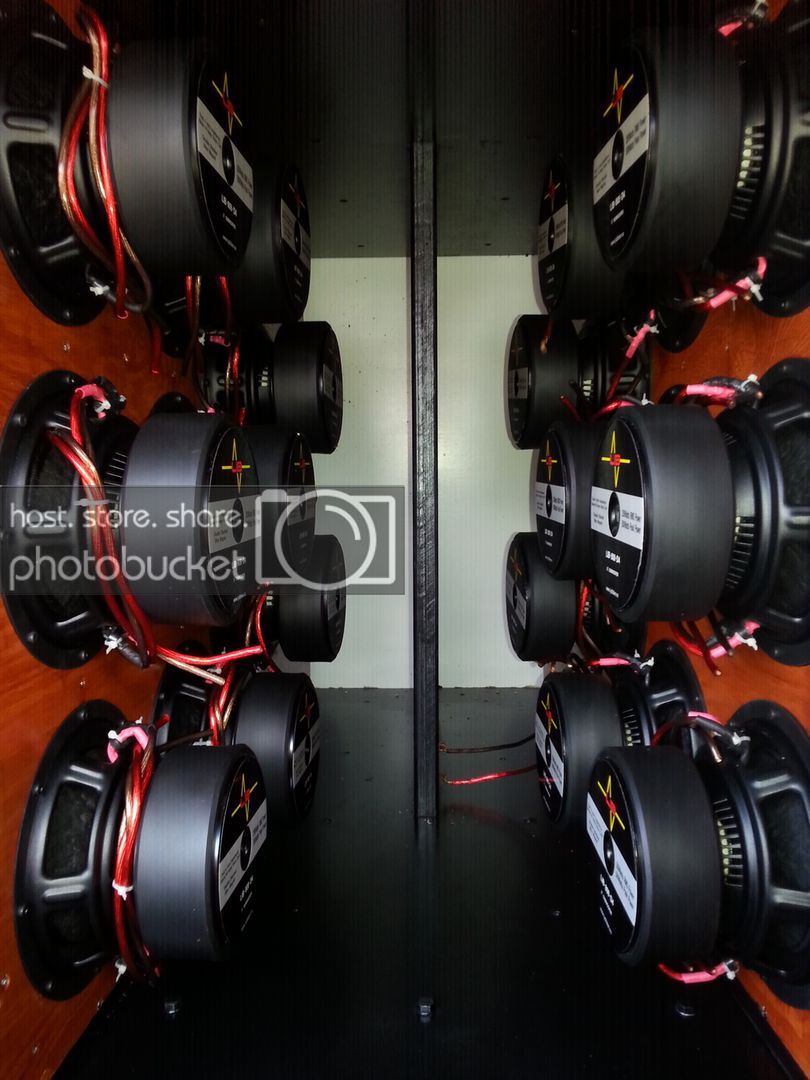

Quakerroatmeal: Yes I must invert mount them, very tight in the first chamber.. about 3" I think.
Jimmytheheater: If you have tried an diesel XJ you might change opinion, these are extremely slow.. haha, so with my stereo system its not fun to drive. But ofcourse the 4L wants some more fuel..

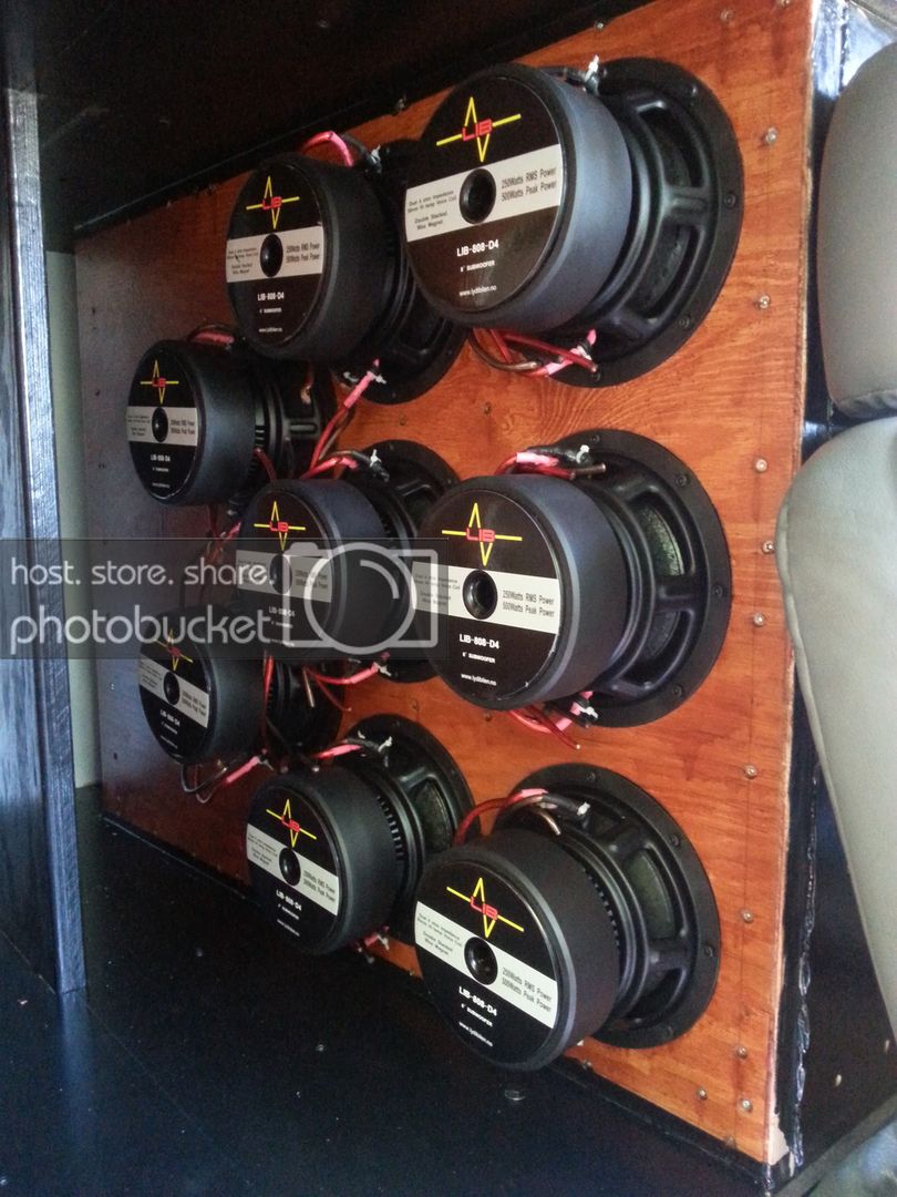

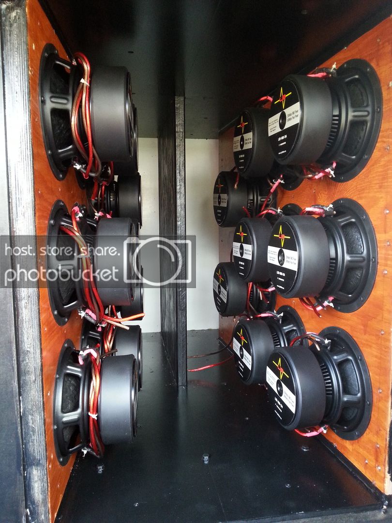

Woofers and batts are wired, heavy a$$ Jeep!

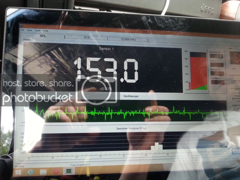

Have been testing a little now, and I'm impressed and happy how it turned out! This plays loud and nice, and pretty good from about 25hz to 100+
Voltage on idle is around 14,4 - 14,7 when I play, and 15v on 1500+rpm.
First test, peaked at 40hz. Woofers are not break in, wall is not sealed off and nothing is fine adjusted. A lot of roof & door flex etc so here is more potential! But I'm happy with the results, and since its my first real build //content.invisioncic.com/y282845/emoticons/biggrin.gif.d71a5d36fcbab170f2364c9f2e3946cb.gif
