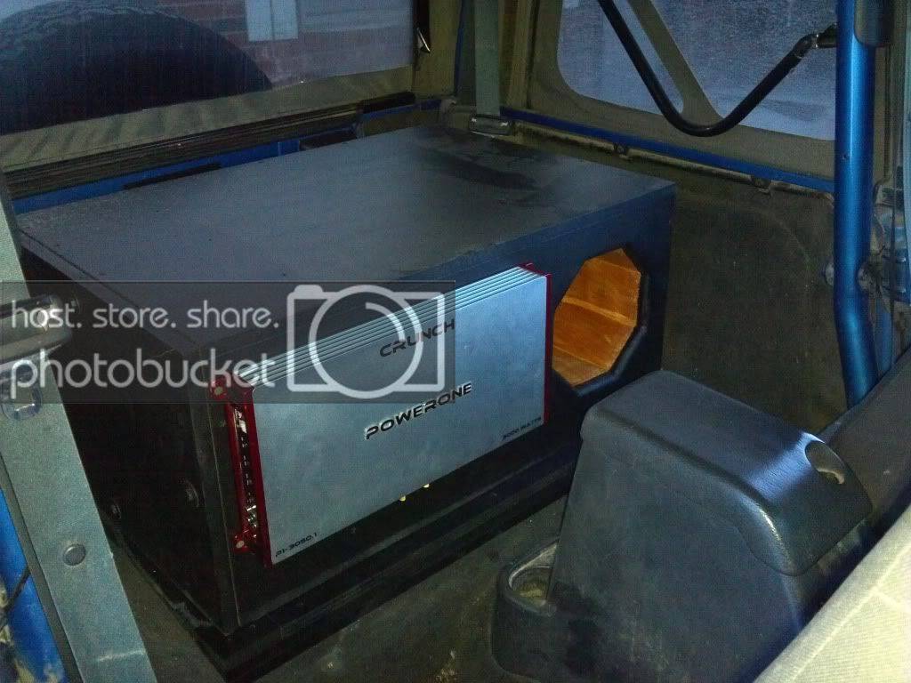

Anyway, sold my Dodge a few months ago to get some money paid off on this TJ. Bought the TJ about 1.5 years ago, and have been modding it since. This will be the only audio to go into it (along with a Sony headunit and some crappy Wal mart 6.5's that were already in it). Total, I've spent less than $150 on the sub/amp/box/materials, so I wouldn't be too heartbroken if something happened to it.
Equipment:
Sub: Funkin Audio SX10
Amp: Crunch P1-3050.1
Knu 1/0 wire

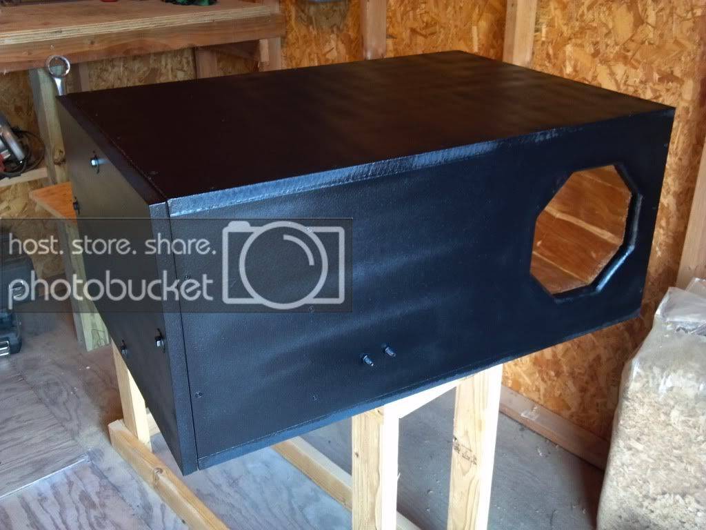

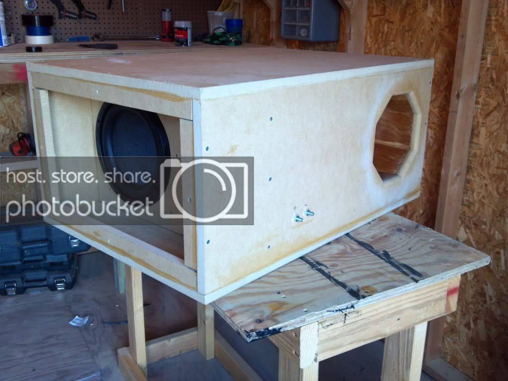

Box:
1.1 sealed
3.7 ported

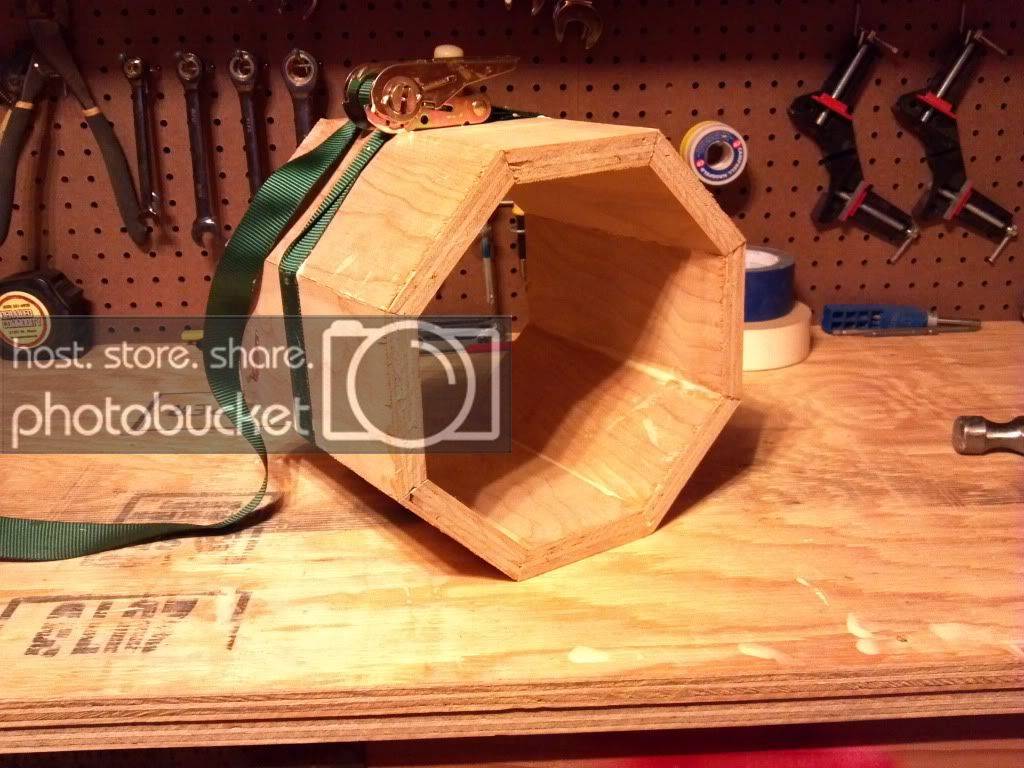

8.25" Octaport
51.91hz
Duplicolor bedliner coating with 5 coats of polyurethane on the port (which is birch)

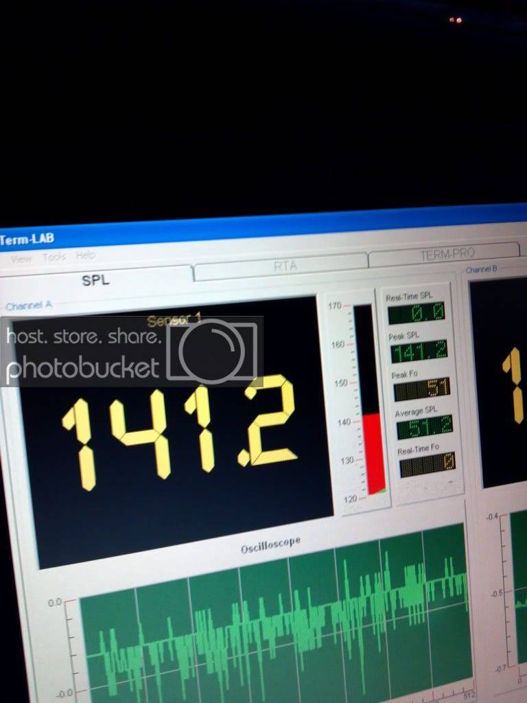

Hoping to do at least a 140 on music in a softtop jeep. I'll know in a couple of weeks when I get everything in, if I don't freeze my *** off first...

What do you mean? It's mounted so the motor is firing into the ported area, for better cooling. I wont be able to hook it up for another week or so since i don't yet have the amp or wire.
The Octaport is 8.25" is diameter, or about 58 sq in. It's big...
