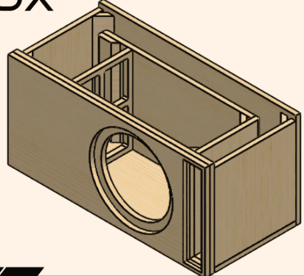

Put one of these in a 1.5 cu ft box, tuned to 30-33 hz, give it 1000 watts, sit back and enjoy! https://stereointegrity.com/product/sql-12-series-2/ -------------- Here is the perfect box.
33hz
Box External Dimensions
Width x Height x Depth
24.00" x 13.00" x 16.92"
Material Thickness0.75"
Net Internal Volume1.50 ft3
Tuning Frequency33 Hz
Port Area24.00 inch2
Port Inlet
Width x Height
2.09" x 11.50"
Port Length33.57"
Example (not the actual box)
33hz
Port Inlet
Width x Height
2.09" x 11.50"
Port Length33.57"

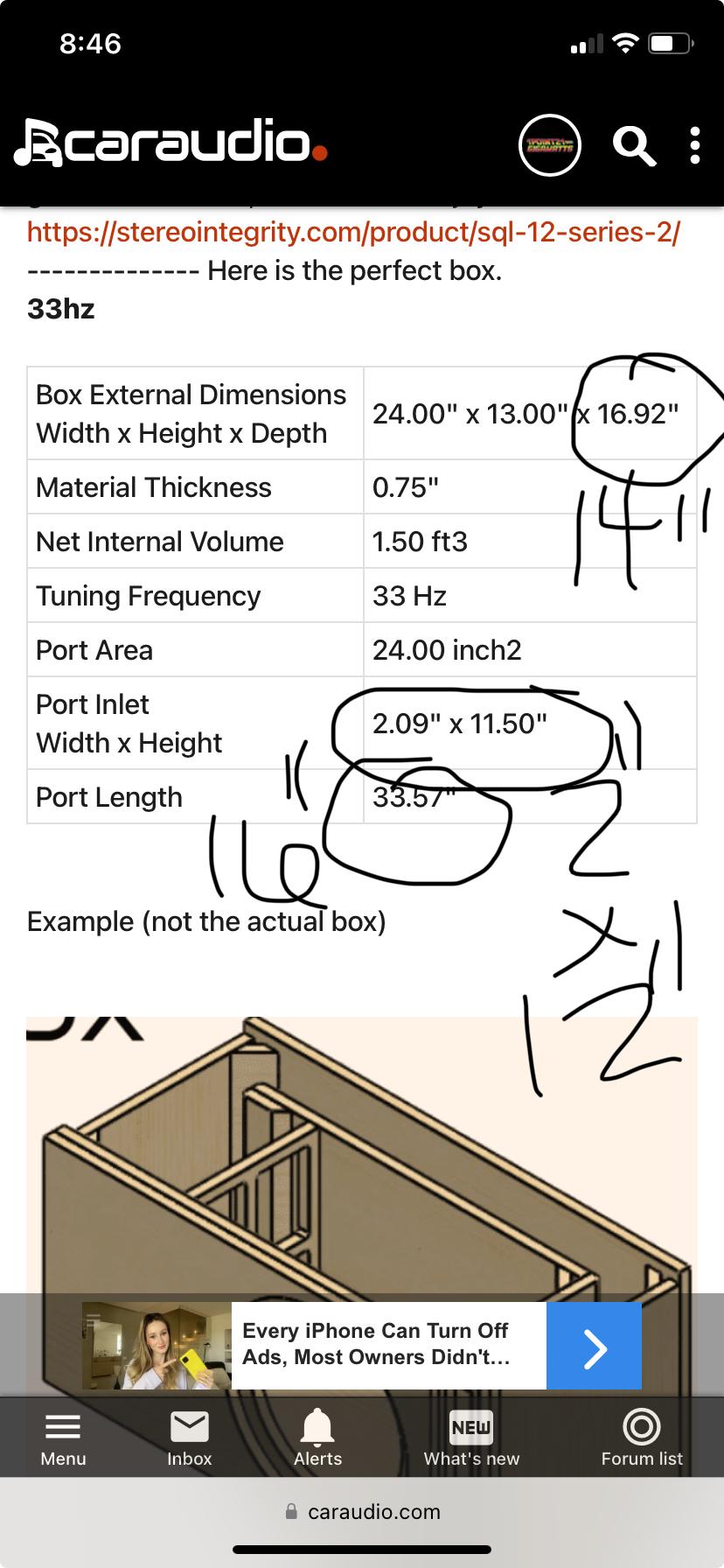

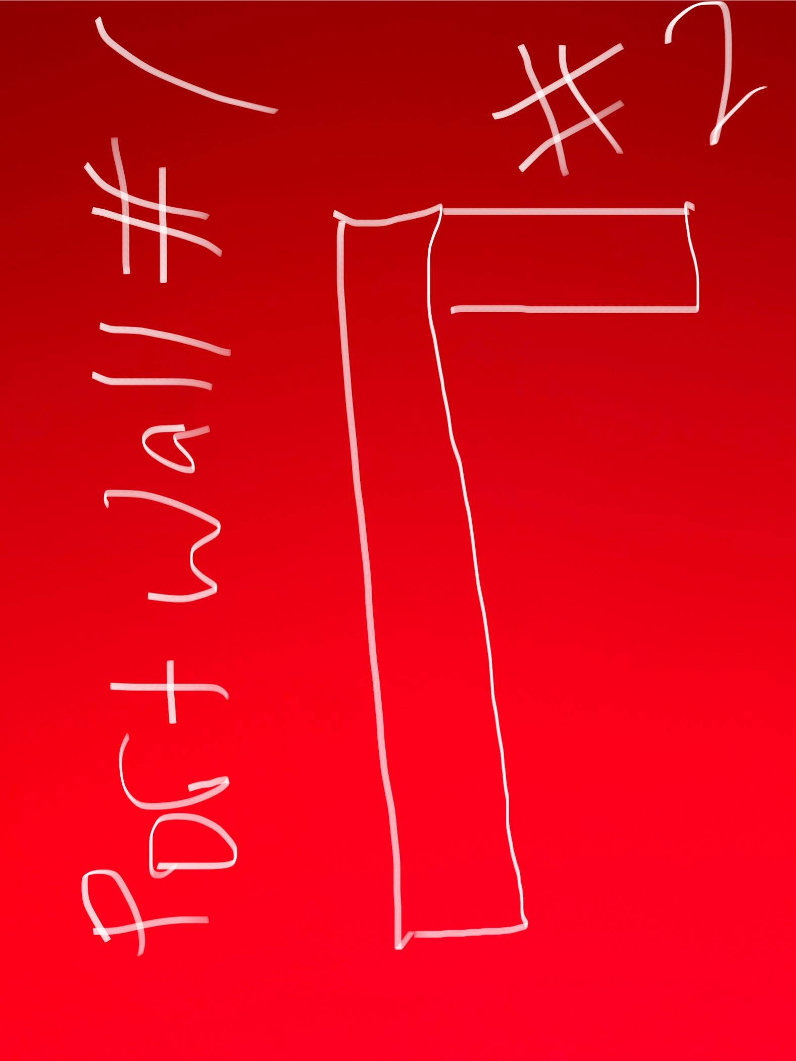

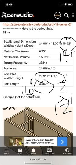

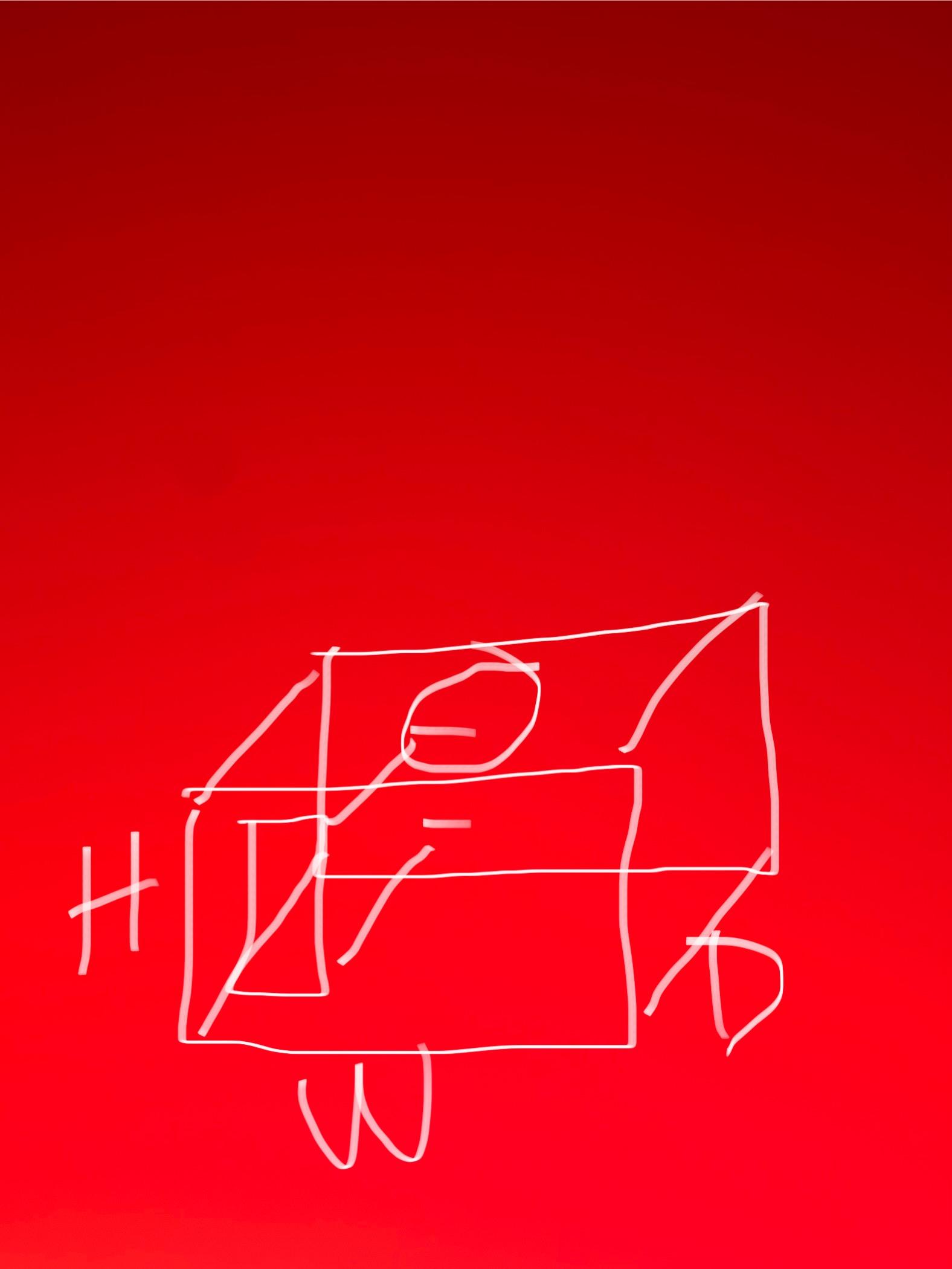

Good specs, wrong design. Kudos. Hold up.
Port specs- 3”x8”, 14” port length.
Box specs. 9.5” height, 16” width, 14” depth.
Sub up/port back.
Yes, but my amp will see the 2ohm load after the rise. That's my question. Your answer was a bit vague regarding amp's stability. How does impedance rise play into this?
Amp is rated down to 2. Wire subs down to 2. There is some wiggle room, but nobody on the internet will buy you new equipment, so play it safe or accept the risk.
Very few people on this site even know the difference between impedance and resistance.
Sub up/port back.
??? That box, tuned to 33hz, nothing wrong with that.
You can move the ports around if you want, but generally speaker-ing, when possible, ports are best left exiting the same baffle with the driver so the backwave of the sub couples with the front wave exiting the front. If you want to tune it lower, I get it, but that is just an example as I didn't see anything specific as to the tuning desired. 37-40, for volume reasons, 29 to 35 hz for sound quality reasons. Not a lot to hear below 35 hz and tuning to 25 while doable with that Si sub is doable, lots of wasted effort if tuning is too low.

Sorry bud, your box is too small. Si calls or a 1.4 cu ft box. With the adderd bracing that I put in and the corners braces too, you get to around 1.4 cu ft net. that port is tuned to 33 hz which you could change if you wanted too. the measurements you provided only give you .83 cu ft net using .75" thick ,aterial.
The one I corrected for you is 1.75 cubes. The one I drew out for him is 1.5 cubes. No program can do this.
It happens. Programs are never spot on. Figuring yourself is the best way. the12volt.com is the best for calculators for figuring. On the port figuring if round, you half to add an inch if the aeros are flared. That’s it.
I already got the box volume requirements from Si. That box I provided takes into account the driver, port and brace displacements too. It's pretty spot on.
