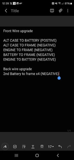

I'd consider a dual output alt lug and many heavy gauge grounds throughout. Alt case to batt, engine to batt, engine to frame, alt case to frame and frame to batt. Big 3?.. haha. Then rinse and repeat in back where the amps are. Wire always ate my wallet up but cost less than the alternative. 2 runs everywhere min, sometimes 3 and 4 from the rear (main) battery to amp, 4 from the rear battery to frame. This was for 3K clamped on a single sub. And with a 250a alt why maximize current flow? The results spoke volumes.

Do I need to run multiple postives or just grounds. Here's what I got so far please lmk if I'm wrong. The amps are wired to the wmd battery so right now I have ground and postive on both amps to the battery then 2nd battery postive to main battery postive and 2nd battery to frame. Where do I need to upgrade the rear
