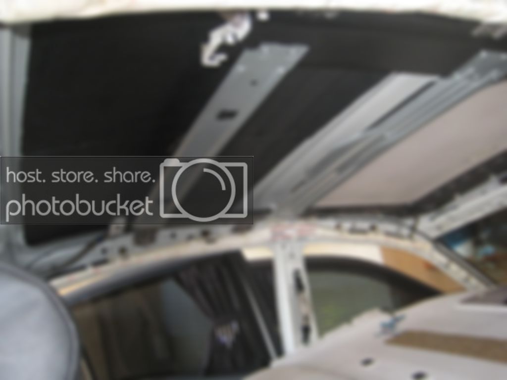

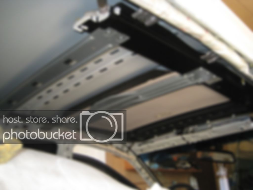

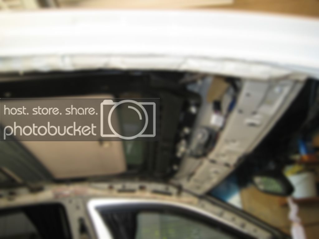

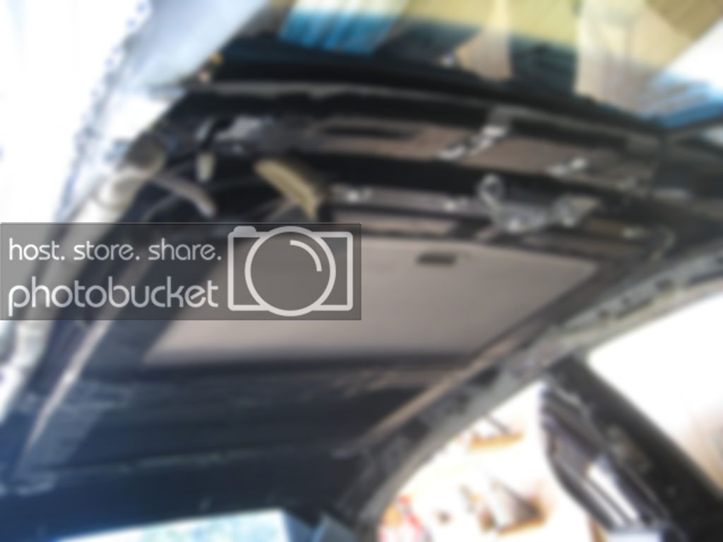

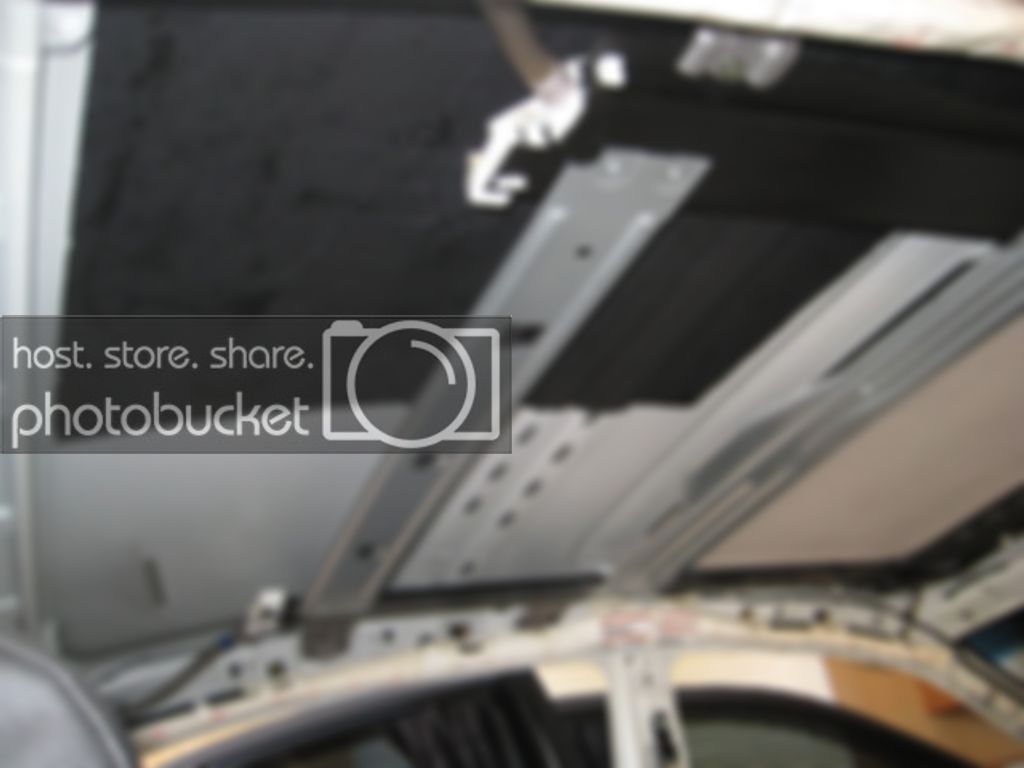

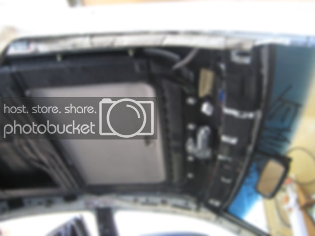

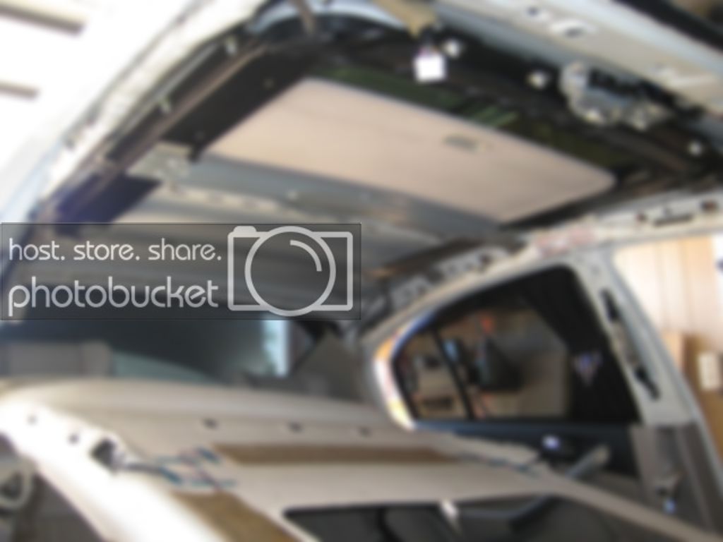

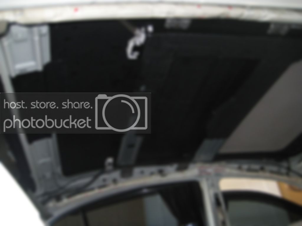

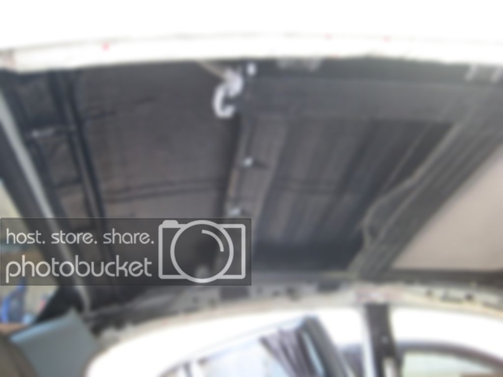

Started deadening the roof today. My gosh it was a pain in the rear. I got the headliner off without much trouble, but getting it out of the car was another story. Didn't get it out till I stopped doing some work and a friend came over and helped me out. Thanks Robby //content.invisioncic.com/y282845/emoticons/smile.gif.1ebc41e1811405b213edfc4622c41e27.gif
Anyway, majority of the roof is done. Just need to finish up the driver side in the rear and do the front a little. Hopefully I'll have enough for my trunk, but I don't think I'll have anything left for my doors. Using a shop pack already. BTW, I'm using two layers and I'll be finishing this up tomorrow.

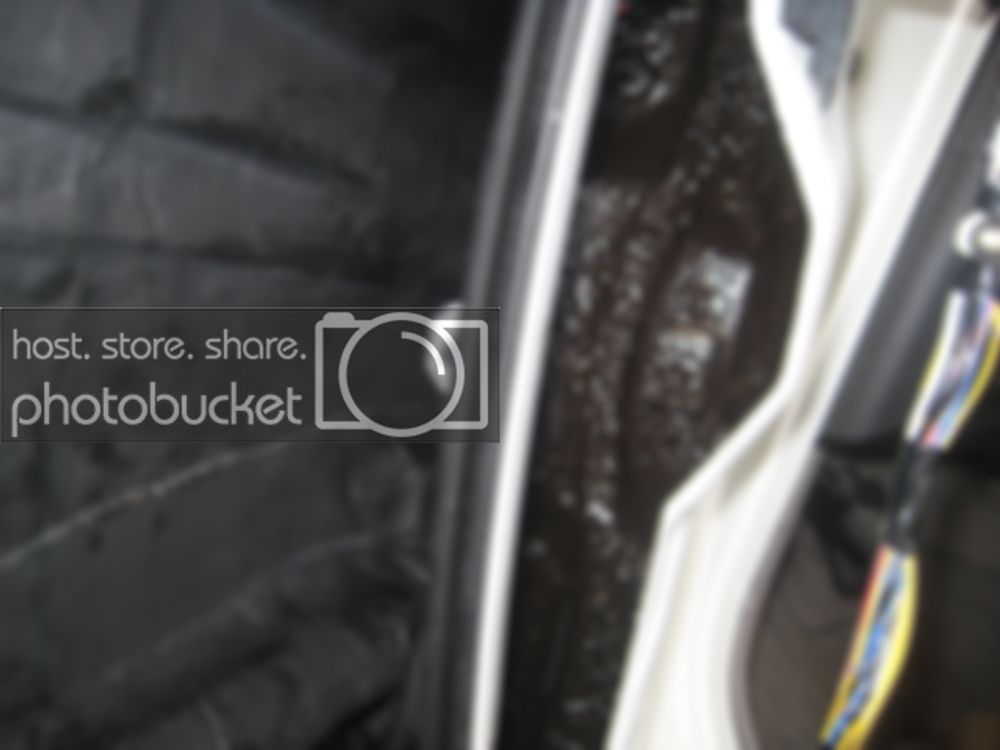

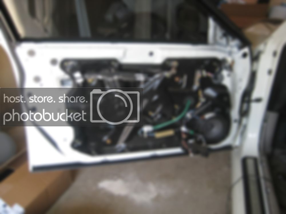

Started deadening my doors and I will do it as follows:
Inner part of door: 1 layer Damplifier Pro, 1 layer Overkill Pro
Inner black metal sheet: Same as above
Outer black metal sheet: 1 layer Damplifier Pro, 1 layer Luxury Liner Pro
Outer part of door: Same as above
Some areas are tough to get to so I'm using rubber undercoating (what you spray on the truck beds, and Spectrum.

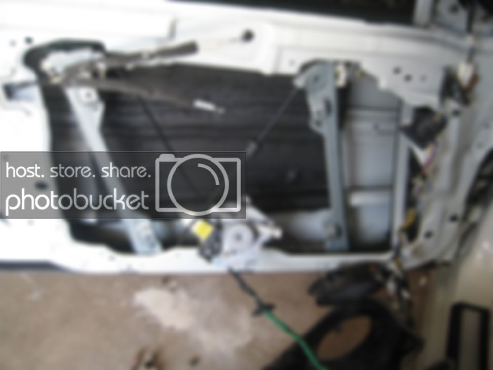

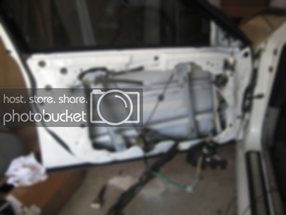

Untouched door:
Black metal sheet removed and cleaned:

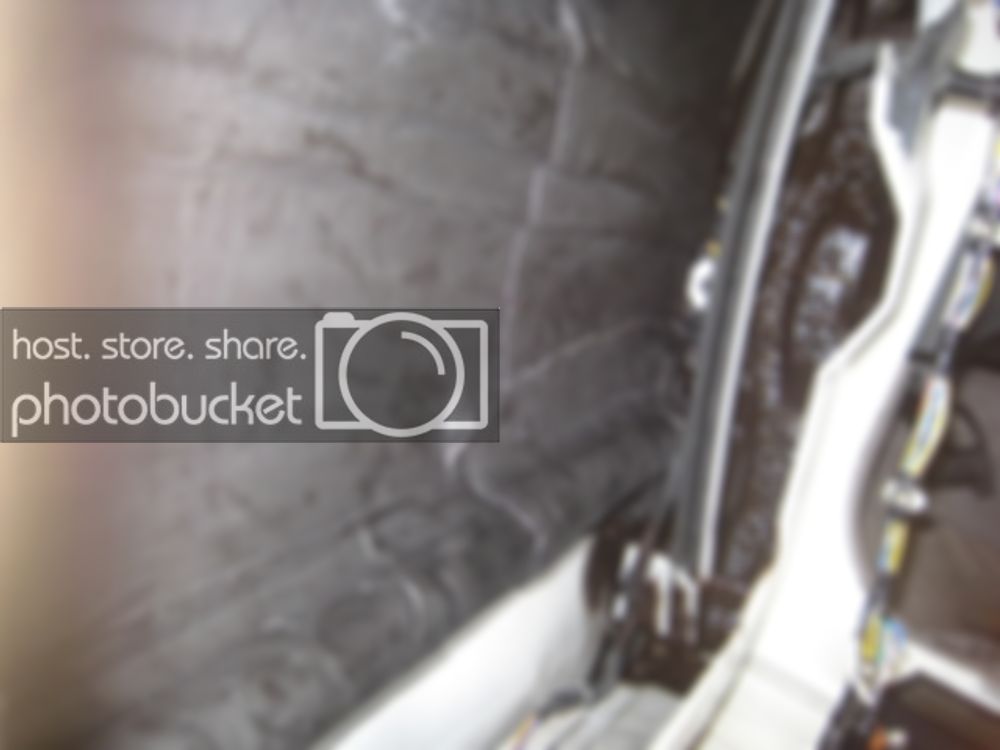

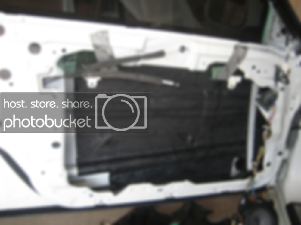

Starting the deadener install:
It wasn't till later that I realized I could remove the two bars to make it easier:
Rubber undercoating sprayed:
What I have done so far:

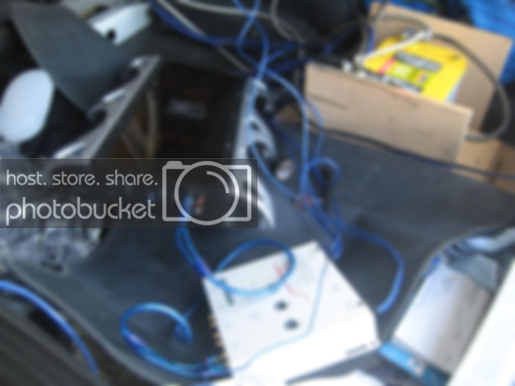

Here's a couple pics, but I have more work to do. Gonna see about hooking up some mids and another amp for them. If all goes well, I'll put everything back together. Found out the cheap Kicker subs I got off craigslist are messed up, so I'm in the market for some other budget subs. Wish I hadn't sold some of my other ones //content.invisioncic.com/y282845/emoticons/frown.gif.a3531fa0534503350665a1e957861287.gif
Rather than using a small little LOC I'm using an Audiocontrol LC6i. Got it from a friend and might do some EQ/XO settings with an add on unit, but we'll see. I just need some bass right now. It's been too long without it.

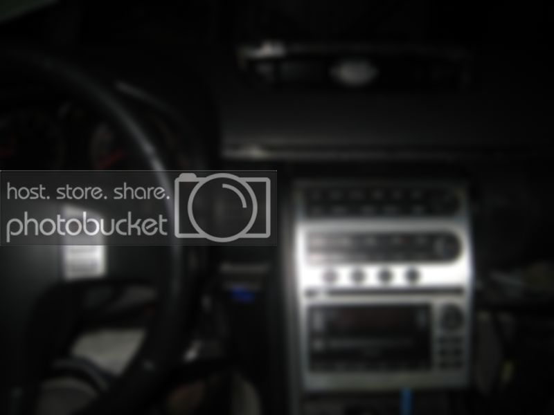

Testing out the Stinger voltage meter. Will be placed somewhere up front that is visible. Will be very useful once I get the full audio setup going on.

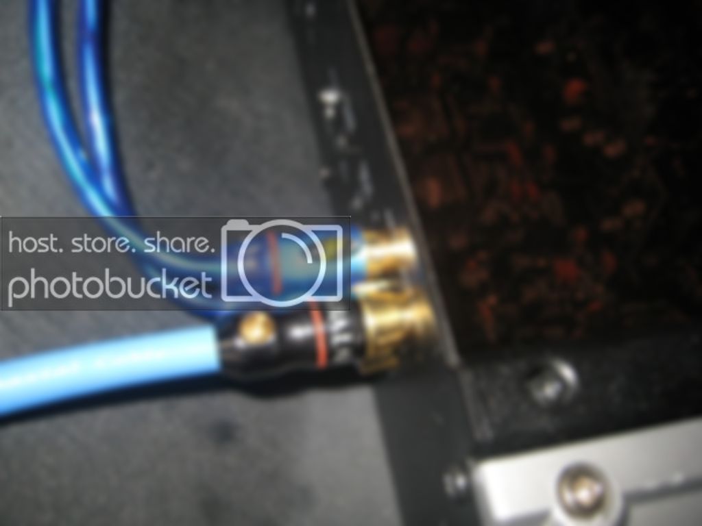

A comparison of the Tara Labs RCA ends I will be using as opposed to the Stinger RCA's I used to test out. Picture doesn't do these RCA ends any justice. They're black chrome with gold tips. Nice and solid. Well worth the $5 each price tag I paid several years back.

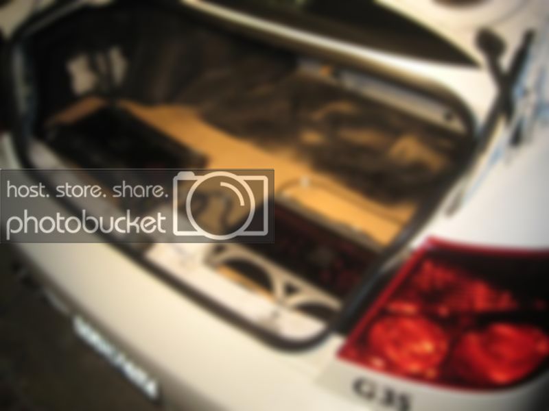

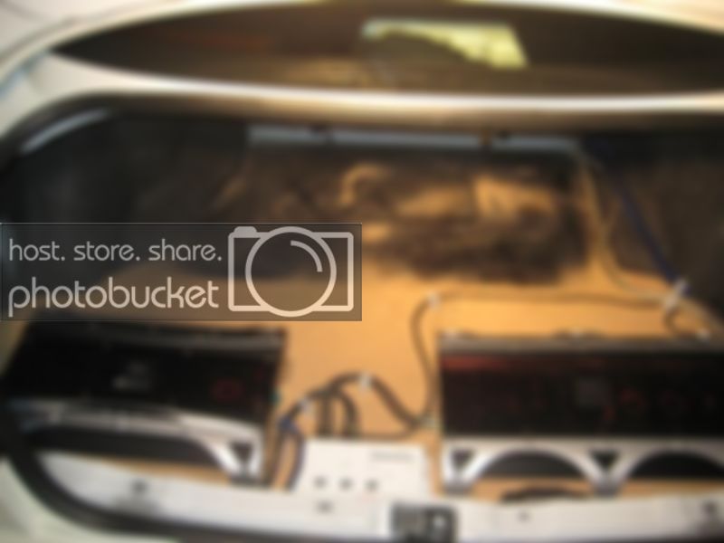

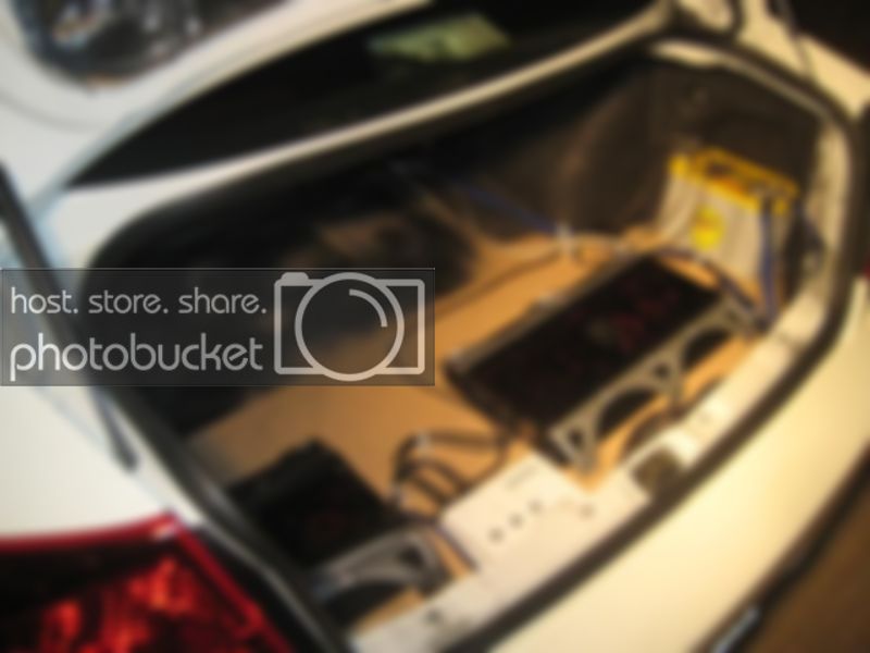

Long ass day. Got pretty much everything wired up. Since I need more wire I'll make baffles for the mids and mount them and the tweeters when I get wire. All that I have to do after that is mount the crossovers in the trunk, hook them up and do some quick wiring to the amps and I'll be done. Still on the search for some decent subs. Anyway, here are pics of what I got done today.

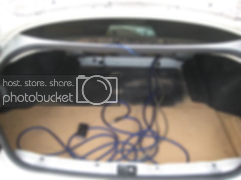

Starting off.....with an empty trunk.

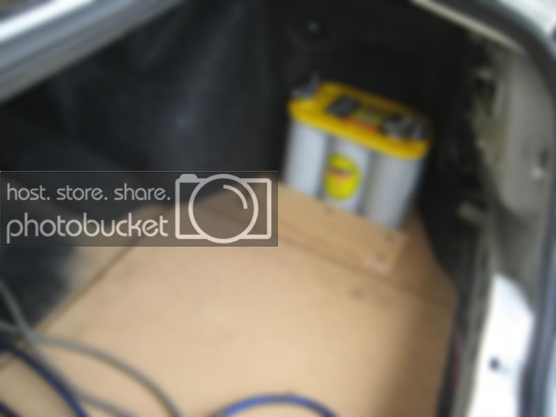

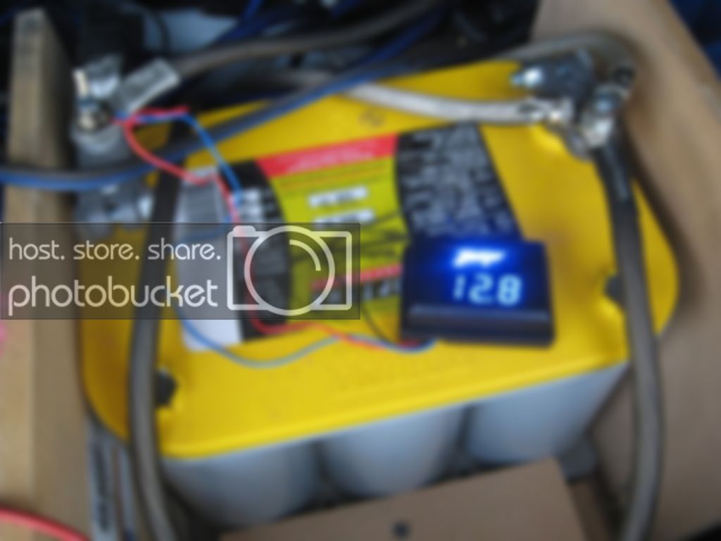

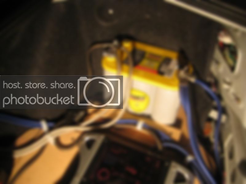

Mounted the battery.

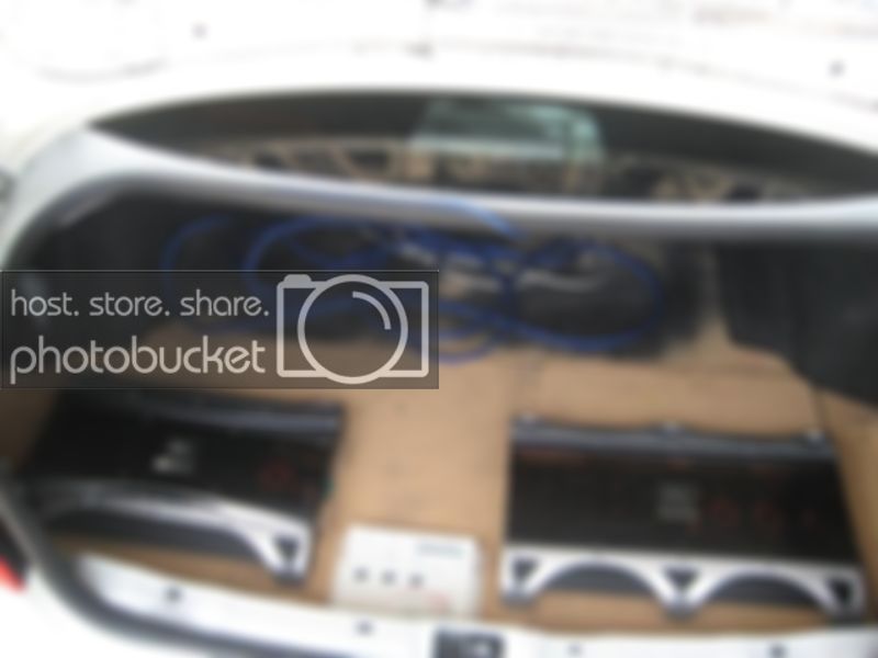

Mounted the amps and LC6i.

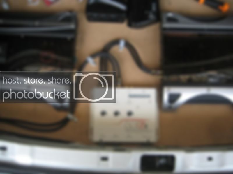

Made some RCA's with Tara Labs RCA ends.
Mounted a ground distribution block next to the battery.

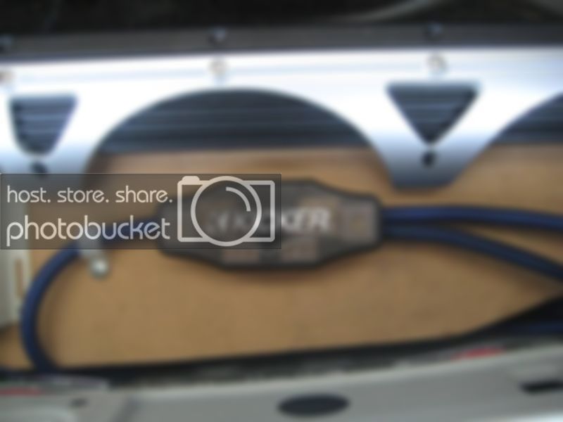

Mounted a power distribution block below the sub amp.

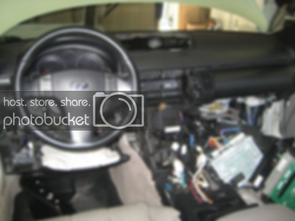

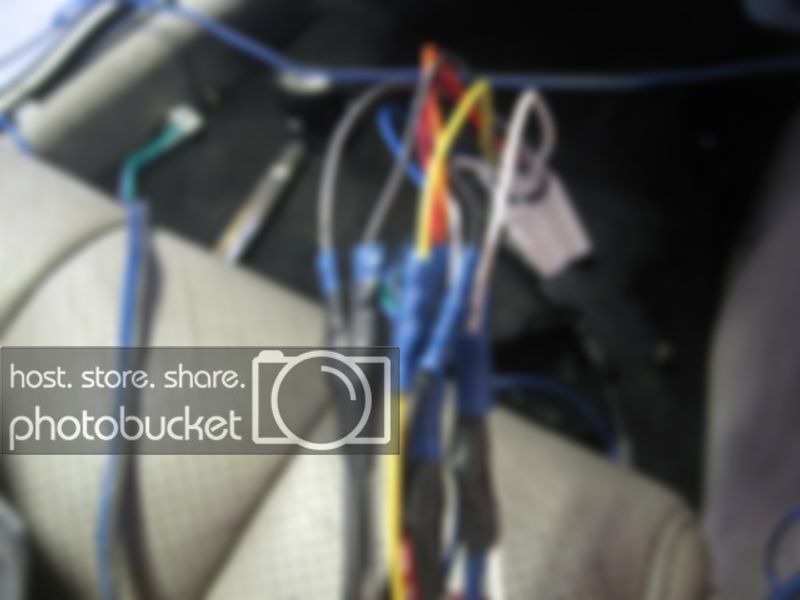

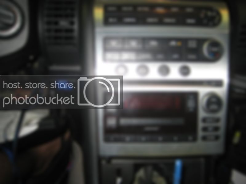

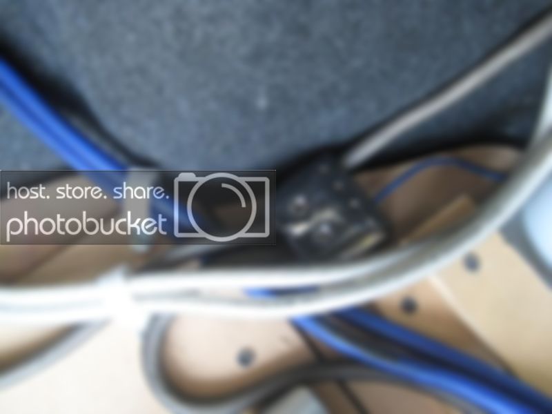

Moved onto the head unit and rather than twisting the wires and using electrical tape, I used butt connectors for a clean install.
Ran wires from the LC6i to the Stinger voltage meter and mounted it in a location that wasn't distracting to me or the outside and still visible. Batteries run at 14.5 - 14.8V //content.invisioncic.com/y282845/emoticons/biggrin.gif.d71a5d36fcbab170f2364c9f2e3946cb.gif

not bad my man. I personally hate butt connectors with a passion, but if your gonna use them. Clip the wires at different lengths, that way your butt connectors end up in different places instead of all in the same place( big bundle of butt connectors). Makes your wiring easier to tuck away. //content.invisioncic.com/y282845/emoticons/smile.gif.1ebc41e1811405b213edfc4622c41e27.gif
