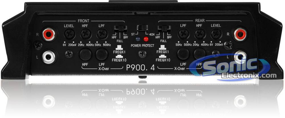

this:http://www.caraudio.com/forums/amplifier-classifieds/558221-precision-power-p900-4-145w-x-4-4-available.html
wire the coaxes to the rear channels parallel in stereo for 100w ea. and the morels to the front channels for @ 75-100w ea...this will also open up the option of running the morels active HP on the built in x-over and keeping the coaxes FR...and should you decide to replace the coaxes with some decent midbasses down the road, there ya go.

hmm..the two morels are 8 ohm, the 4 coaxes are four ohm, the morels will draw 1/2 the power of each coax. You have ch 1,2,3 and 4. channel 1 & 2 will be the front channels on the amp and channel 3 & 4 will be the rear channels on the amp. Wire the the left morel to channel 1, the right morel to channel 2..the left 2 coaxes will go to ch 3 and the right 2 coaxes will go to ch 4 ....lol...hmm..on the PPI it is mapped out front/rear & left/right...same thing though:
