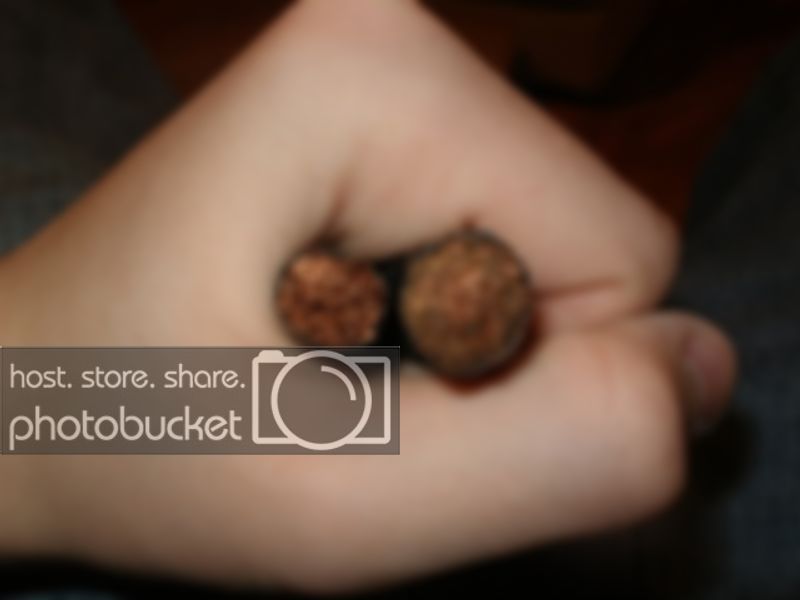

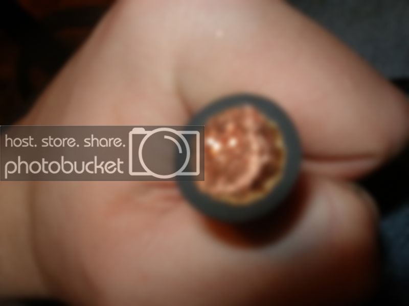

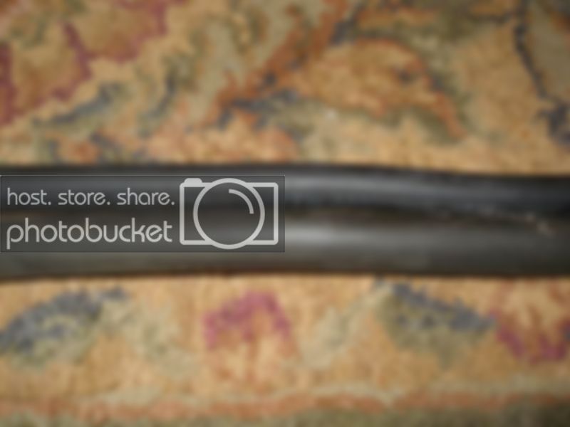

is this decent 1/0?
dammn you counted all the strands....lol. and 625 isnt alot at all...most 1/0 is in at least the 4500 range. Knu Kollosus is 5k+
rofl yeah, i got bored for 10 minutes //content.invisioncic.com/y282845/emoticons/uhoh.gif.c07307dd22ee7e63e22fc8e9c614d1fd.gif
Without knowing the gauge of strand....If 28 gauge strands you have 1 Gauge (nearly 1/0, about 10% under AWG) If 30 gauge strands you have standard 2 gauge.
This is all based on 625 strand count, usually rope lay is based on ropes, you have X amount of ropes with Y amount of strands. Counting one rope for its strands and then mulitple by number of ropes to get the exact number.
i measured the strands they are .010 of an inch //content.invisioncic.com/y282845/emoticons/eyebrow.gif.fe2c18d8720fe8c7eaed347b21ea05a5.gif
well i got some 2/0 now //content.invisioncic.com/y282845/emoticons/smile.gif.1ebc41e1811405b213edfc4622c41e27.gif
Use the 2/0 wire //content.invisioncic.com/y282845/emoticons/smile.gif.1ebc41e1811405b213edfc4622c41e27.gif
yeah im going to, hopefully it should be more than enough for my 1500, its going to take some finesse to get it into the terminal on it though lol
If you need to you can trim a few strands here and there. The overall wire resistance is still alot lower than a smaller wire, losing a few strands won't hurt anything if it doesn't quite fit //content.invisioncic.com/y282845/emoticons/smile.gif.1ebc41e1811405b213edfc4622c41e27.gif Although I'm confident you can make it go in there... my brother got KnuKnoceptz Kolossus into his and I don't imagine that could be any bigger!
