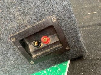

Follow up question, does anyone here know what kind of connector I need for this on my sub? Sorry I’m new at this haha.
Yes you can use Bannana Plugs, and you can unscrew the caps and there should be a hole to run bare wire through and tighten those back down. I just use 12ga or 10ga speaker wire on those. Try to use 100% OFC rather than Tinned or CCA speaker wire.
