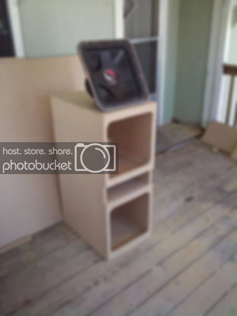

Mines actually a bit bigger and ported. Like this one. http://di1-4.shoppingshadow.com/images/pi/50/ce/42/103711213-149x149-0-0_Kicker+15+Vented+Subwoofer+Box+For+2+Kicker+Soloba.jpg

Mines even older. Its the silver one lol. That box looks similar to mine (size wise) Thanks for the help, i appreciate it
