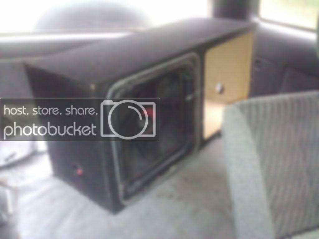

those subs are junk so dont try to give em to much power, ull just get clipping from the amp and blow em or just plain give them too much power, its not the gain of 300 watts that will make them louder its the righ box, 15" squares like that work best in like 4-6 cubes.
This is the box you might ( most likely ) have:
... And they actually do the job: I had (2) 15" Kicker L7 powered by a Diesel Audio NS-3000.1D
