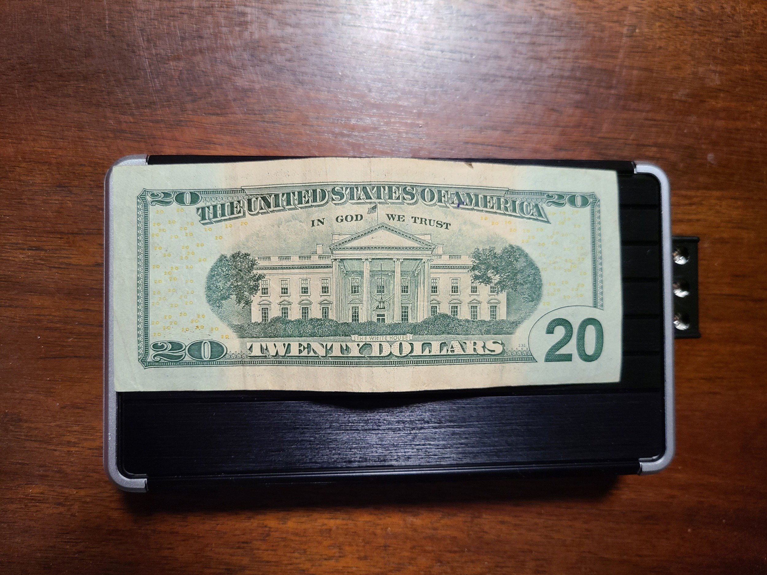

Amps can be pretty small. This is my Cerwin Vega B52 amp that is 150w x 2 @4ohms RMS, or 500w x 1 @ 4 ohms. This would fit anywhere. I know I got a good deal on it. I want to say $80 or so, you just have to find em at the right time.

Thats pretty small amplifier for sure. I had some NVX mini amps=2(300 watt Mono) and a (50x4) that were pretty small did really nice,and I had a mini Stetsom 2 ch that did really great on some 6x9s.
