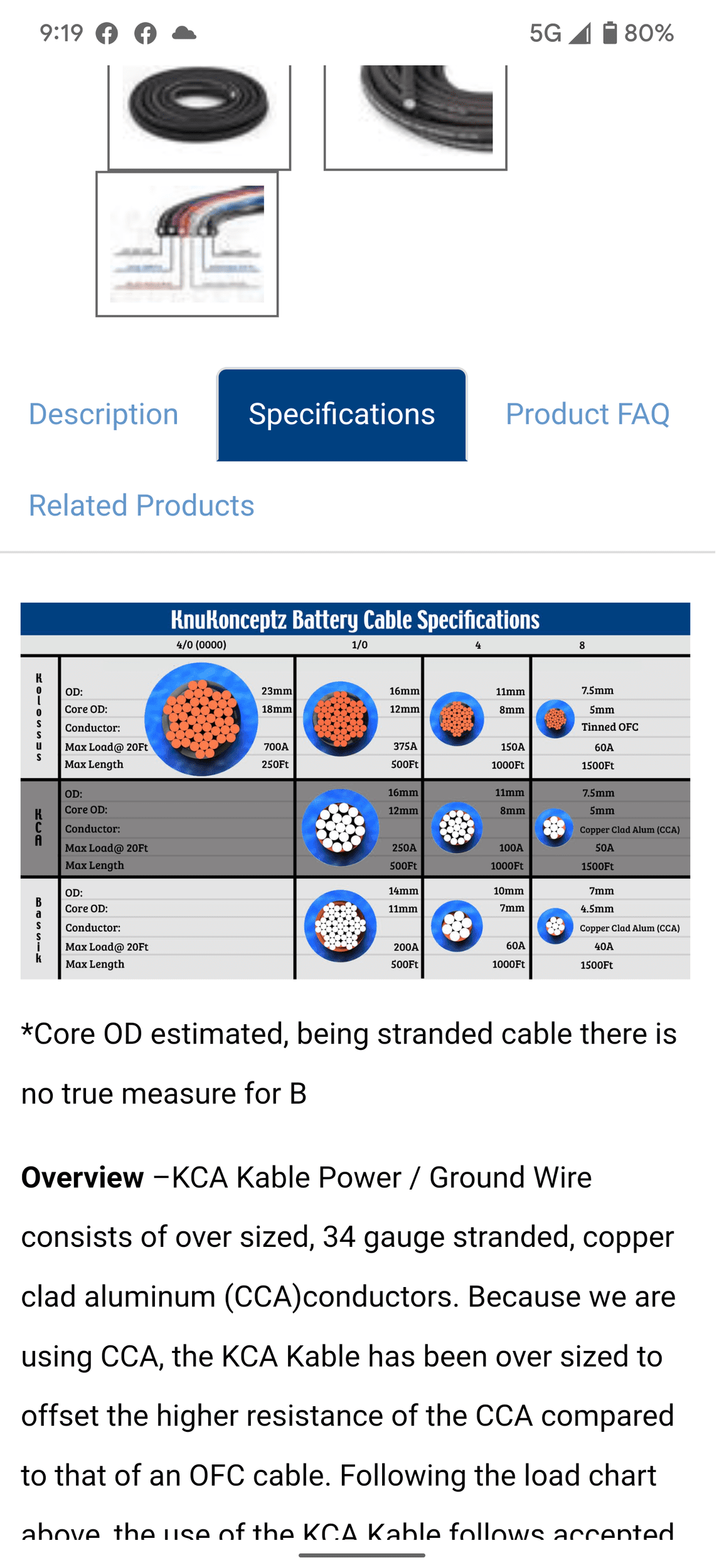

Yeah I already had purchased the kca 4g amp kit from koncept
This is the max fuse sizes for the knu wire.
The kca 4awg kit can supply 100amp to the rp1200.1 but it won't have enough left over for the rp75.4 you'll need a separate kit for that
