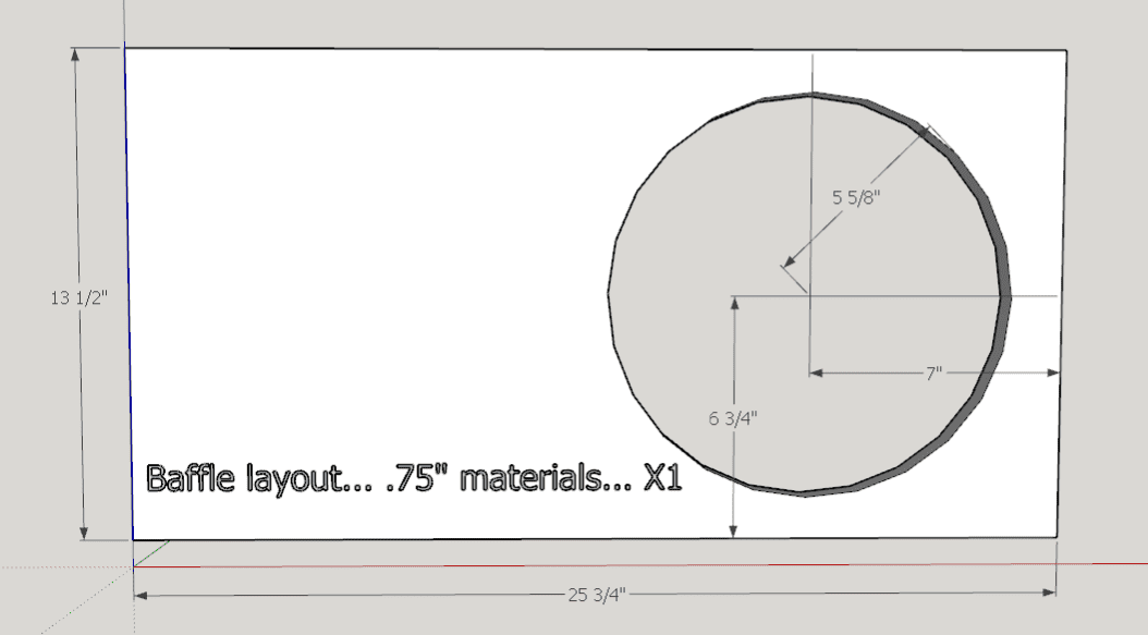

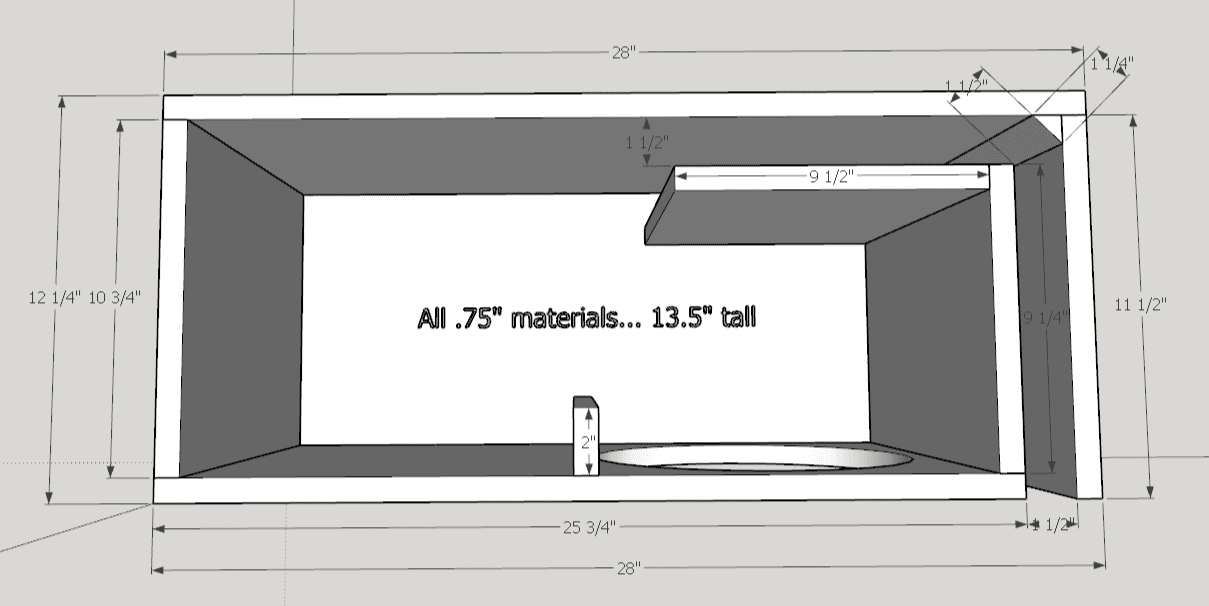

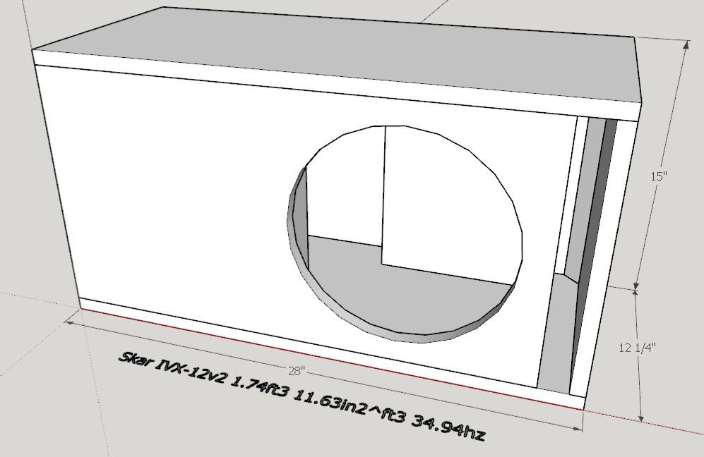

Here's a freebie for ya'... all ya' gotta do is build the thing... I hate seeing people use most prefabs, this should do ok...
Should be able to build that one cheap AF... lol
I need to see what I can do with the Box I have, and SEE if I need to just build a new one. ITS BIG, was made for 2 Boss woofers I did a project for. I am going to have to ask some of you guys for advice on this. it works really well right now as far as SQ from the sub I got.
