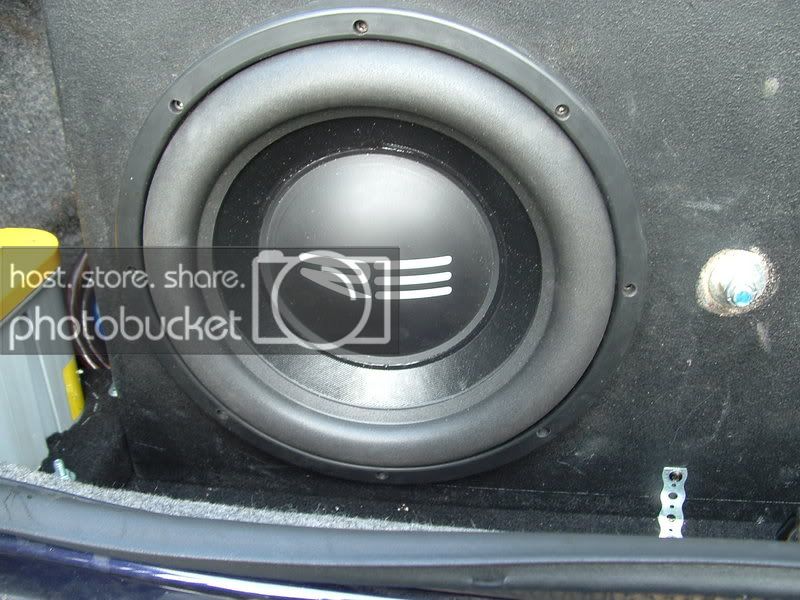

Well got it all in there just have to do a few odds and ends to clean up the wires and get the dust off the box but 99% finished.

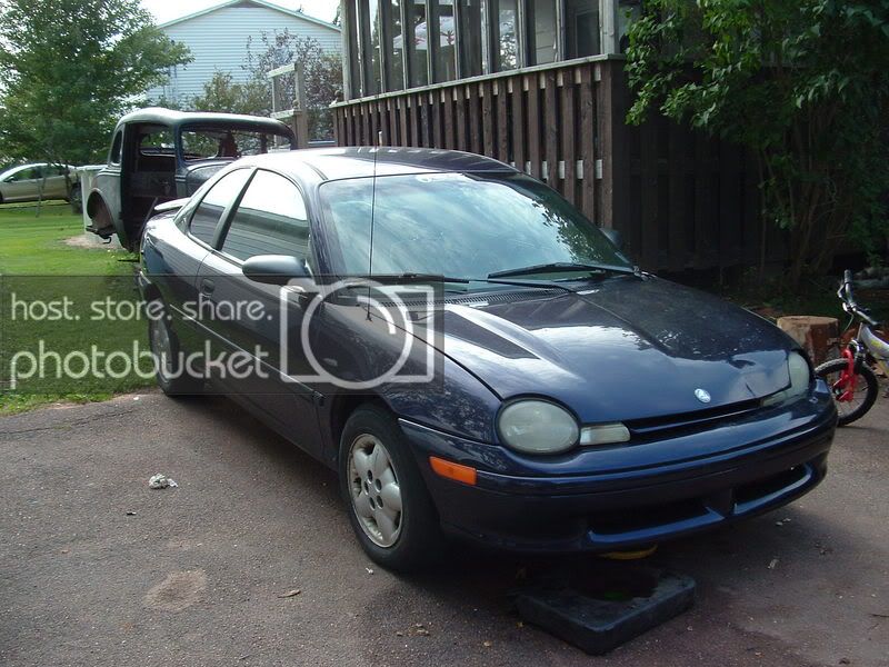

The car. blew a rad hose today but all fixed up and ready to go.

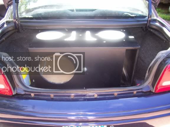

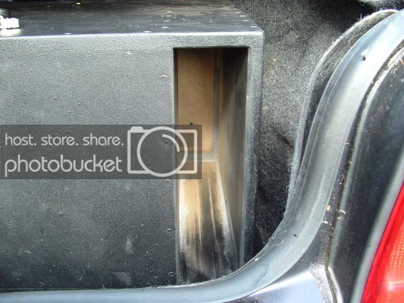

port 3.75" wide 13.5" tall 3 cuft after sub and port tuned to 35-36hz
Mt looking good. about time I got it back.
Installed using huricane nuts and allen headed bolts.
box dirty I know but will be wiped down

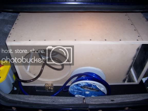

Braced with 3/4 thread rod

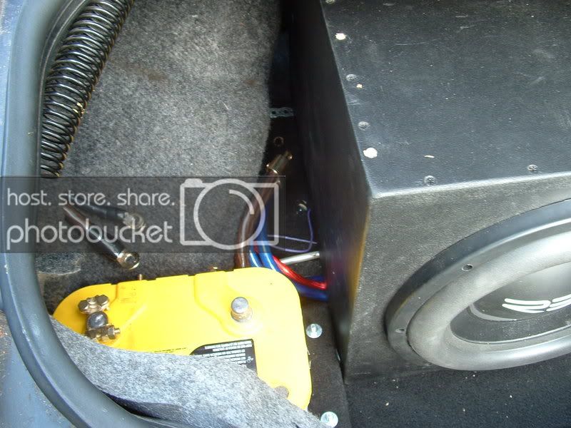

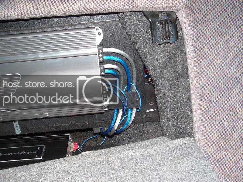

Wire for rear battery.
Lots of 1/0 gage wire

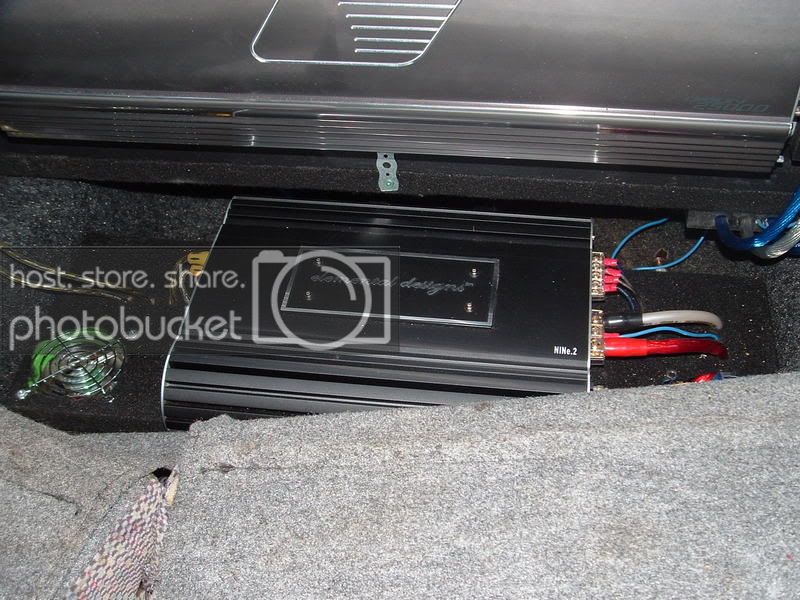

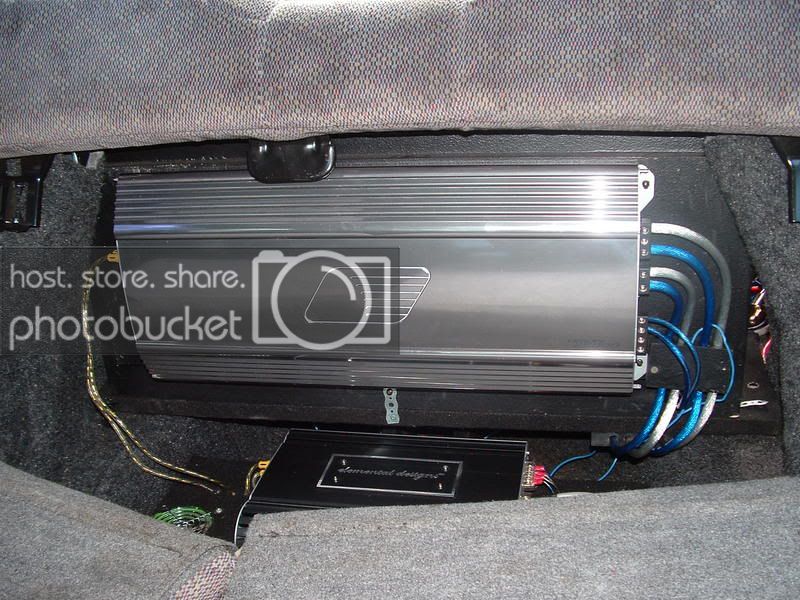

2500d just need to hook up the remote wire from the relay and hide the rca's under the carpet.
comp amp
How you liking the Nine.2?
Lovin it so far. puts out good power clean power.

what is it a 12? how does the MT like 3 cubic feet?
Yes it is a 12" . I will let you know in a few hours it is going to see the orion @ 0.6ohms

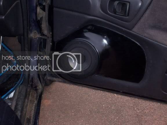

Comps sound really good but have alittle problem with vibration in the door pods.
Going to add some poly fill and see if that helps.
