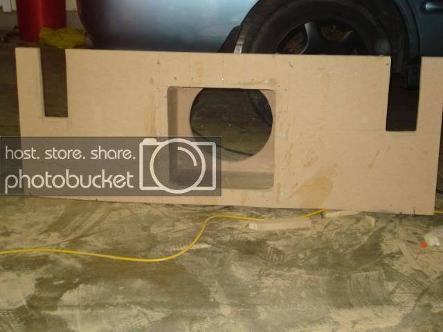

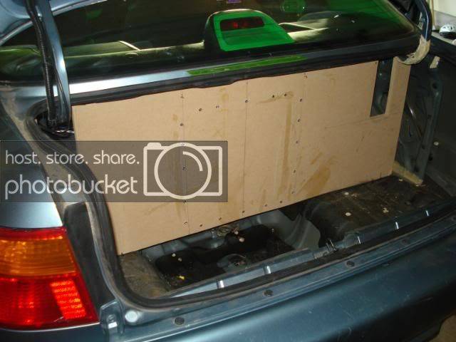

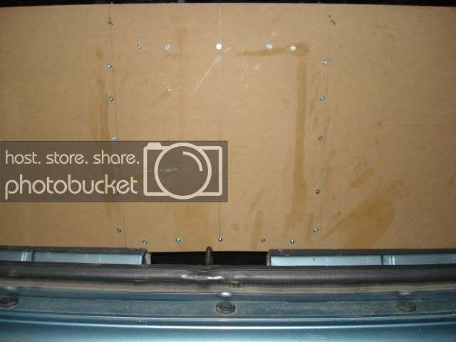

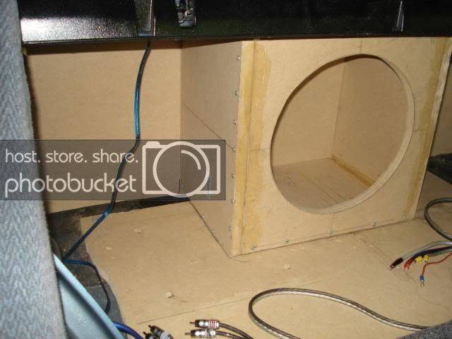

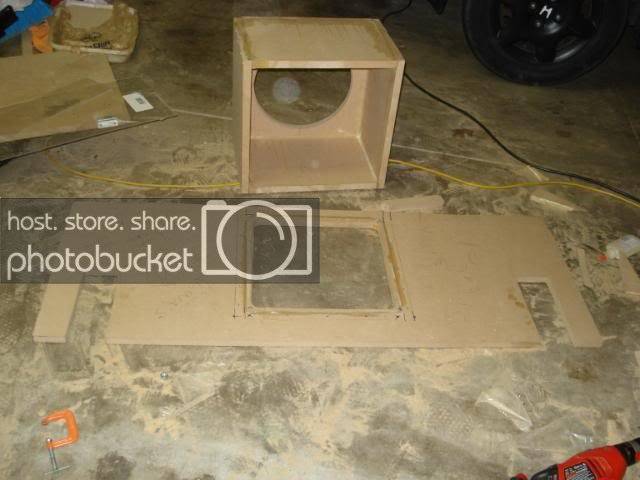

Not very thick (got it from Home Depot), I've heard about problems with flexing and stuff, do you think I'll have problems and whats the disadvantage with flexing? It's a single 12" sub powered by 600 watts rms amp. I've heard some people use lexan but isn't that stuff is kind of expensive? I suppose I could use real glass couldn't I? I got a majority of the box done today, but if the plexiglass I have doesn't work out I can always just swap in some thicker or stronger stuff later. What I did was make the box with only 5 sides and then use the baffle as the back side with a cutout where the plexiglass goes for the window. Anyways here's some pics showing what I've done so far, let me know what you think, but be nice, I'm new at this ;-).

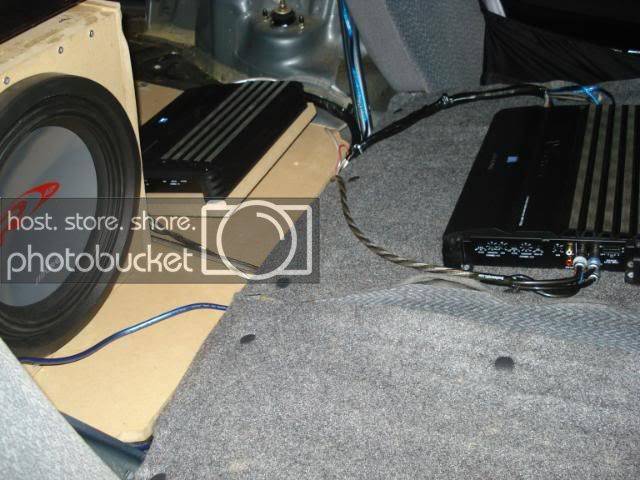

Old/temporary setup:

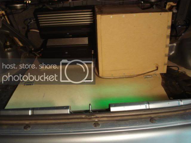

New Setup (In progress):

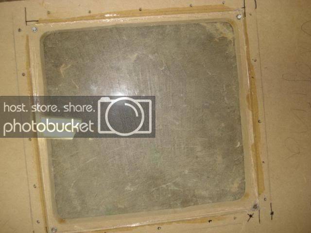

It's hard to see in this photo but the window is there its just not reflecting.
Next to the sub on each side is going to be the amps but recessed behind with windows also and then I'll carpet it all (black) and add some LEDs. Let me know what ya think...
I'm not sure exactly how it works, but I think flexing will take away from the performance of the speaker. Not to mention, when it flexes it will change the air space of the box, and probably rattle loose the silicone, or whatever you will use for a sealant. It might even vibrate. On top of that, you need it to insulate quite well so none of the inside sound escapes the box.
If I were you I would talk to a glass shop and try to get something thicker. But if you have it in there, why not try it out and see what it does.
Other than that the rest looks awesome. That is going to be a sweet looking enclosure. Very nicely done.
