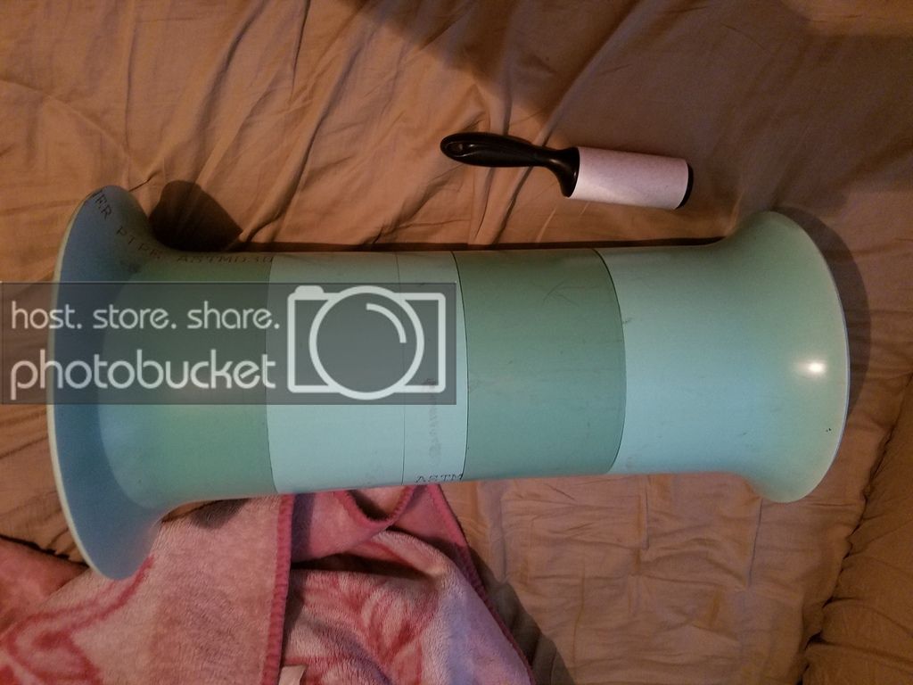

Okay my issue is I'm trying to figure out what to do with an 8 inch aeroport. I want to flush mount it firing up along with the subwoofers. It's going to be a tight fit the flare is 12 inches. My problem is I have too much port length for my required tuning and desire to flush mount the port. It's around 18 inches port length. On a 18-inch box height. I need six inches to clear the bottom... putting a right angle on on the port might be an option just not sure if I'm going to have the room with the 13 inch inner flare. I'm thinking if I choke down the inside diameter of the aeroport to 7 or little over 7 inches I could cut that port length down to 11-13inches. I've been going over ideas onto how to do that. Fiberglass perhaps. I wish thinking about making a bunch of wood rings and stacking them up gluing them. Sanding them down routing the edges for easy air flow..... any other ideas.... too bad somebody didn't make Port inserts at different sizes. So you could easily change your tuning at will

http://i1244.photobucket.com/albums/gg580/jjzickowski1/my%20port/Screenshot_20170619-182126_zpsvip7lz3d.png' alt='Screenshot_20170619-182126_zpsvip7lz3d.png'>
}[/img]
The only difference between what I have and this picture is I have a 13 inch interport Flair. And the inside dimensions of my box (that this Port will be stretching across) is 16 and a half inches. I'm not sure if that changes anything.
