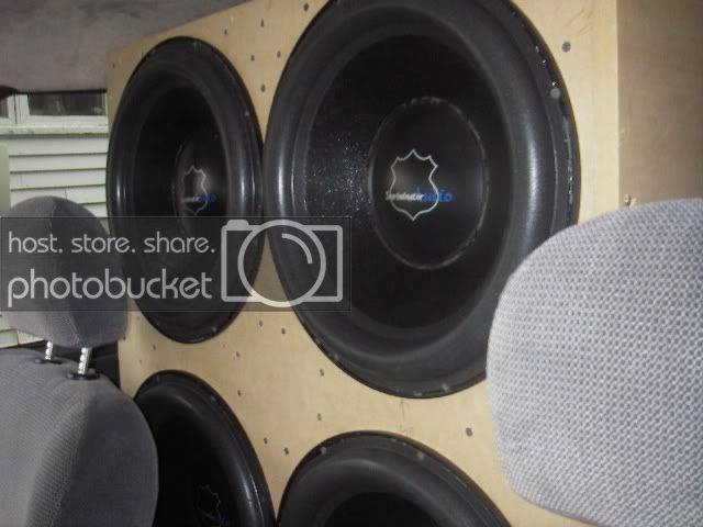

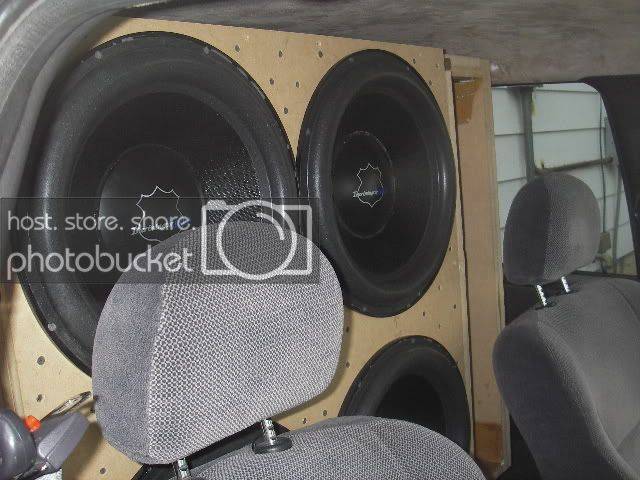

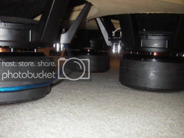

I have 4 DR 15's currently and the do get loud.If its a true 1800rms daily I wouldn't recommend it.1500rms daily is about peak for the DR before they start to get smelly.However if your looking for output I would go for the 18 DR.More cone area on the same power will be louder.Just lower your gain slightly(useing a DMM)and run the DR.You'll be more then impressed with it I'm sure!//content.invisioncic.com/y282845/emoticons/smile.gif.1ebc41e1811405b213edfc4622c41e27.gif
