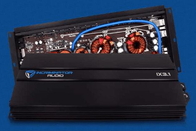

As title says, is the IX3.1sub amp half bridge?
What about their more powerful versions like IX6.1 etc?
The board layout does not look like a typical half bridge.
One good clue is that they can be strapped. That means half bridge, right?

They are half bridge. They use "split force technology"
"SplitForce divides the power supply section and the audio section into two halves and places them on top of each other in a vertical configuration, and uses link cables to attach the two sides together creating a working unit that can function like existing amplifiers, while both sides have their own PCB. The end result is an amplifier that is 50% smaller in length, while still maintaining the ability to strap or link amplifiers. The additional two inches in height allows space to add many extra features such as an onboard voltage display, remote indicator (REM-I) plug which allows you to monitor the status of your amplifier from another location such as the dash or podium of your vehicle, three extra cooling fans, segmented power and ground connections. This unit has all the features, function, and power you need on the streets or in the lanes."
