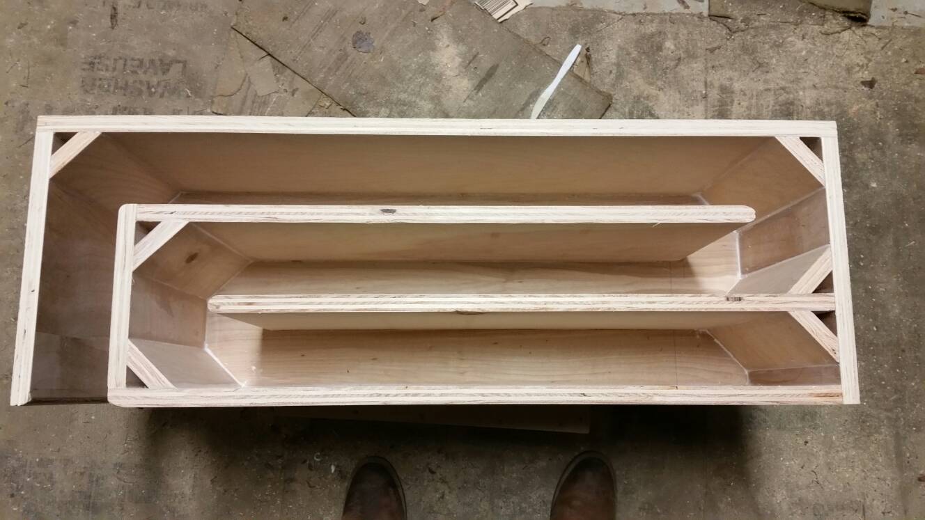

Here you go. Didn't know if you dimensions earlier, but this is about the best I could do while staying at 30"w.

Lol just realized I missed a 45, but everything else is correct
i like it man. finally someone who understand the physics. you even try loading the drivers? it can work wonders to help tune the driver to better couple to the cars acoustics..

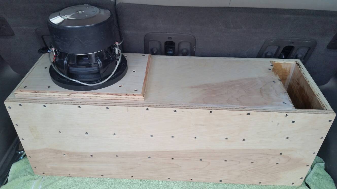

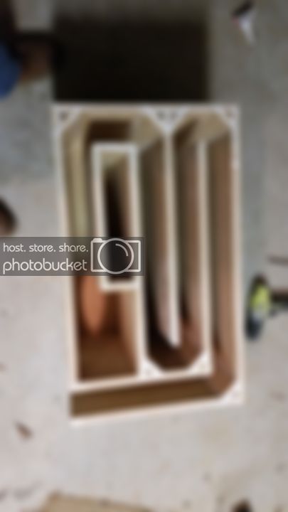

I'm working on a downfiring t-line for a single Sundown e8v4. A buddy bought the sub and I figured we'd try it out and see what happens. Sub downfiring, Port on drivers side facing the front. The sub will be 1.5" off the floor, but instead of firing straight to the floor there will be an mdf loading panel. The reason for that is we're also going to try it out on his Ht system.

It's going in a wrangler, so it's pretty much a must to get any type of loading effect with the top off.
Edited earlier post with the corrected design showing the missing 45 piece.
