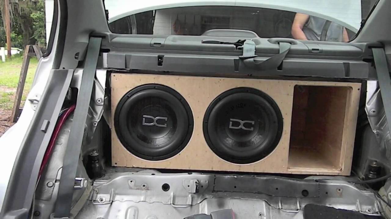

I couldnt find any pictures of worse installs with a lot less than 90% coverage, basically this is common knowledge to anyone that does car auido to not have sound leaking to the back of the trunk when facing forward but the OP doesnt seem like he gets what we are talking about.
Yea dont get me wrong my forward fire installs are sealed. I build the box wide and tall enough to do the job without additional panels. I just personally cant hear the difference when they arent 100% sealed. Flipping a 3 cube prefab dual 12 box forward would surely sound like shiit. There is a reason we point subs backwards.
