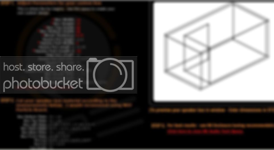

You could build this...
it'll be decently close to 3 cubes flat once the sub is dropped in and has plenty of port area and tuned to 35Hz. That box should slam rap music pretty well for a nice daily setup.
RE Audio is even nice enough to make a nice little cutsheet plan for you //content.invisioncic.com/y282845/emoticons/biggrin.gif.d71a5d36fcbab170f2364c9f2e3946cb.gif
