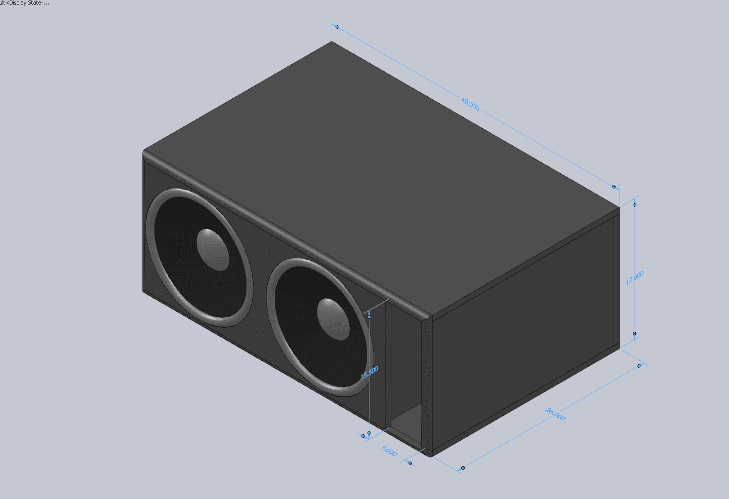

i do box designs quite often, 3d rendering with dimensions and a full cut sheet, if you want one let me know.
and make sure this one is out of 3/4"mdf with a good bit of bracing.
Yes i would greatly appreciate it if you could do that for me and i will deffinatly use 3/4 mdf.lol when i made my plywood box i thought the thinner the wood the more sound. well in a way that was true if you want the loudest porthole noise on the block.haha. Everything is better when you find out the hard way lol.
Shoot me a pm with the box dims you want and ill got on it tonight. And port noise has nothing to do with material. The reason you get port noise is too little port area.

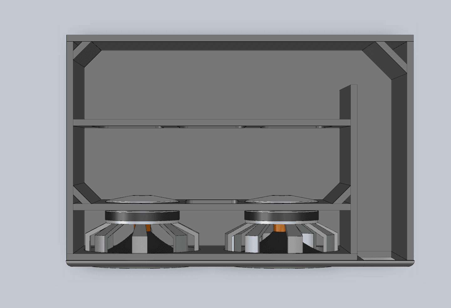

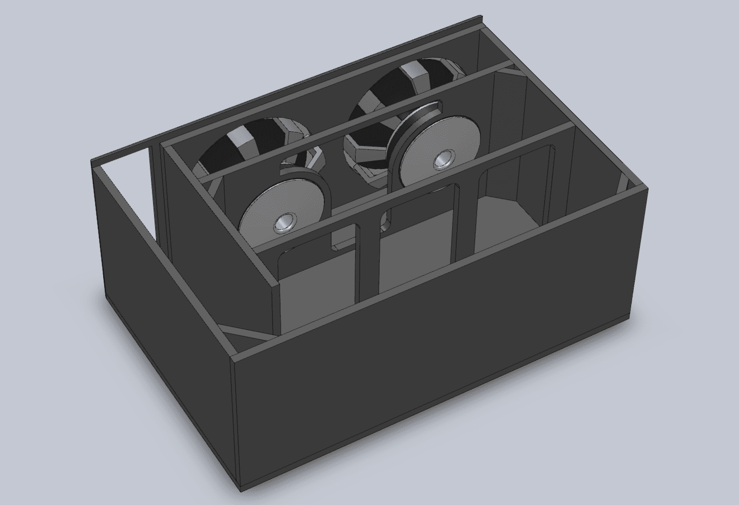

Total Volume: 7.3'3
-Subs: .42'3
-Bracing: .27'3
Net Volume ~6.5'3
Port: 5"x15.5"x~25"
Tuned to ~32hz
that second brace might be unnecessary, but that one to support the sub magnets is necessary.
Total Volume: 7.3'3-Subs: .42'3
-Bracing: .27'3
Net Volume ~6.5'3
Port: 5"x15.5"x~25"
Tuned to ~32hz
whoa...... i'm looking at how much of an opening that motor brace has. curious as to how that affects things. seems to be just a little bigger than the port, from where i see it....
It's quite a bit larger, I didn't want to impede airflow...
