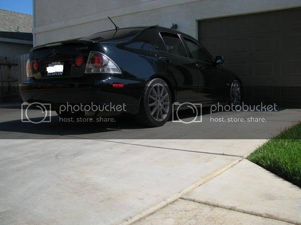

This is the car...

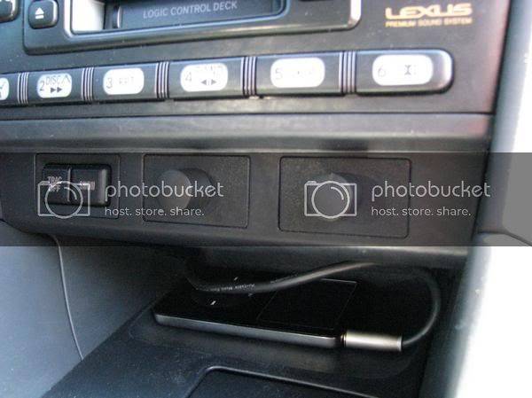

Here are the knobs for the Clean Sweep and the Sub Output Control

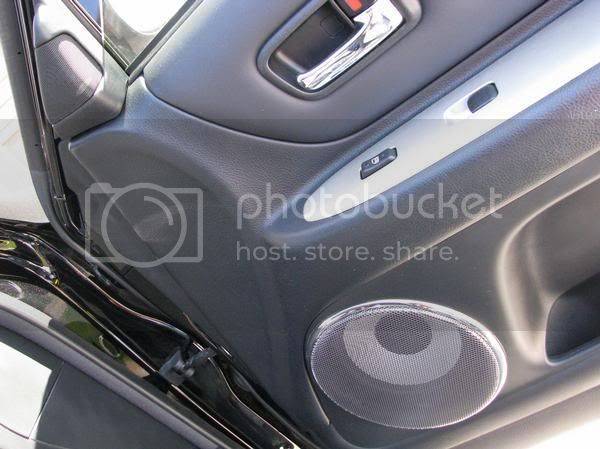

Here are the Genesis Components...Looking Stocker

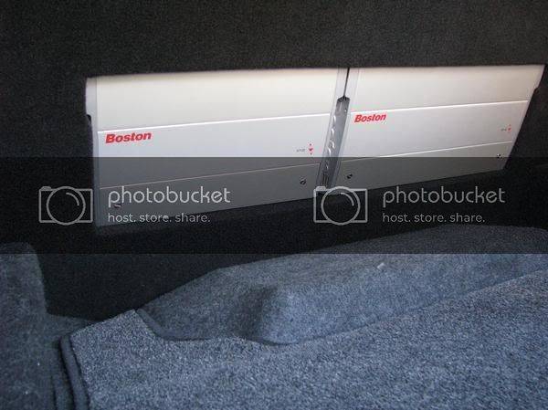

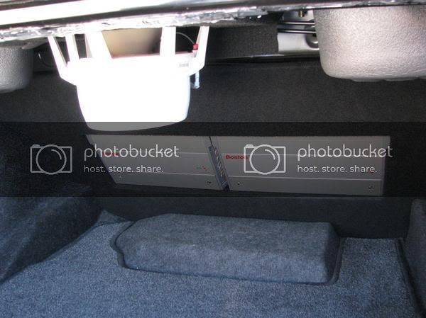

Amps/Amp Rack

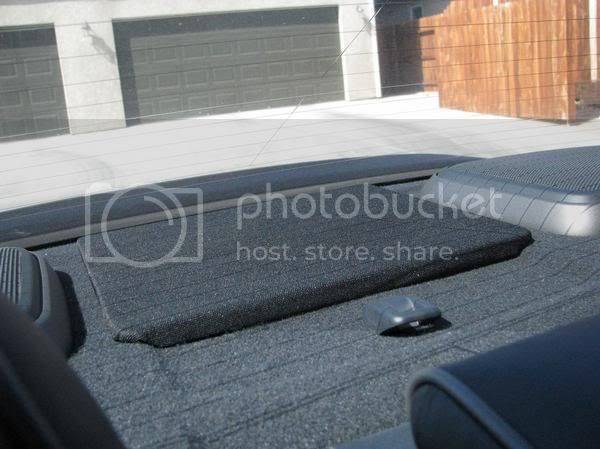

Top View of the sub, we are going to do something better to cover it up but this still works fine....

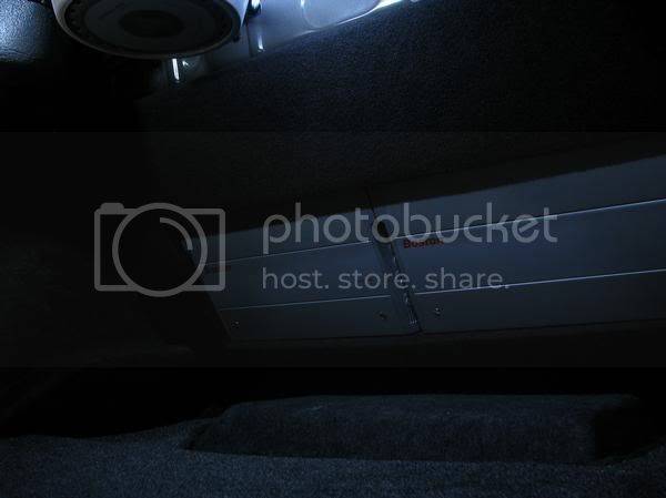

Shot of inside the trunk with the lid close....we put some white lighting inside....
The IB setup sounds awesome, it has great SQ and the Subwoofer Knob really helps to control the output. Let me know what you guys think.
Looks great. Very nice craftsmanship going on there. I personally would've ditched the rear deck speakers and seal/reinforce them with 1/4" mdf to make the rear deck sturdier.
I tried telling him the same thing but he wanted rear fill because he likes driving people aroundin his car.
The whole back deck is completely filled with expanding foam so its still rock solid and no air leaks (from what we could tell)
