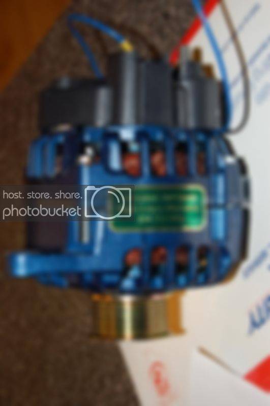

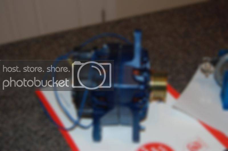

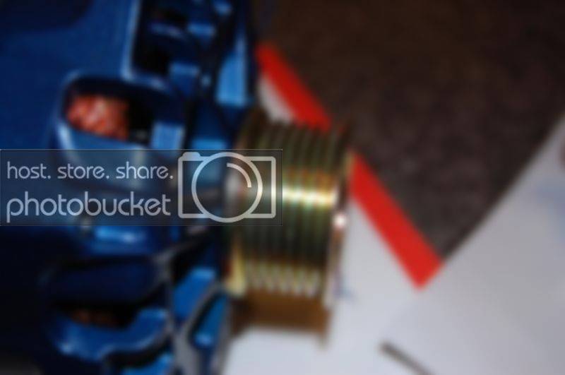

I have a few questions on install after the pictures.
Nathan thank you very much and I look forward to telling people about your great work and your product!

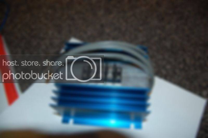

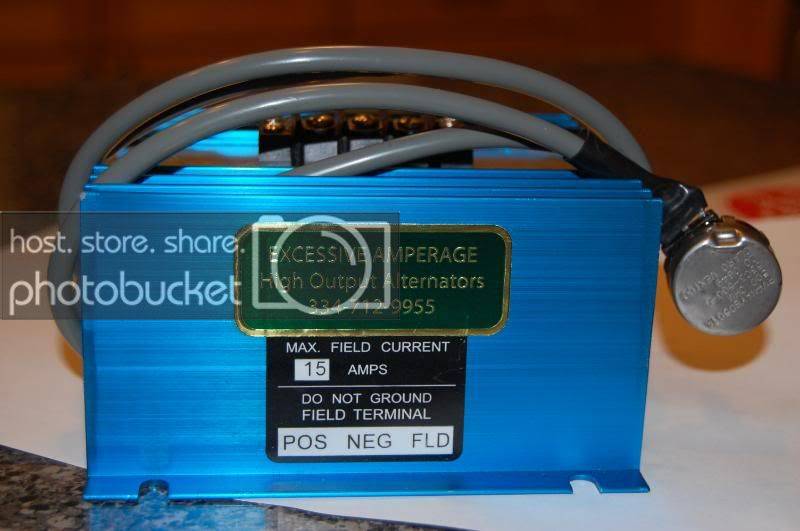

How does this work? :
I have a family member thats a mech. I don't know if he's seen one of these regs before though. I want to do the big 3 also with this but I'm not sure how yet. I want to give him written instructions on how to do the big 3 and how to wire the alternator and the 16v regulator.

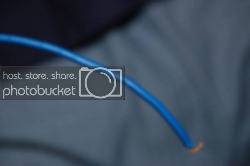

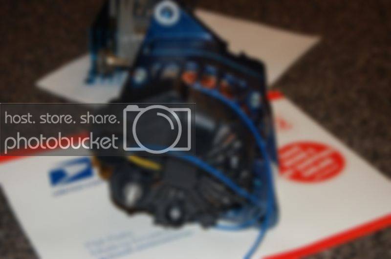

What's this wire for?
What is the little Blue wire for? The wire harness is the one that is on my current alternator I guess. Do I need bigger wire now for this one or do I just use what I have? Will I need to update my normal car fuses so that this doesn't blow anything? Please advise me so I am not misinformed. //content.invisioncic.com/y282845/emoticons/crap.gif.7f4dd41e3e9b23fbd170a1ee6f65cecc.gif

An external regulator is traditionally reserved for 16 volt batteries. Usually a person will have a 2nd alt with the external regulator for a 16v battery bank while keeping the stock alt for the cars 12v electrical.
Well I don't have room for a 2nd alternator. So Can I still run this? Otherwise I payed for it for no reason.
i say dont run 16v. but use the regulator to dial in the voltage right where you want it. a reg 12v battery wont like anything over 14.6-14.7 volts. and no that stinger isnt a 16v battery //content.invisioncic.com/y282845/emoticons/frown.gif.a3531fa0534503350665a1e957861287.gif just 12
but the alty you have gives you the option down the rd to do 16v. //content.invisioncic.com/y282845/emoticons/smile.gif.1ebc41e1811405b213edfc4622c41e27.gif
