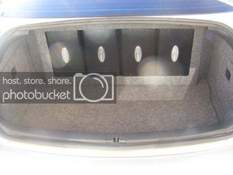

can your rear seats fold down? if so, here is my setup. very smooth response response and can get loud also //content.invisioncic.com/y282845/emoticons/wink.gif.608e3ea05f1a9f98611af0861652f8fb.gif i'm redoing the trunk right now, so nevermind the shitty amp rack //content.invisioncic.com/y282845/emoticons/smile.gif.1ebc41e1811405b213edfc4622c41e27.gif

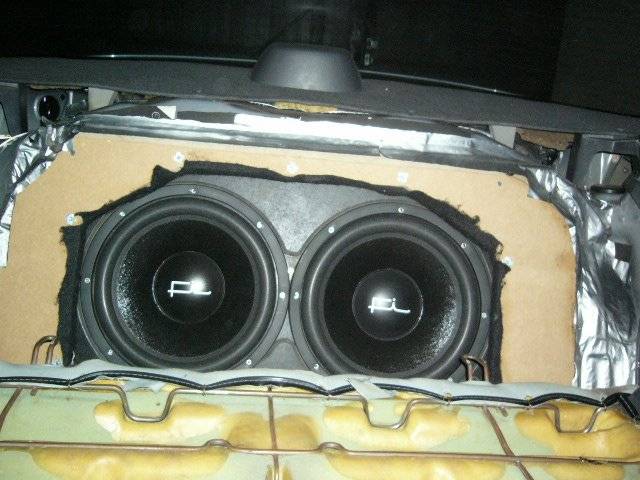

I have 2 12" FI X series IB in my Celica. It doesn't matter where the subs are mounted as long as the front wave is sealed off from the rear. I built a baffle behind the seat and sealed it up.
My seat also does not fold but the bass is just as loud with the seat in place.

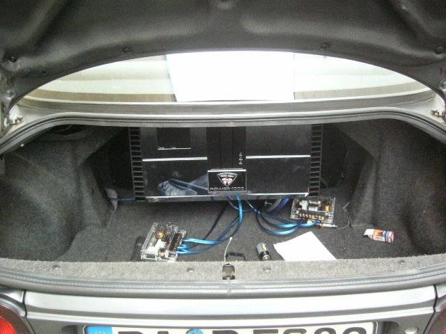

Remember a IB setup is not for SPL but a SQ. I sm running the sub channel from a Fosgate Power 1000 at 4 ohms for 300w RMS and it does hit hard and DEEP!
Lots of room left in the trunk also!
