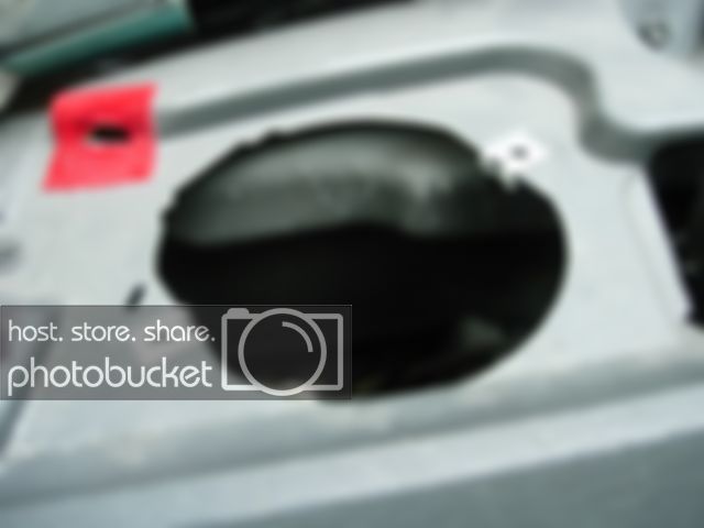

First off I removed the stock mids from the dash and test fitted several mids to see what fit best with no mods. (trying to stay within the lowest class with MECA I can. I need all the help I can get by staying in this low ended class) I ended up using (for this first round) a pair of Dayton RS100-4's. A 4" midrange with somewhat ok reviews. The holes where the stock mids were mounted are open and need some work.

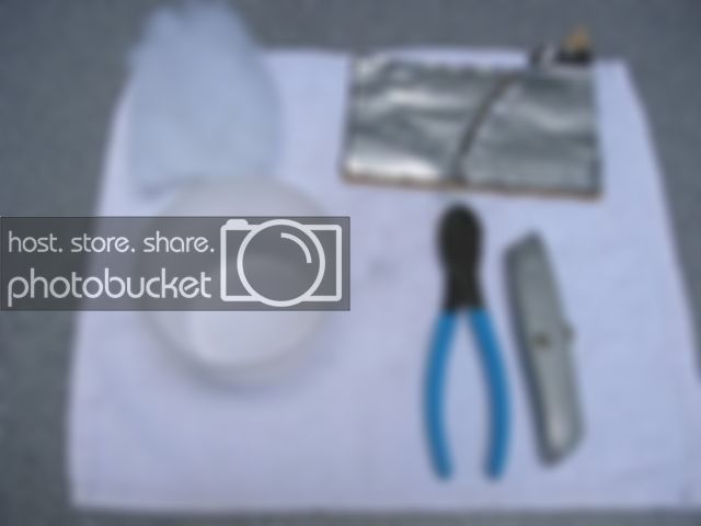

Next I found something I could use for a cup/bucket or pod for the midranges. Since we hardly ever throw out something we can re-use I found some Chinese Take-Out containers that would fit the bill for the cups/pods for the midranges. I gathered some Dynamat, side cutters, Polyfil, razor knife and started my build.

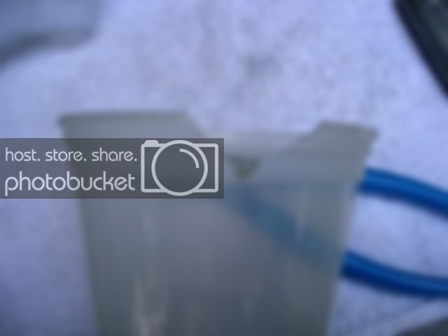

First using my side cutters I made a 'V' cut in the top of the container in a spot I had found to be a good location to allow depth and clearance for the mids. I also check several other mids to be sure that this would be ok to use when I change my mind again concerning the mids and went with another brand.

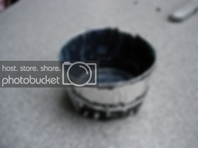

I continued to use my side cutters to trim all the way around the container until I had the size I needed. Small short cuts were used to keep the plastic from cracking in a downward direction and ruining the container. Move slow and take your time.

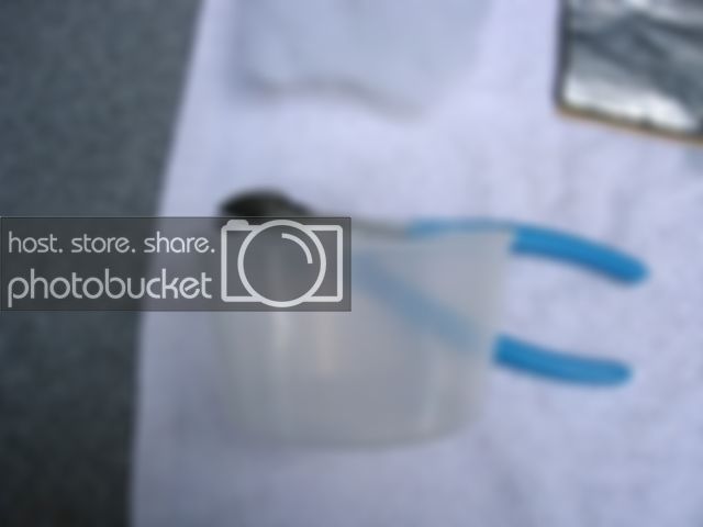

Next I wrapped the outside of the trimmed container with Dynamat. I guess any sound deadening material will work. I just happen to have several hundred square feet of this lying around.

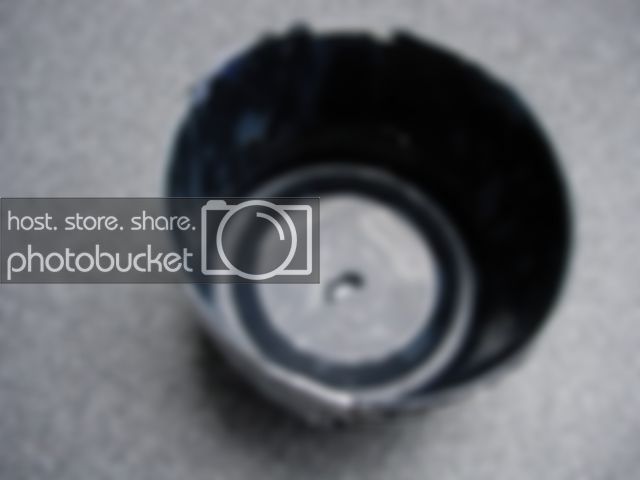

When I finished with the wrapping of Dynamat I cut a small access hole in the bottom of the container for the wiring. The utility knife comes in handy here. Cutting a small rectangular hole about the same size as the wire I'm using.

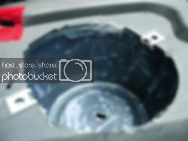

Bending my arm like a Chinese contortionist I was able to feed the cup/bucket from under the dash up to the top where the cup/bucket needed to be installed. I test fit the midrange driver to be sure that it was as centered as I could get it. I then added some hot glue to hold the cup/bucket in place. I found that the cup/bucket was slightly distorted because of the other components, wiring and struts that were already existing. If I angled the glue gun under the dash cover towards the cup/bucket I could squirt a small amount of hot glue where I needed it. Waiting a minute or so the glue would cool enough for me to use my finger to spread the still somewhat hot glue as if I was spreading caulk.

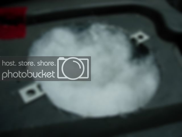

I added some Polyfil to the cup/bucket.

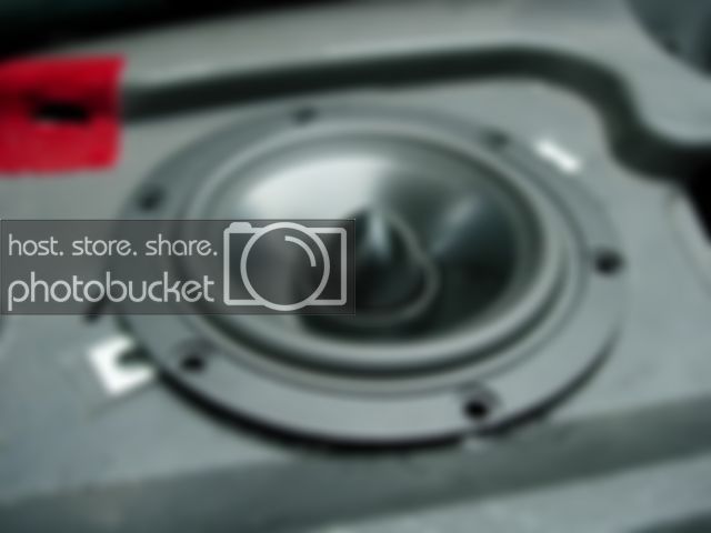

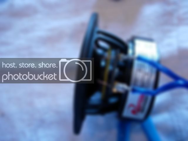

Solder the wires to the midranges for the install.
Feed the wires down thru the access hole you made earlier in the bottom of the cup/bucket. Extend the wries to your amp or XO. I needed to fabricate a mounting plate for the Dayton mids but forgot to make new pics. But I think you get the idea.
This has been step one of this new install. BTW, the mids sound sweet so far. Even with the somewhat redneck temp mounting of the tweets the soundstage has been brought very forward and high in the listening field. I'll be adding more pics of the addional gear I'm using as I get to it. Feel free to add anything you think could be of use to make this a better install.
